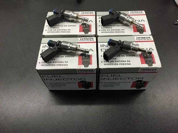

@S3Alex in your vast experience, about what bhp do healthy S3 injectors run out of go? Appreciate there will be some variance.
To answer my own question here would I be somewhere in the ball park at low 400's with the RS4 fuel valve?
Depends on the HP rail pressure you run but at stock pressures a little over 400ish bhp.
By running a higher pressure and with the RS4 valve you may get more but I don't think you'll see beyond 440bhp at the most.
It would be worth asking Rick as he has expert knowledge of custom mapping and may well be able to help.

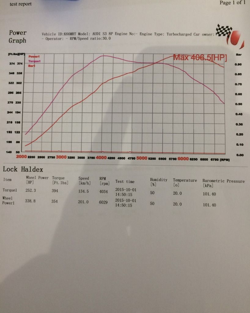

A very quick update, just back from Unicorn, been a long but superb day.
Just enough time to thank Rick for his exemplary work, his reputation is well deserved. Top man, solid engineer and a gent to boot.
Will explain more when I have time but here she is my outcome for the day... Let's just say I'm very very happy!
Great Numbers!:) RS4 RPV and stock injektors did the job?
Thanks, all credit to Rick, he's the magic man, all I did was take some good advice from people on here and choose the right tuner. Yes so this is with standard injectors and the RS4 fprv. As expected we ended up injector limited. Turbo no where near max output running somewhere in the low 1.6bar range.
Rick is great! You added some of his special futures into the map?:) I expected the fuling limit. But this power levels at 1.6bar is excellent! Then you have a wery safe and reliable setup that you really can use witout worries.

None of the launch or flat shift stuff no, that didn't really excite me, he did add 3 other maps however, I have the full beans map of course then one for 95 octane, a low boost map around the 330bhp and the last is a valet mode that's less than stock output.
Excellent result.
Good torque and bhp,and as you'll notice,less roll off in torque at higher rpm than with the stock turbo.
You nailed it Alex, the most impressive thing is the increased area under the torque curve, it doesnt just take a nose dive it hangs on at 380lbft until nearly 6k. Its this thats impressed me the most and really is the most important in the real world.
All down to flow....
I mean in overall terms as everything has it's part,but when it all works together it makes a big difference.
Thanks to all the work on mine in March,I now have more torque at peak rpm than I had at peak torque previously(if that sentence makes sense),and your eally notice how much more usable the car becomes,rather than having to rely on a narrow area of power and torque.
The other great thing for you is knowing there is more to come with more fuel....flow...LOL
There should be, the turbo isnt really working that hard at the moment. More decisions to me made now, do I go for injectors and push her on a little more? Only concern then is this will possibly take her close to needing forging and thats another big jump in costs. Hmmm.
I'm going to enjoy it as is for a little while I think, next up will be a set of summer rims. I'll put some winter rubber on my standard rims and get some summr stickies for the new. Sometime in November for this I think.
Very sensible.
I did everything in increments,and it gives you time to get used to it,as well as to find any issues before the next step.
You've come up against injector flow limitation,so more power would equal bigger injectors.
Rick is confident of being able to map RS4 injectors properly,as Revo software will run them,but not cleanly.
At 440lbs or more,you'd be well advised to consider building the bottom end of the engine,as the possibilities of bending rods must start to go up at some time.
I did that first,before getting the top end done,but doing that is also very useful if you went for a bigger turbo at some point.

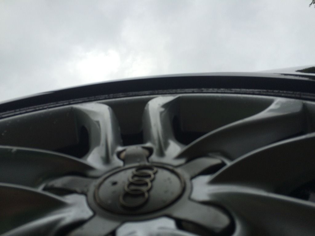

A small and not so significant update.. Preparing for winter so I treated myself to a set of used original facelift S3 rims for a bargain bucket price. ET is slightly different moving from 56 to 54mm, didn't think it would be significant but just pushed the fronts out to far on the 15mm spacers I needed to space the rims over the TTRS brakes. Worked out quite nicely as I only needed to buy one set of 12mm spacers and dropped the 15mm's onto the rears.
Plan is to keep these on until the temp drops then take them back off and send for refurb in anthracite ready for summer. Already have my Pirelli W240 SottoZero serie 2 winters ready for fitting to my original rims.

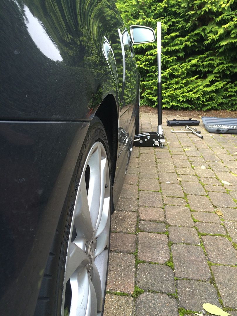

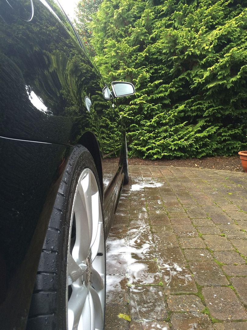

Couple of comparison pics
Rear before spacing
And after
And a shot from the front just because

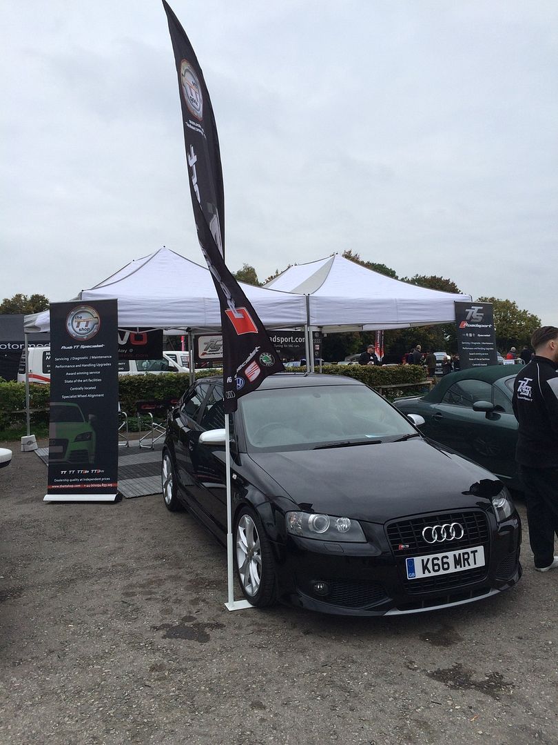

Quick shot from ADI 2015. I was invited by TTS Roadsport to put my car on their stand. Was a great day and really good to meet a few people from ASN. Some beautiful motors here.

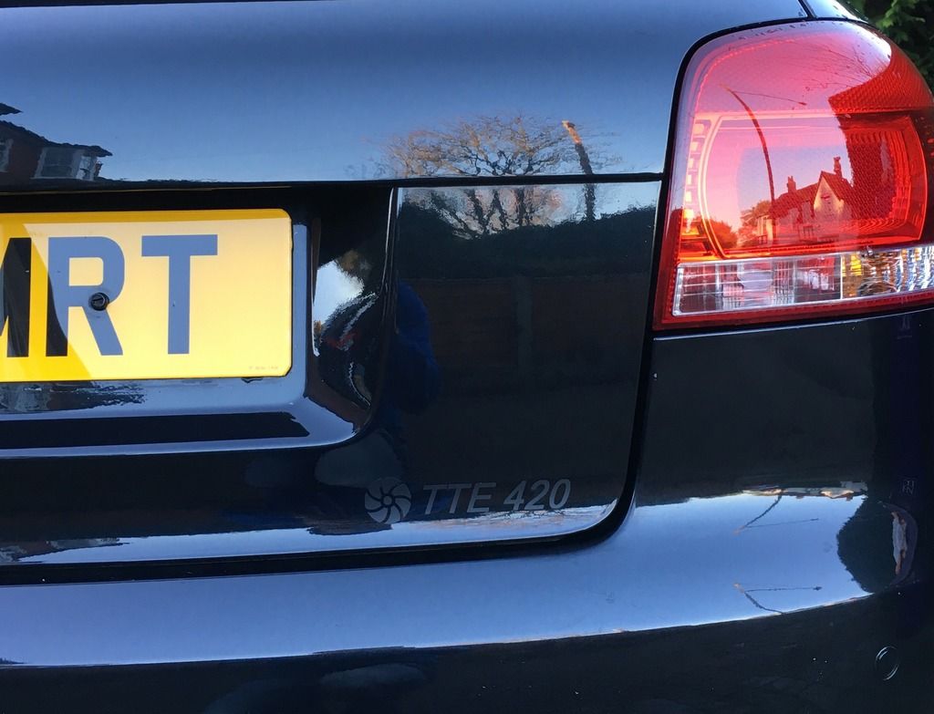

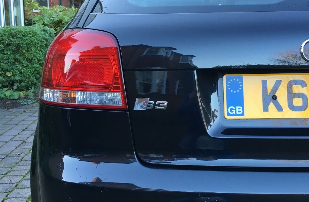

This feels like a naff post but its my thread I can ruin it as I like...

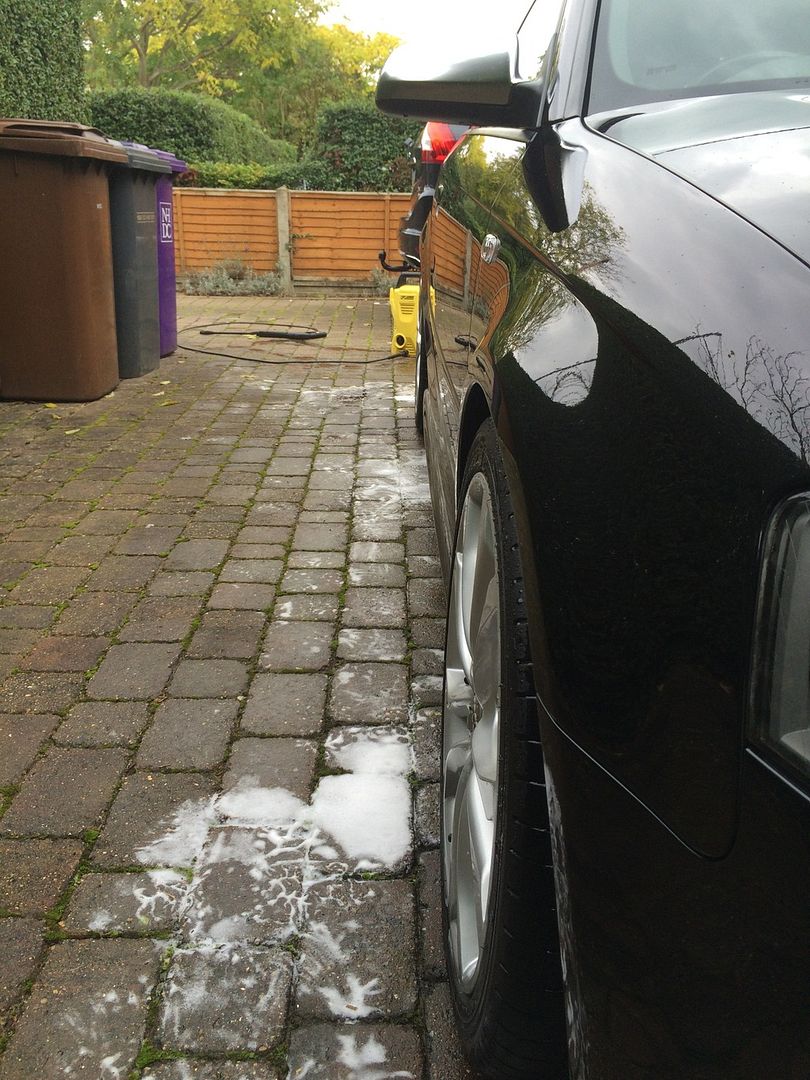

So this happened, no idea how probably over excited with the pressure washer.
So I took it off. I have ordered a new one but thought I'd use the opportunity to trial the debadged (sort of) look, its something thats not very much my style but wanted to see if spending some time with it brings me around.

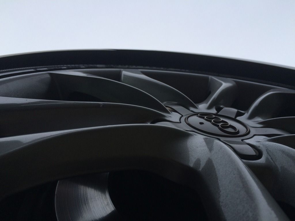

Summer rims back from refurb. Only just put on the winters and already want to put these back on. Not scuffed already, just tyre sealant, need to get that off sharpish
Bought some new genuine wheel nut covers/centre caps to. Couldnt have fresh wheels with tatty centres. Jeez my posts are dull at the minute...

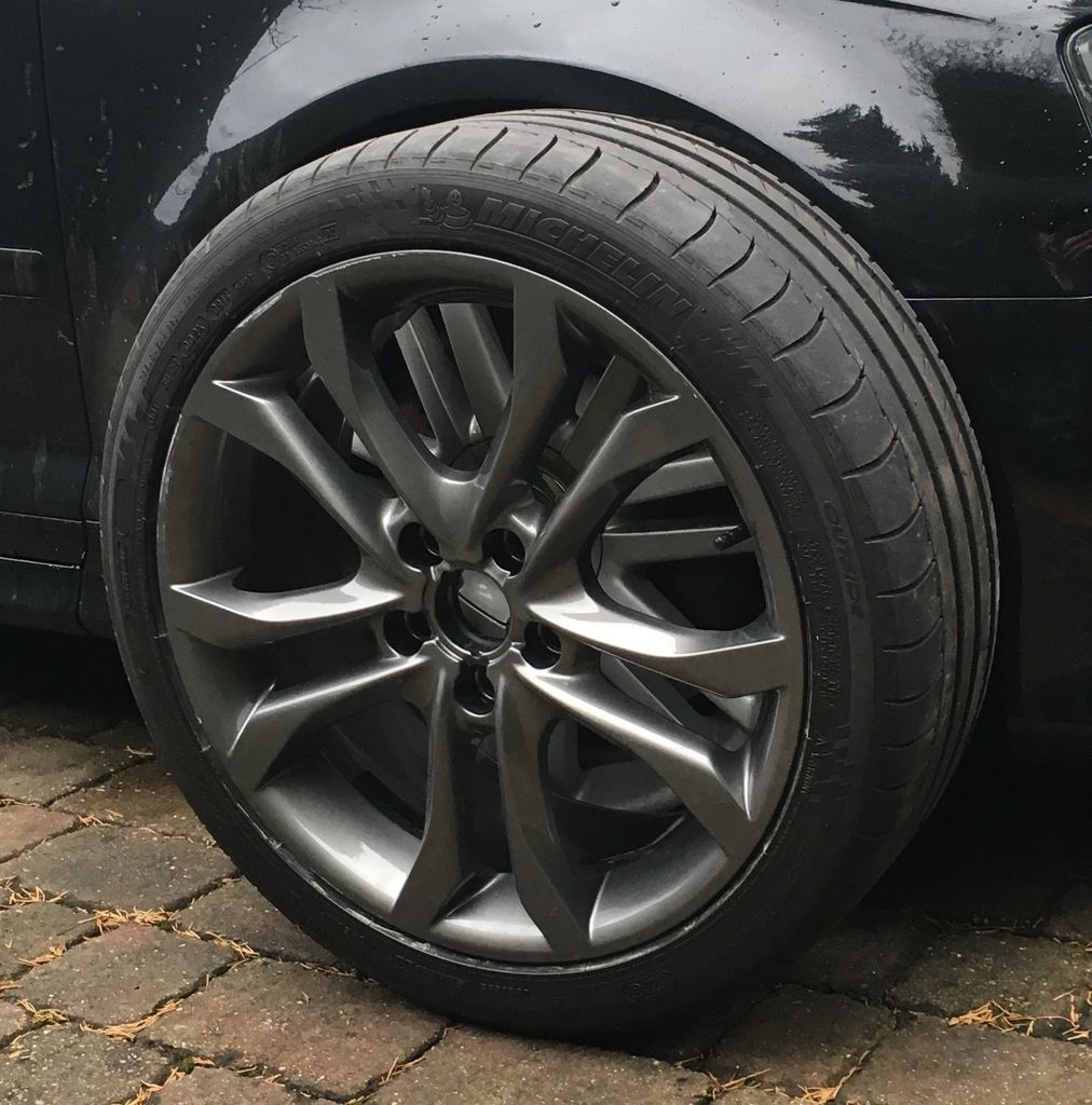

what colour were wheels done? can't tell from this picture if it's anthracite, or somekind of bronze...
i was looking for some colour for my winter wheels (same wheels as yours), but can't decide which.
Dt_racing
Sep 16, 2014
232
116
Suppose they do look a little bronze in that picture but they are BMW anthracite. It was the lightest anthracite I could find.

Suppose they do look a little bronze in that picture but they are they BMW Anthracite. Its the lightest Anthracite I could find.
the one that's common on x5 and x6 wheels? i was thinking about that colour too :D
got oz ultrallegera's for summer wheels in matt anthracite so would like something different for winter wheels, but might leave them as they are this winter and get them done for next.
Dt_racing
Sep 16, 2014
232
116
TBH I couldnt tell you, when we were discussing colour the paint shop showed me their anthracite range, i prefered the lightest and he said that it was a BMW colour, cant tell you any more than that I'm afraid.

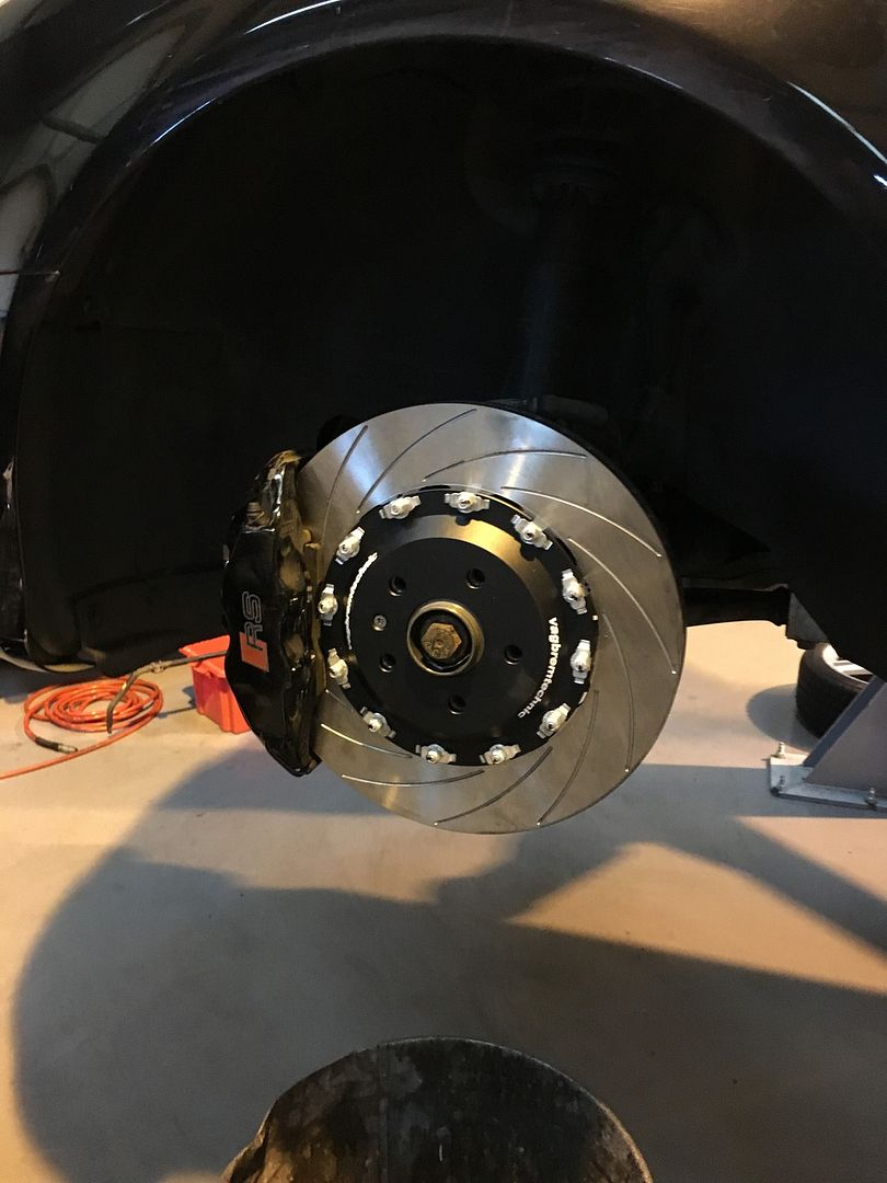

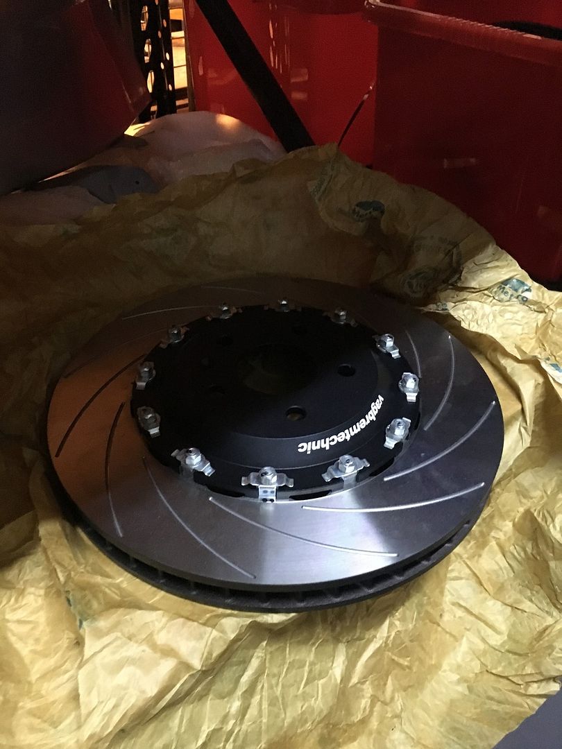

Always nice to get your hands on the hardware, its stunning stuff, the caliper mounting braket is beautiful. How sad am I?
Being fitted today
Dt_racing
Sep 16, 2014
232
116
Ooo all done...
Dt_racing
Sep 16, 2014
232
116

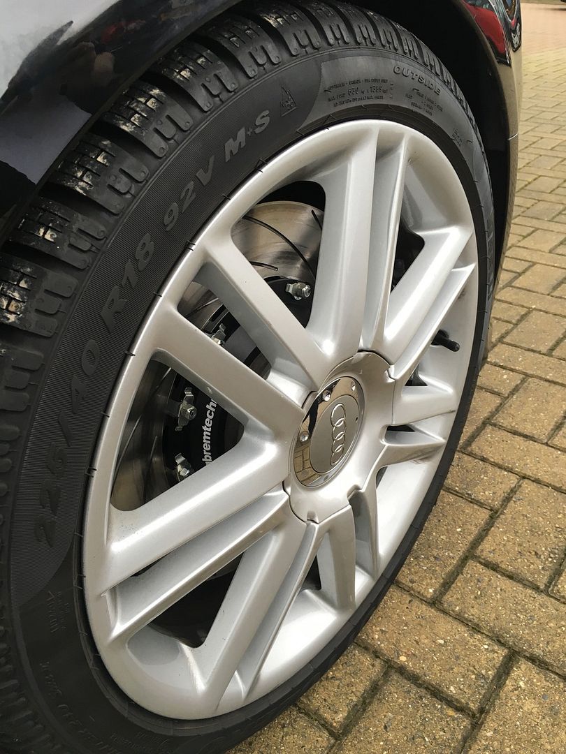

A small thing but makes a difference.. I can now have wheel weights on the inside of my rims, the slightly smaller diameter discs (162mm) opposed to the standard 170mm and the new mount brackets have moved the disc well away from the inside of the rim. Great stuff. Also they sit 4mm further inboard so I can run smaller spacers. Its always nice when you get hold of a properly thought out bit of kit. Had to remove the inner dust shields with these but hay ho no drama.
Brakes feel great, on the road exactly the same with a marginally better pedal feel but i'd imagine thats the braided lines and fresh fluid as opposed to anything else.
One more for good measure.
