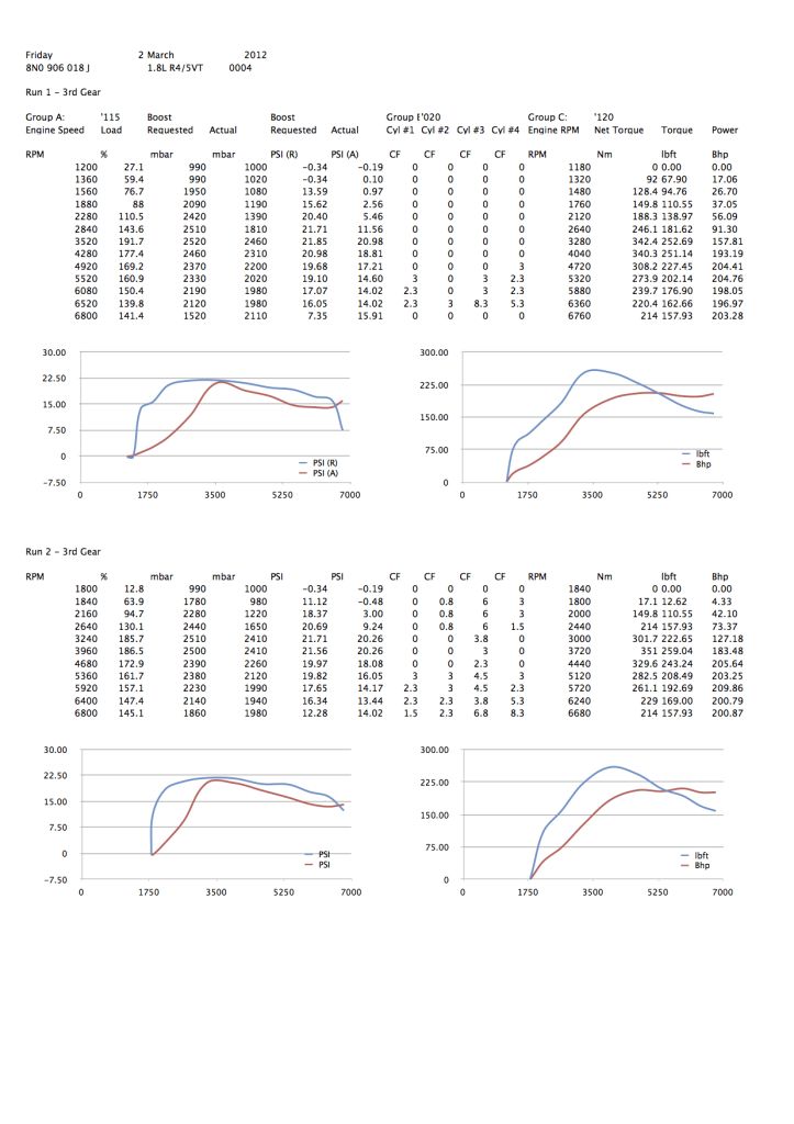

I am now fairy happy that we have the map sorted however I think I have worked out why the airflow readings are still so low.
I have also done a log with the N75 disconnected and its pointing to a weak actuator from what I can see.
Have a look at these logs and see what you all think !
First Log,
Boost and CF's:
Second Log
Boost & Fuel:
Third Log
Actuator Test:

Ok further testing over the weekend has left me stumped !
With the remap on the car it runs brilliantly, pulls hard in all gears and seems very very quick as you would expect. however no matter what I do the Airflow readings never seem to move above 180 g/s which equates to around 220bhp. Additionally the boost readings are always below the requested even though I have now adjusted the prelod on the actuator a litte.
I also found a leaking hose meaning it was sucking in unmetered air from the inlet side however despite fixing that I still get low airflow readings and boost not meeting the demand.
I tried logging the stock map and again same issues, low airflows and boost running below the demand level.
What I have noticed though is that with the remap on the car I am able to log a considerable increase in torque across the rev range and the levels I am seeing do tie up with a stage 1 mapped car (approx 270lbft), but despite that the bhp figures are still low (both when calculating from the airflow or from the torque figure).
Anyone able to shed any light on why this would be happening ? I am almost certain I dont have a boost leak as like I say the car runs very well and if you unplug the N75 it will build and hold boost all the way to the redline which indicates there is definately not a leak.
Could my problems be linked to the N75 itself ? I am tempted to fit a MBC in place of the N75 to see if that makes any difference.
Thoughts ?

Tired MAF can give low readings like you describe...
Also your boost request looks to peak very early, Its wanting 22psi by about 2k, which simply isnt going to happen...

The thing is even with the MAF disconnected if you log block 120 and do a BHP conversion based on the torque it still doesnt ever see more than about 221bhp.
Is it possible that the stock airbox and stock filter is strangling the engine and physically it cannot suck any more air in ? I wouldnt have thought so but it really does seem like that.
I can certainly adjust the boost request to come in more gradually, do you think the way it spikes early is preventing the N75 from properly controlling the actuator due to it building the boost to quickly low down ? I guess the N75 is having to go from closed to fully open to bring the boost back down and prevent massive overshoot ?
Nope... I ran 350hp on a stock airbox (green cotton filter) so I don't think thats the issue... you done anything with the timing advance? the high CF's top end of the rev range won't be helping
You need to get it on a dyno really...

Yeh I have managed to get the Cf's back down, I dont actually know why they were so high initially but there all very low now on subsequent runs. Either way though this wouldnt explain my odd boost and airflow readings especially since this also happens on the stock map file.
Dan would be best placed to answer the timing question as he altered that for me as I didnt have an XDF file for the AMK at the time.
I agree that getting it on a rolling road is the best option all round but to be honest I dont trust anyone up here and it will be quite some time before I could make a journey down south to someone I would trust.
Its also worth mentioning that this map was run on a 225 TT without any issues and I believe it made around 260bhp. It was then adapted for my AMK engine by copying over the relevant tables and their values.
As said above however, this issue is still present even on the stock map so I am confident that its not a mapping issue unless Audi's stock map was faulty.
Tuning by bringing the boost request in early is the best way to turn the K04 and K03s turbos imo, It can be used to gain better boost control and stop nasty boost occilations, the me7.5 PID controllers work better that way.
Running the boost request low at lower rpm on a taper ramping up the rpm range can cause issues in differing gears. Same with running the boost request over what the turbo can do at the top end the post-N75 control (KFLDRL) can be used to maintain the boost to a safe level which is smooth and has no intervention from other settings.
Thanks for that Nick, I found another small leak so sorted that out and have managed to log 233 bhp which is the highest I have seen, boost is still all over the place though but I will look at KFLDRL and see if I can do anything from there to help it.
