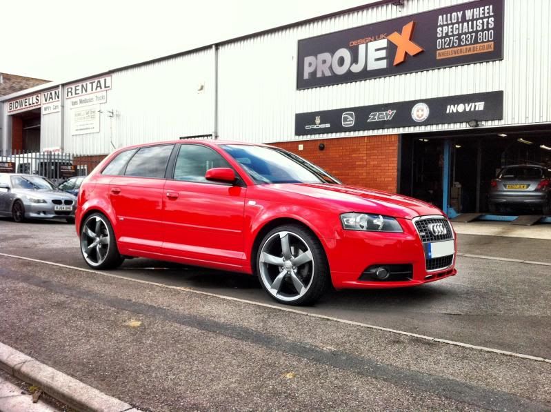

Hi there User10. I know that Kriminal on here bought a set of top quality reps and they look amazing on his car.
Here are some pics -
Here is his thread from when he had them fitted.
http://www.audi-sport.net/vb/new-a3...on-thanks-all-your-input-i-finally-chose.html
This is a link to where he bought them from. Hope this helps :wub: xx

It looks like Kriminal have a A3 so my S3 should would have a lower drop. That would not be any problem? :readit:

Your car will have a lower drop than Kriminal's, but that shouldn't cause you any problems, so long as the offset of the wheel is no lower than ET45. I think these wheels are 18x8J ET45, so you could lower them even more than the standard S3 suspension without problems. I have 18x8J ET44 (on 225/40/18) at the moment, lowered 25mm on H&R springs and have no issues (used to rub when going over a dip in the road sometimes, but I removed the wheel arch screw on the rear of mine and no rubbing at all now). :wub: xx
