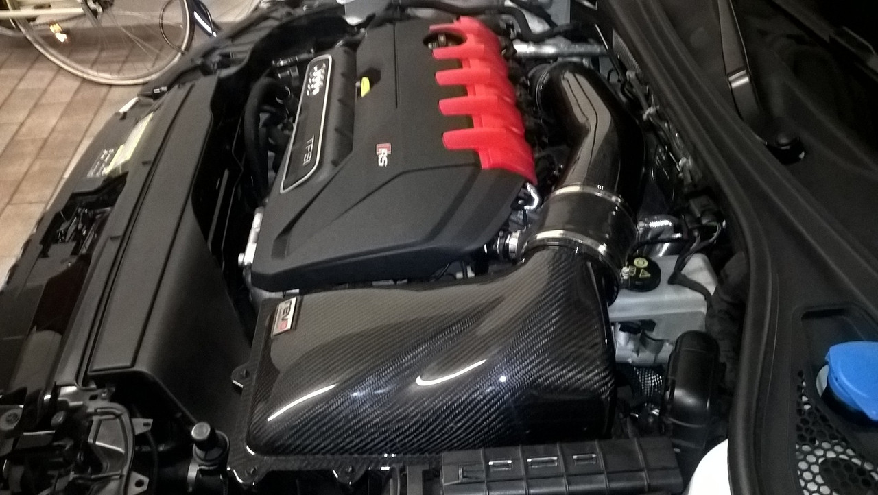

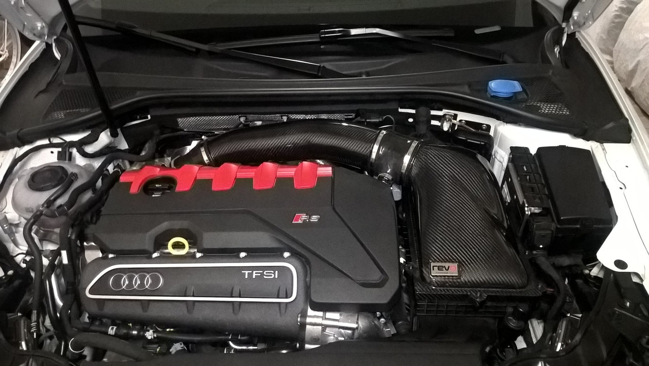

I installed REVO carbon intake. No problems encountered during assembly. The carbon quality is excellent. I changed the REVO panel filter with K & N panel filter. For me it is much better with K & N filter than REVO filter, I seem to have better performance and a more beautiful and strong suction noise.
I came close to getting one but fitment looked like a PITA. How was it? Don't yourself? Need any talent to do so?
Vida of the noise would be awesome :)

I installed the kit myself. However, a minimum mechanical manual is required.
From the Revo website you can download instructions.
https://www.onlyrevo.com/userupload...ions/Fitting_Instructions_TTRS_RS3_Intake.pdf
Indispensable caliper clamp between turbo and tube like this.
I used a tightening torque lower than that indicated by REVO to tighten cover screws, with 3 Nm you risk to ruin rubber washers.
I suggest you to install kit a REVO dealer
