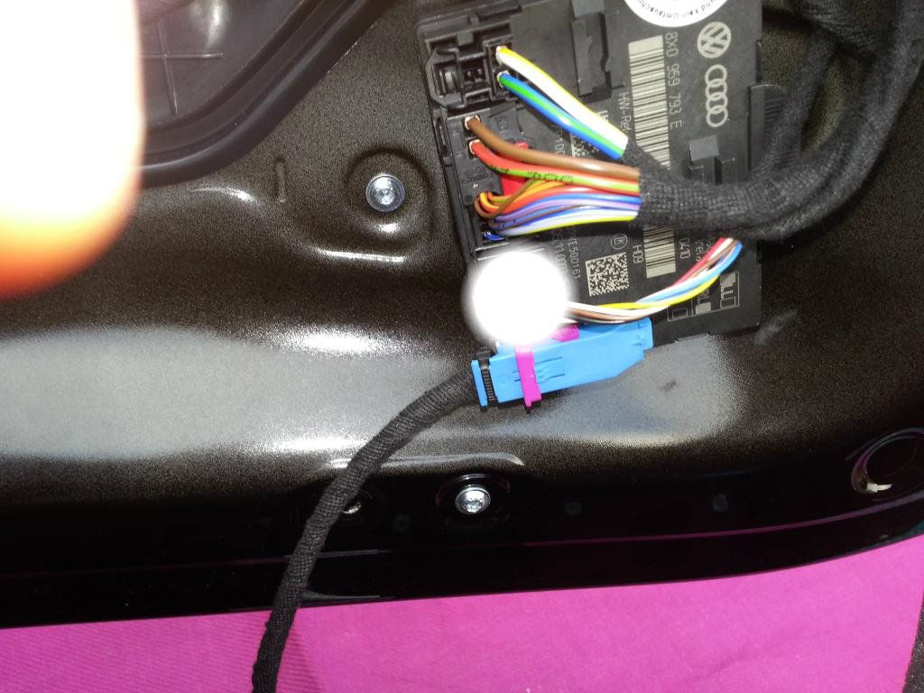

The door control module
To separate the wiring loom from the door control module, lift the purple clip up (it will swivel) and then the light blue plug will lift away as the purple clip rotates.
The door card is now free. I placed it upside down and you can now see the 8 poppers circled in yellow which pop into the door in the picture above. These will likely break so it may be handy to buy some spares.
Next remove the plug that I have shown by a white spot on the photo above. (Although covered by the white spot, it can be seen clearly in prior photo. You will need to lift the red clip up first and then lever out. This is the 16 pin plug which I will refer to later and connects the wiring loom of the mirror to the door control module.

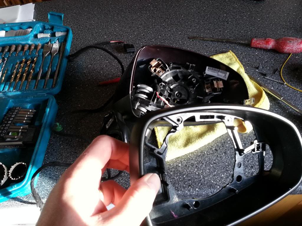

Remove the mirror glass from the mirror housing. Angle the mirror glass upwards, insert awide chisel in between mirror glass and mirror body (wrapped in a cloth) and prize mirror glass away. This needs a bit of force but be very careful. Too much force in a small area will crack the glass. You may be able to use yourfingers. It takes a bit of toing and froing, but the mirror glass will eventually come out.
Using a T10 Torx bit, unscrew the 4 screws holding the inner mirror body to the outer mirror body. Also undo and remove the screw in the centre of the mirror motor. All 4 screws and mirror motor screw are shown coloured by the 5 purple dots in the next photograph.
Insert afairly wide flat screw driver at the top of the mirror and twist the clips so that the inner mirror body and outer mirror body separate. You will also need to apply a pit of leverage between the two plastic bodies to ease them apart at the same time.

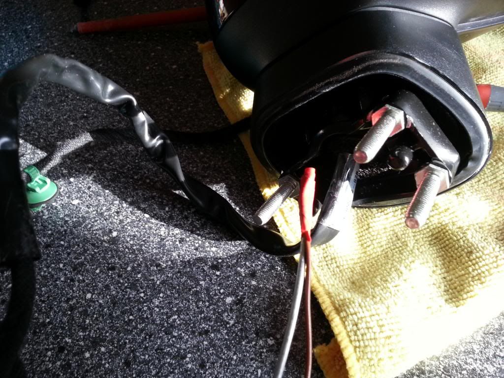

Feed two pieces of wire from the bottom of the mirror housing through the mirror body shown in the photo below. I used a coat hanger with the wires taped to the end (Don't go through the foam sponge, aim to go at the side). Push and wiggle until the coat hanger comes out the top above the spring shown. See pictures below.
Pull wire through mirror body, strip the ends of the wires and crimp onto the ends the two female spade connectors.
Re-assemble the mirror casing/body in the reverse way you took it apart. Push on the two female spade connectors onto your new heated mirror glass and then push and clip the mirror glass back into its housing. The two long (finger type) pieces of plastic need to be guided into the two âbronzeâ type oblong clip holders shown in the photos above. The mirror glass should just snap back into its clips. Apply even pressure and again be careful not to crack it.
Tape the two new wires to the remainder of the wiring loom all the way down to the 16 pin plug.

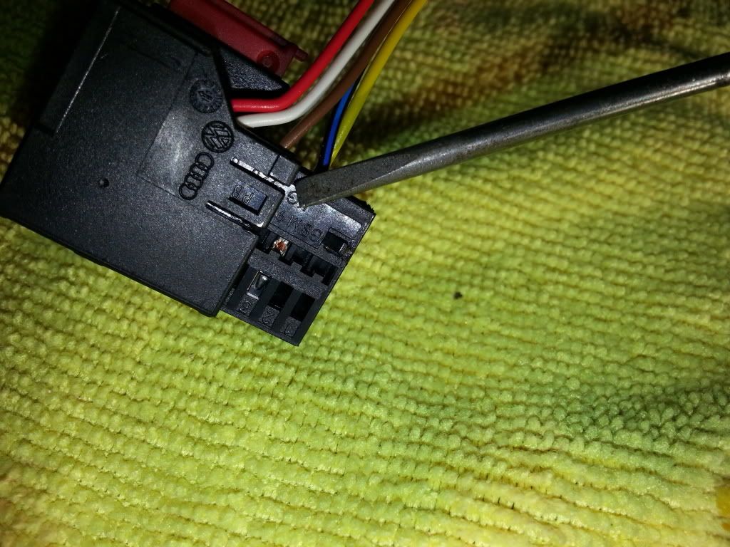

The 16 pin plug has inserts for 16 wires and these inserts are all numbered.
With a small flat headed screwdriver lift up the small clip on the side of the 16 pin plug gently and slide out the inner body.
A Picture of a repair wire is shown below on top of the wiring diagram for the mirrors. Ignore the purple/black writing in pencil, this is the colour of the wire found in the loom of a car with heated mirrors already.
Cut the repair wire in half and insert one end into the pin marked number 15 on the 16 pin plug. Solder the other end of this repair wire to one on the new wires going to the new heated mirror glass. Use heat shrink wrap to protect the soldered joint and tape this to the existing mirror wiring loom.
Locate the blue/black wire which is already inserted into the 16 pin plug at pin numbered 3. Splice into this wire and solder the other new wire from the new heated mirror glass to this blue black wire. Protect with heat shrink wrap and tape to the existing mirror wiring loom.
Reassemble the 16 pin plug and locate back into the door control module.
