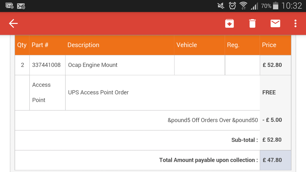

and here are the solid alloy ones

Who makes or sells the alloy mounts Mike?

Yes. They are the same for both sides, the drivers side uses the cover provided and the passengers side does not.

There is the EXTRA10 code for another 10% off also

Cheers they've been ordered! Quick question where you mentioned cutting the studs. Does it make it that much easier with them cut?
