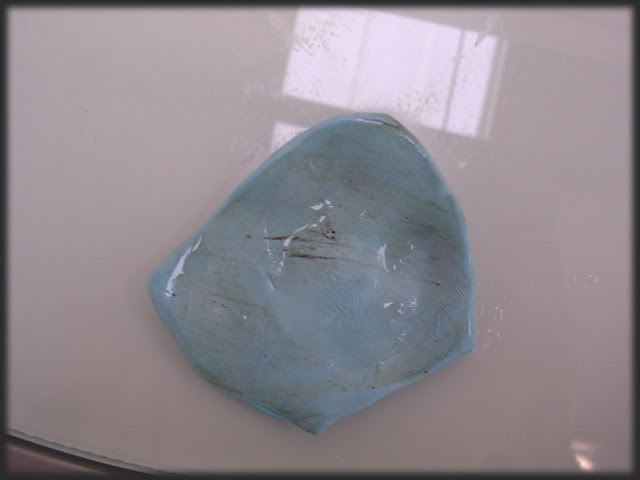

The car was then rinsed again before i moved onto the clay stage. Meguiars Mild Detailing Clay was used this time:
This removed a medium amount of contamination:
