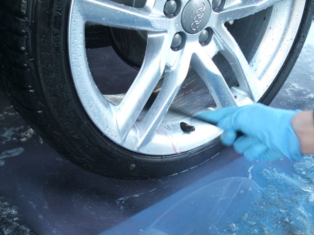

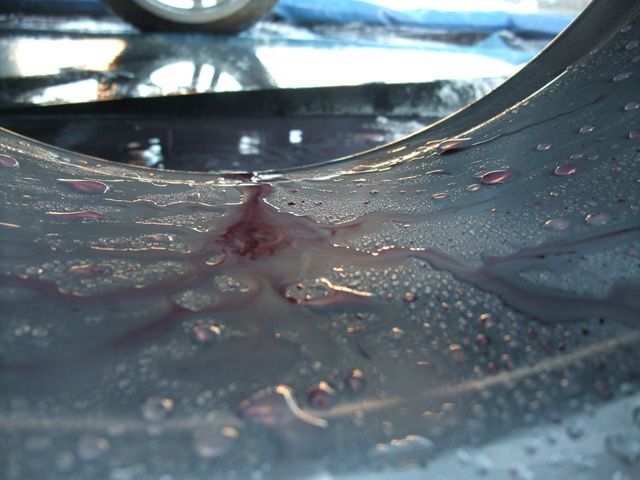

Another rinse followed this before Iron-X was applied to remove some light iron contamination:
After a minute or so you can see it doing its thing:
The wheel woolies were again used here to give the Iron-X a bit of agitation:
And then rinsed a final time:

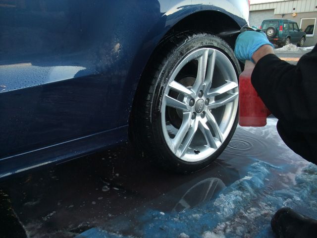

Onto the tyres and arches now, these were sprayed with Meguiars Super degreaser (4:1):

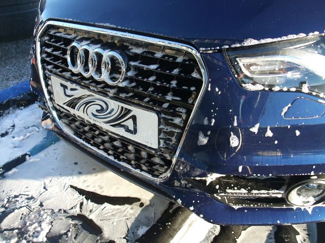

The car was then foamed with APC at a temperature of approx 60 degrees:
Left to dwell for a minute or two:
Then rinsed at high pressure at 60 degrees:

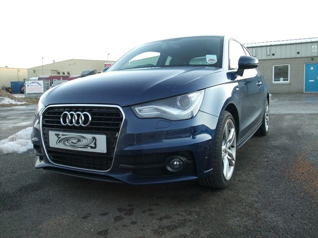

And here are the afters :)
Thanks for looking!
