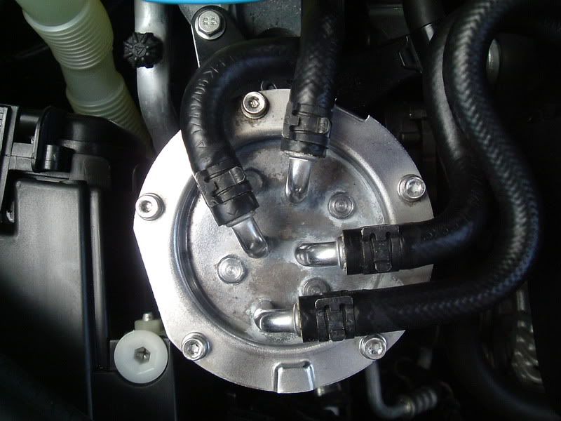

Can someone let me know what the part number is for the fuel filter housing lid on a 2006 Audi A3 2.0TDI 140BHP.
As you may have probably noticed on yours they get very very grubby and corroded so I was looking at getting a spare and having it powder coated gloss or matt black.
Pic here:

According to ETKA the flange is only available as part of a complete fuel filter. The part numbers for the full filter unit are:
up to VIN No: 8P-6-176000 1K0 127 400 K
after that: 3C0 127 400 C

Thats lovely and clean, you should see mine, one big lump of rust!
