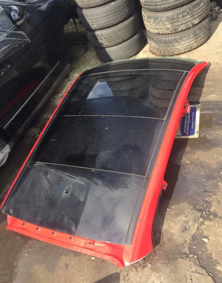

Now we always wanted a Pan Roof, however finding an A3 with a pan roof is very rare, never mind a 3.2 V6 DSG Sportback with a pan roof!
So just typed in audi a3 pan roof into ebay and found a seller in Bradford who had one for sale!
Taking inspiration from Amar's thread a few years ago, we decided if it has been done before, then it definitely is possible!
This was the first item we bought for this car lol, don't have the original picture of the exact one we bought but found a very similar looking image to what we got:
The one we bought as it was cut straight from the pillars of the car, came complete with the sun roof motor + plugs, complete black roof lining with sun visors, grab handles, interior lights, A + C pillar trims. The only missing pieces were the B pillar seat belt trims.
Grabbed hold of a friend who has a van, took a trip up north and picked up the pan roof and trims!
The roof and trims went straight into the garage and the search begin for other parts!

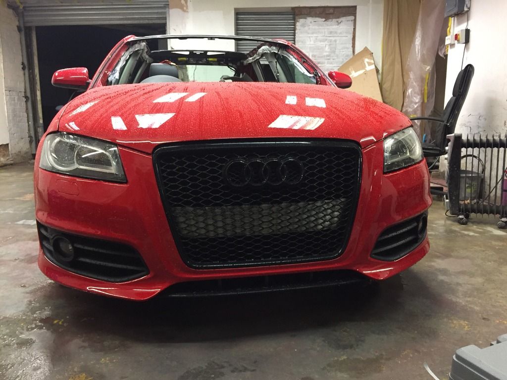

Front end stripped:
Test fit of the front end:
Bonnet didn't sit quite right on original hinges, so ordered a pair of facelift bonnet hinges.

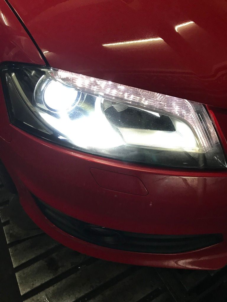

Kufatec bi-xenon headlight adapters had also arrived so got them connected up and the extra 4 wires ran under the dash to wire to the J519 module.
However realised that the module needed to be replaced with a newer version to support the facelift bi-xenon lights, so couldn't get the lights up and running

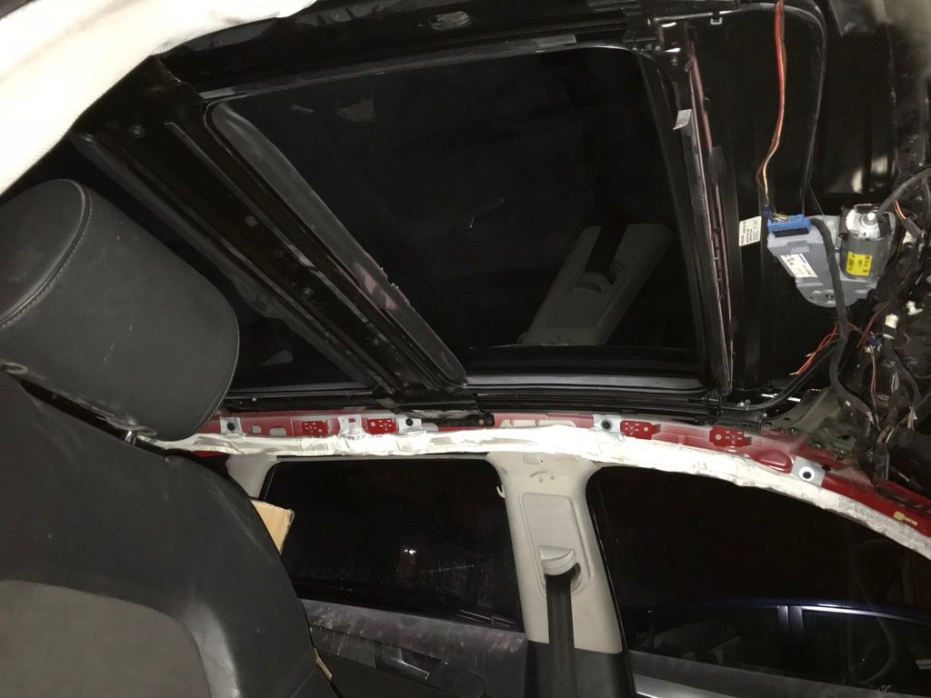

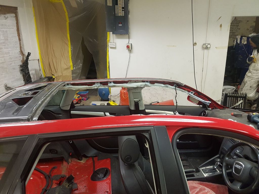

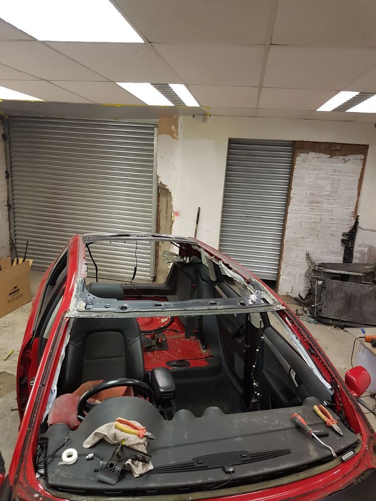

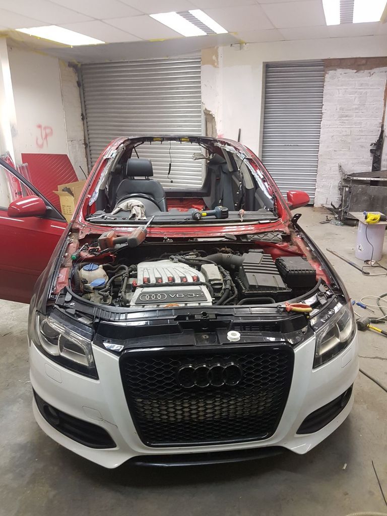

The car was at the bodyshop, windscreen removed, top roof skin cut out, front windscreen bar removed, middle bar removed:
Picture from the front with the 3.2 on show
The pan roof was then taken apart, glass separated from the frame.
The front panel from the pan roof frame was then welded onto the car:
The rest of the frame was then welded onto the car, I didn't get a chance to go down myself and get some pics, however my brother made a little video which showed some of the weld work and the car prepped up for paint. Will try uploading it to youtube and posting a link.

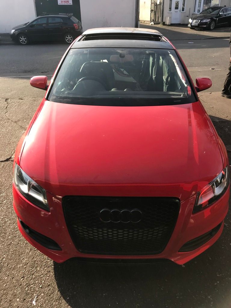

Had the car resprayed in Misano Red while it was there to get the real S3 look:
Did tell the bodyworker to spray the silver slam bar behind the front grill but he forgot, so that still needs to be done.
I've seen a lot of replicas that have left the slam bar silver and it really annoys me so definitely needs to be done black asap!

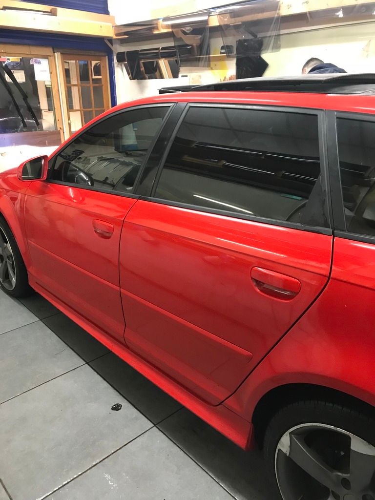

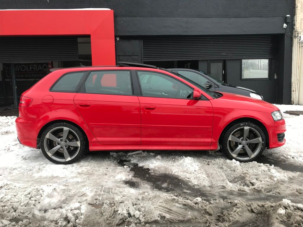

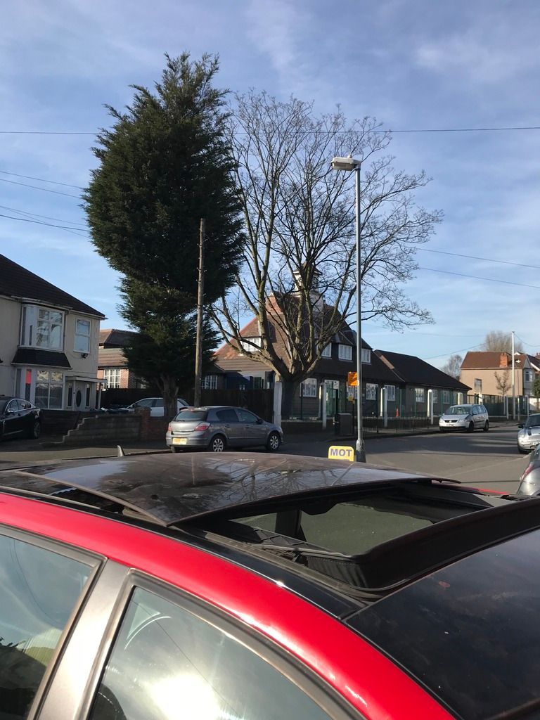

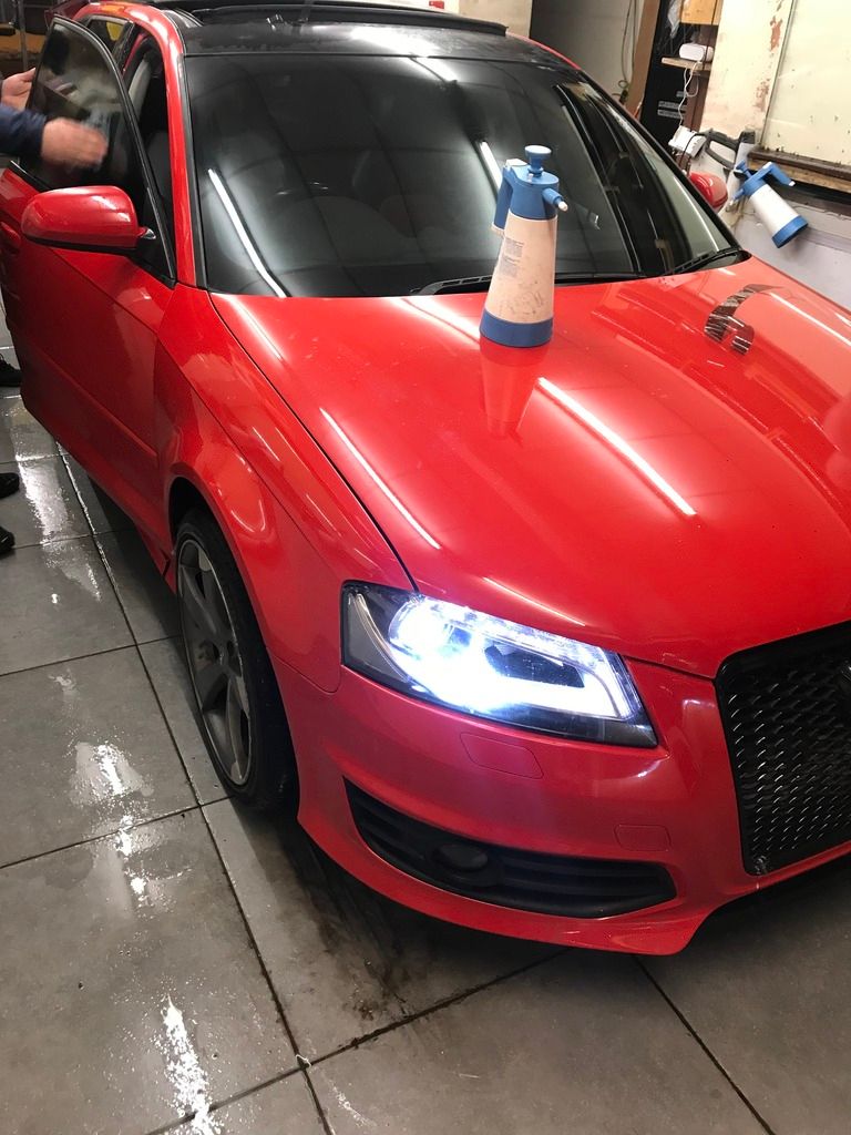

Car came out the bodyshop and home Thursday 22nd Feb with the windscreen and pan roof all fitted in!
Now the pan roof motor had 5 wires coming off it.
2 thick wires which were positive and earth and 3 thinner wires.
Ran the 2 thick wires down to the fuse box, positive straight to fuse box, earth = earthed lol
1 of the thinner wires we figured was an ignition live so tested few wires for an ignition live and wired that up.
Was unsure what the other 2 thinner wires were for so just got some insulation tape on them and left them tucked away. (Could quite possibly need wiring to the alarm or something so roof opens/closes with lock/unlock on keyfob maybe? hmmm)
Pan roof now working!

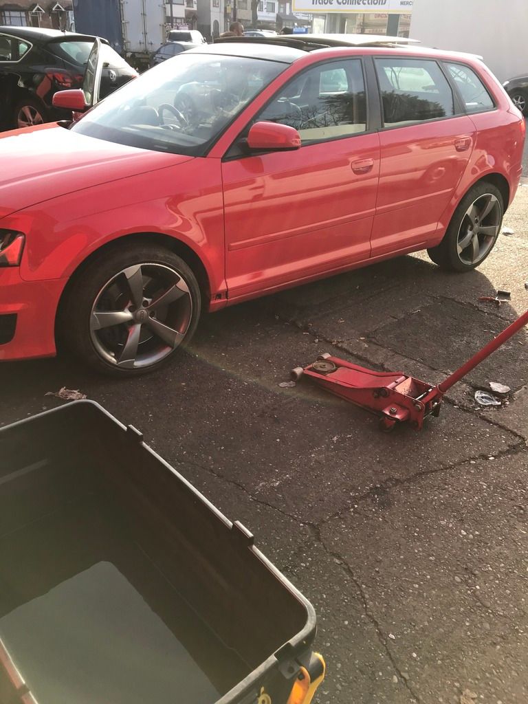

Also picked up a set of genuine 18" rotor alloy wheels with near enough new tyres, so had them balanced and fitted:
Had ordered a new Central electrics (J519) module the week before so got around to fitting that in, wiring the kufatec adapters and coding to get the bi-xenon shutters and DRL's working correctly, also got hold of a genuine ballast for the headlight that came without one and a pair of LUNEX 6000k D3S Xenon bulbs

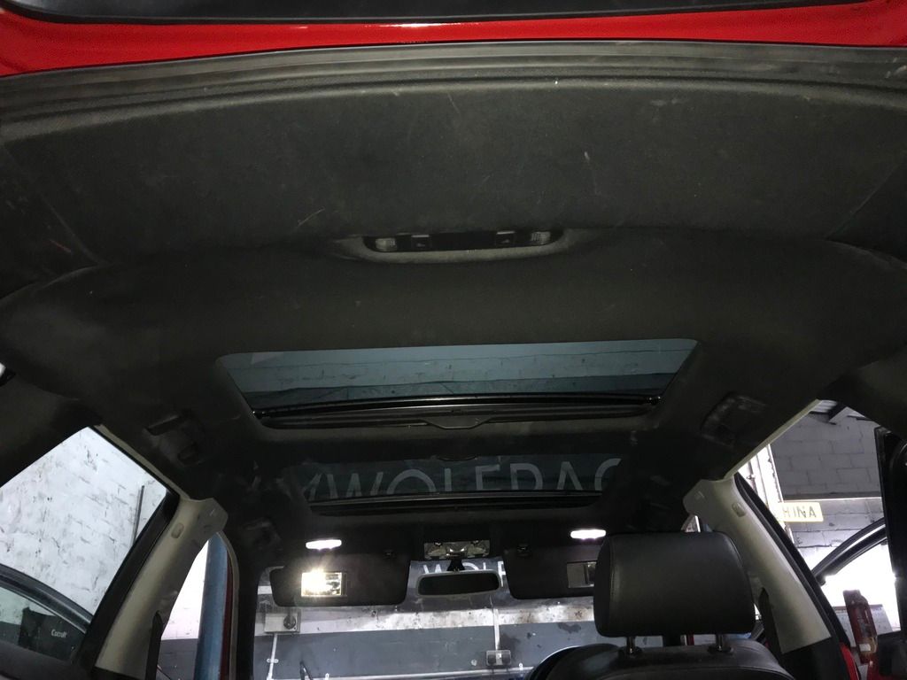

Spent a few hours yesterday (Sunday) getting the roof lining and trims into the car, the old headlining didn't have any sun visor lights, but the new black lining came with some nice LED units so got them wired in too while we was there.
Still missing the B pillar seat belt trims in black, only non black trims left so need to get onto them pretty soon

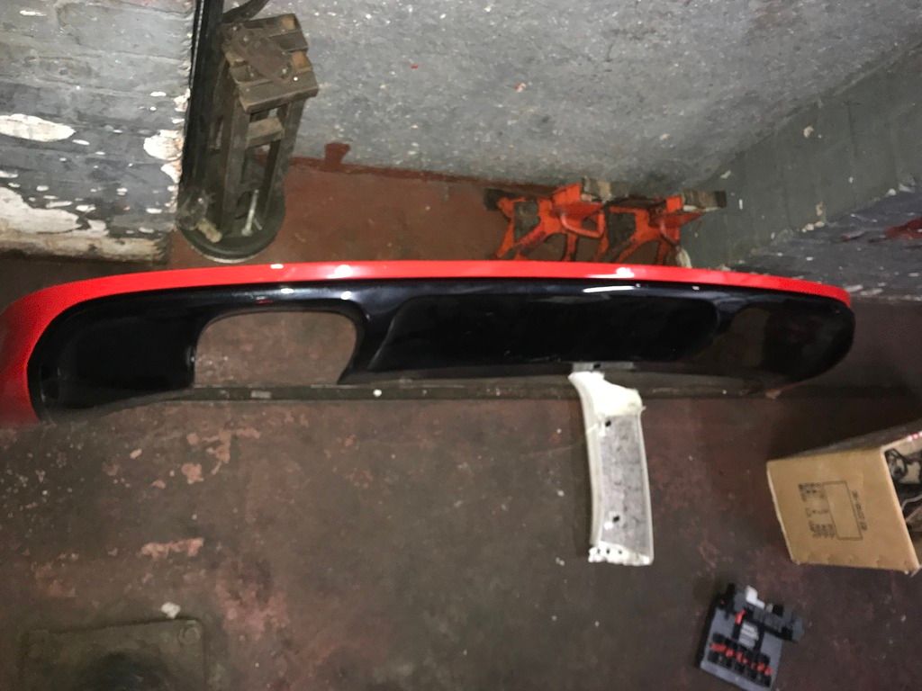

Also picked up the side skirts and rear diffuser, picture of the diffuser below (you can also see the old J519 module in the corner too )

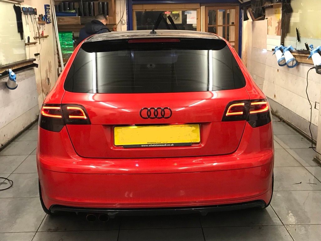

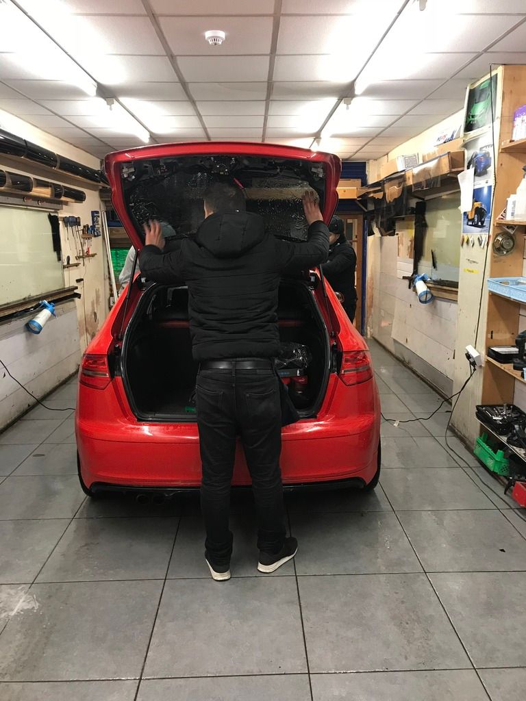

By the end of this week, the aim is to have done:
Diffsuer + side skirts on
Windows tinted
Seats and door cards fitted
Rear lights fitted and coded in (waiting for kufatec adapters to arrive)
Gloss black rear Audi badge
Will post with updates as and when they happen

THAT FRONT END LOOKS PROPER NAUGHTY IN RED WITH BLACK GRILL MATE
:hubbahubba:
How hard was it to remove the roof skin and the middle bar?
Also, I think you should paint or wrap the exterior door pillars (If you want to of course ) to gloss black as in the face-lift black edition A3s. Its a quick and subtle mod. I've done it to mine on one side as the paint was peeling(Still need to do the other side). Ill send a pic tomorrow of mine.
Overall definitely looking forward to updates.:thumbs up:
Omy193
Aug 20, 2014
487
119
:hubbahubba:
Funnily enough I was looking at the door pillars the other day and thinking “Should of had them done gloss!”
Do they come off easily? Will definitley be getting them done.
Roof was removed by the body worker, but he didn’t have any big issues to be honest as its just a skin.
Middle bar bolted straight out, the front bar had to be cut out and front bar from the pan roof frame welded in along with the rest of the frame.

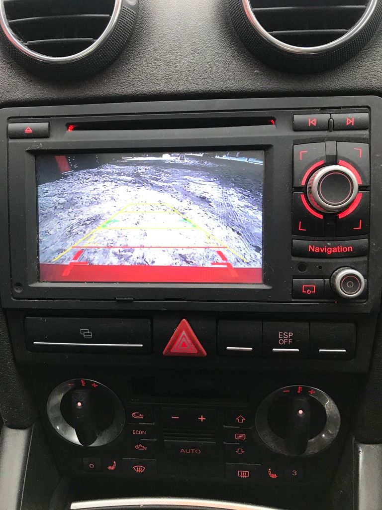

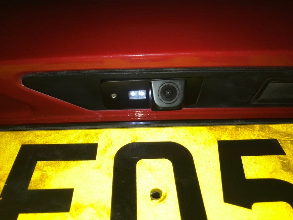

Now, previous owner had an aftermarket RNS-E style stereo fitted with a reverse camera. However didn't quite like the look of the reverse camera as it was too obviously visible, so ordered one that fits into on of the number plate lights.
Had to remove the number plate light holder, drill a hole to get the wiring through then fit the camera, couldnt get a flush fit as the wire is still in the way:
Now the stereo also had an option for AV, so got a XTRON's DVB tuner and wired that in, freeview tv now working :D

Also fitted the side skirts and rear diffuser, completing the S3 bodykit, also fitted and coded the facelift LED rear lights, look of the car has completely changed now:
Next up were window tints "ALL AROUND" :yes:
I weren't kidding when I said all around :welcoming:, cheeky tint on the front screen :busted cop:
Now wanted a light smoke on the rear lights, however the quality light tint he had was a bit darker, so thought we'd put it on and see how it turns out, also fitted a gloss black audi rear badge:
Personally, I think the rear lights look too dark now.
Looks "ok" at night, but during the day its not all that. Will keep as they are for a while, see what opinions people give, worst case scenario can always take the tint off as its only film.
What do you guys think of the rear lights now?

SpeedFerret
Jun 22, 2013
62
16
I'd agree with you on the rear lights .. too dark.
Not entirely sure about the black rear badge either ... trying too hard perhaps.
All personal taste .. I like sleepers but thank Allah we're all different.
Omy193
Aug 20, 2014
487
119
After looking at the rear lights again today in the day light they definitely look rubbish now lol...tint film will be coming off :whip:
SpeedFerret
Jun 22, 2013
62
16
If you have time tomorrow, it would be good to see a rear end with lights back to normal.
