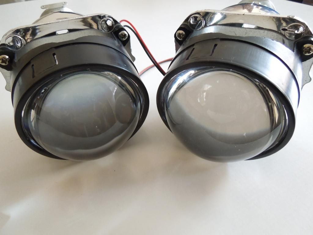

Mini H1 HID projectors - Supers.
1 pair of HID projectors with fitting kit (RHD - driving on the left)
1 pair of shrouds (from ones in stock)
UK postage.
Price is £59 posted to the UK
in addition you will need a H1 HID kit which I can supply or you can source your own.
Output of 1 projector with a 6000k HID bulb
These are a great upgrade for those that don't have Xenons fitted and want a step up at less than half the price of xenon.

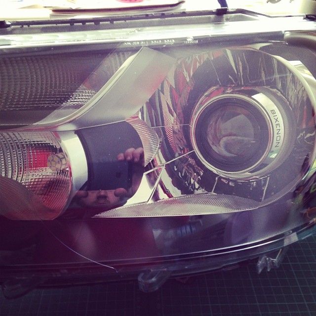

These are the headlights
ImageUploadedByTapatalk1409596225858825
I have seen this on eBay but I was hoping for a more factory fitted oem look
ImageUploadedByTapatalk1409597017575964

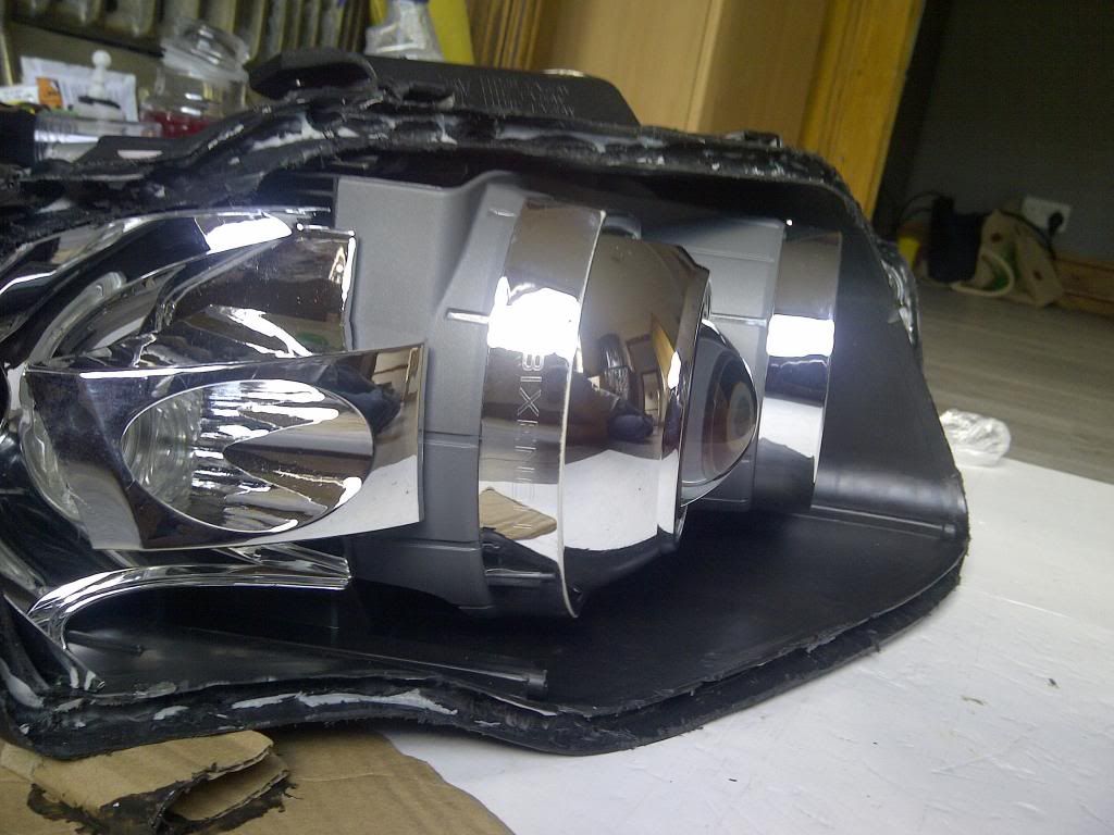

if you post me the lights its £50, this service will include, taking headlights apart, glue on the shrouds to hold them in place and adding extra sealant if required, new sealant will not be required if you don't get any dust or dirt in the channels, I usually split the lights and then put blue masking tape over them to prevent this.
If you want any spray work done we would need to discuss what needs doing.
I use a heat gun to open the lights, Get a big box, cut a hole in the side and make it into an oven :)

Iris will fit in there, if you look up the thread at the VW van that's fitted with iris shrouds you can see how far the top of the shroud is from the projector, Andy is getting sent the iris so he will see but I am confident it will be.
if you just need the rear reflector sprayed then just the price of a rattle can will be fine to hid the old reflector.
I think going with the iris chrome will look good, the iris do come in gloss black but its all black if you wanted the murdered out look. if the shroud needs trimming it can be done so its flush to the headlight its self.

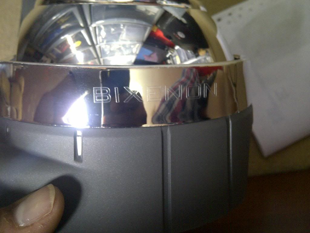

All sounds good mate. Does it say BIXENON on the shrouds you have?

The bi xenon sticker is an extra, that T5 van that was done was for Syco Graphics so he knocks the stickers up, I can get them for a couple of quid.

HID bulbs are £15 for the pair. The heat from it will help stick it down better but it wont just come off the reflector due to the heat so don't worry about that part.
The connector for the high beam is what you would attach the Wire for the bi xenon shutter to, I always solder this as its wont ever come away, if you look in my picture you can see the wires coming out the bottom of the projector.
