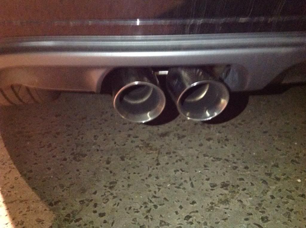

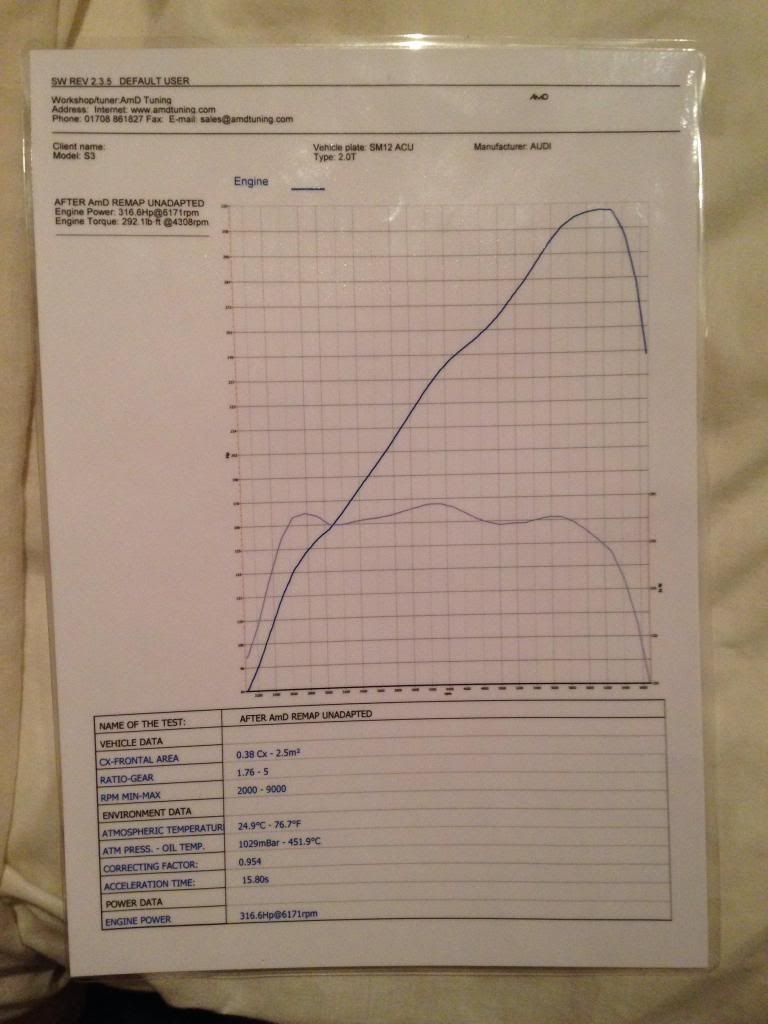

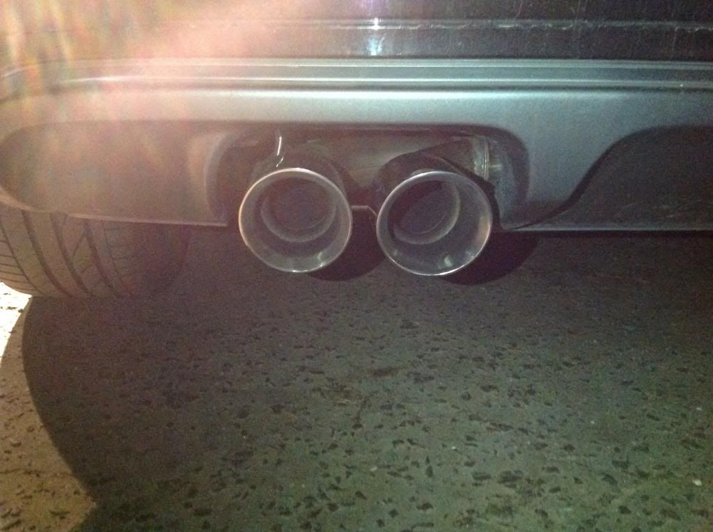

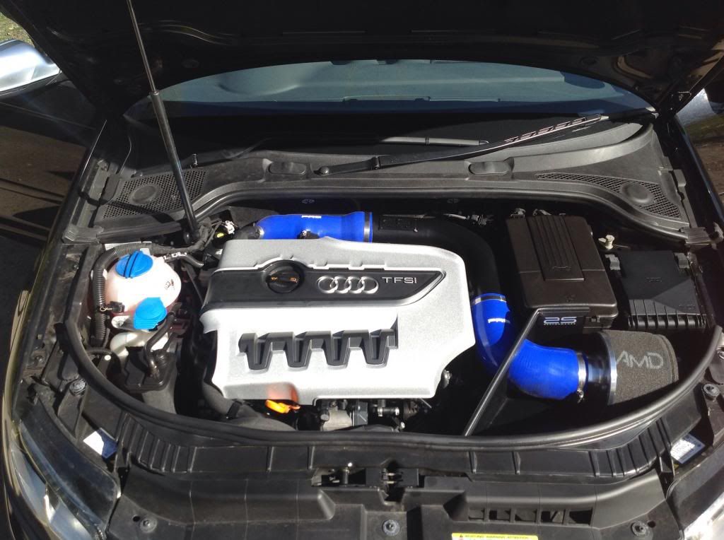

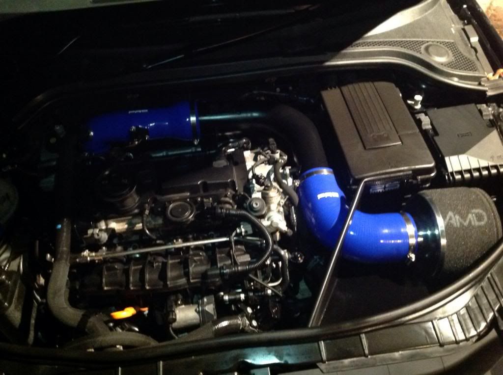

****UPDATE**** After a long day waiting for my car to get its new additions from AMD here are the results and couldn't be happier Excuse the pictures(not great) First of all the Miltek non resonated cat back Followed by the Cai in blue And finally the stage 1 amd remap and the results!! The result is amazing and should defiantly keep me happy for a while! Get my tats over tomorrow so will add some more pictures and update then! Cheers Alex

What's your view on those results he said let it settle and I'll get bit more from it . Yeah I've already started thinking what's next! :/ haha
You'll get a few percent more,and the midrange torque should smooth out a bit as the car adapts. It really is quite addictive.....I've had mine for nearly 6years from new,and it's still getting better.
Looking good, stage one deffo transforms the drive. What do you think of the non res catback? How much better than stock does it sound...
Yeah I seem to have started getting addicted!how much have you spent in total if you don't mind me asking Alex? I think it sounds a lot better than stock stetheo , has a deeper grunt on it- was definitely a good purchase
The speed is a good step up from before did it all for the fuel economy you get from the map of course haha , like the noise from the induction!
Is it just me or does the torque line look a little odd. Id expect a peak early on in the rev range and then a gradually decrease over the whole rev band. Nice power result though, however i managed more torque from stock on a rolling roadâ¦.
To be honest mate I don't have greatest idea ...? I thought in stock s3 was about 250 torque ? .. Could be completely wrong
It may well change a bit over the next few days as the car adapts,and if I remember,mine barely made 310lbs on Stg1.
Another update on the s3 this morning! Engine cover now fitted! - think will be last thing I do for a small while! Alex
Glad you are pleased with the upgrades Alex. With reference to the torque, from memory I think it was a DSG model. Due to this it won't show as much torque as it actually has and sometimes it does something funny with the graph (the power delivery is nice and smooth on the road). If the car ever has a DSG remap then you can get a full power/full throttle run from it. :icon_thumright: P.S Alex, I think we need to fit a TTS engine cover to your car? Even more stealthy then!
Cheers Ben , haven't stopped driving it since Friday! Like Alex has said its a slippery slope and the dsg remap is another thing on the list now....I'll drag it out as long as possible! Didn't know you did fit them!? Stealthily ...how so?
Do you know.....that came across almost as...... "You WILL tidy up your engine bay"......LOL I can't have anything covering up the new piece of shinyness,although the engine does need a good wash and brush up after all the rain.

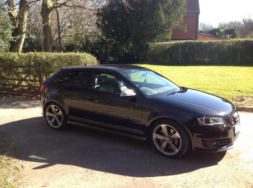

Another small update... Small extra mods to keep me amused till stage 2 -Black Audi Quattro tax disk holder -Audi s3 mats - sorry for not being clean ! -Also got a new number plate surround rather than the dealership one And a picture of it parked outside Need peoples advice on whats needed for stage 2 plus a bigger better turbo! Already have Miltek cat back Cai Stage 1 remap Booked in GFB dv+ DSG software upgrade Any help on direction on what i need to buy next would be great. Cheers Alex
