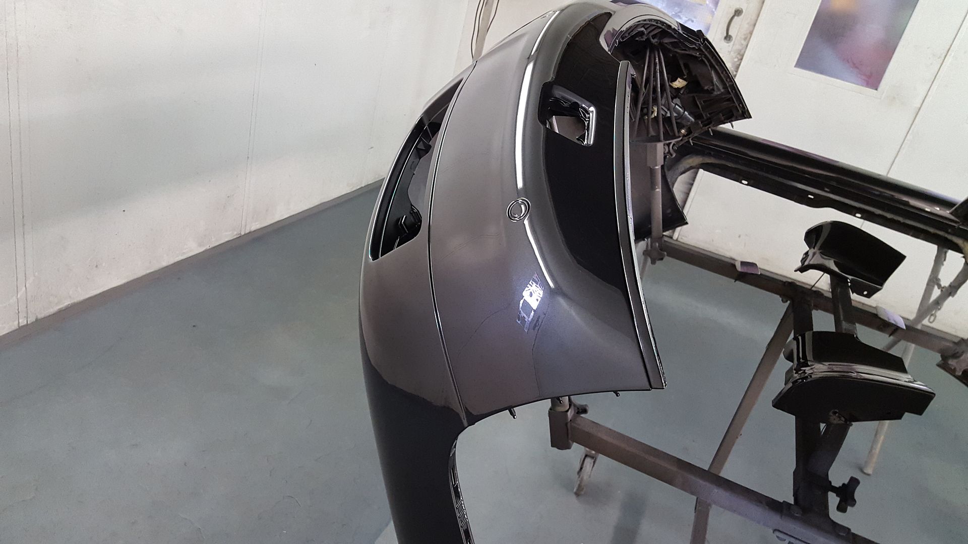

so got the bumpers out and stated fitted them back up
all back together
