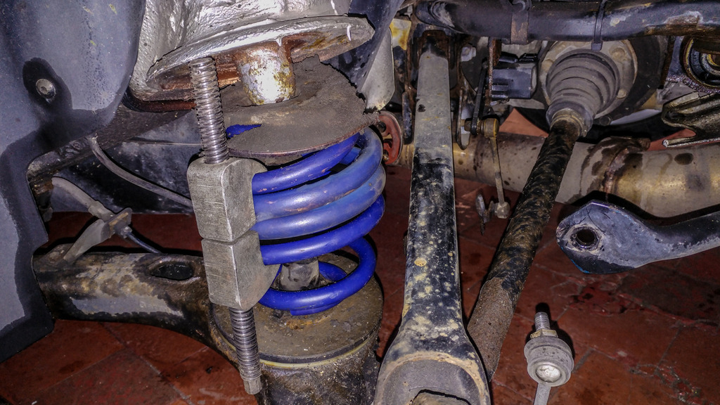

I had to do something... I have considered replacing the lot with KW v2 coilovers but tbh even with my discount its an expense I'd rather put towards a lens than suspension these days so decided to replace the springs instead and go from there..

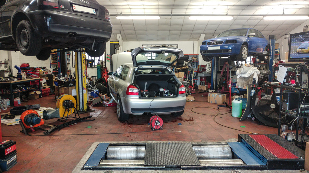

Was at the unit today so cracked on with the job... as you can see I was in good company surrounded by S3's ;)

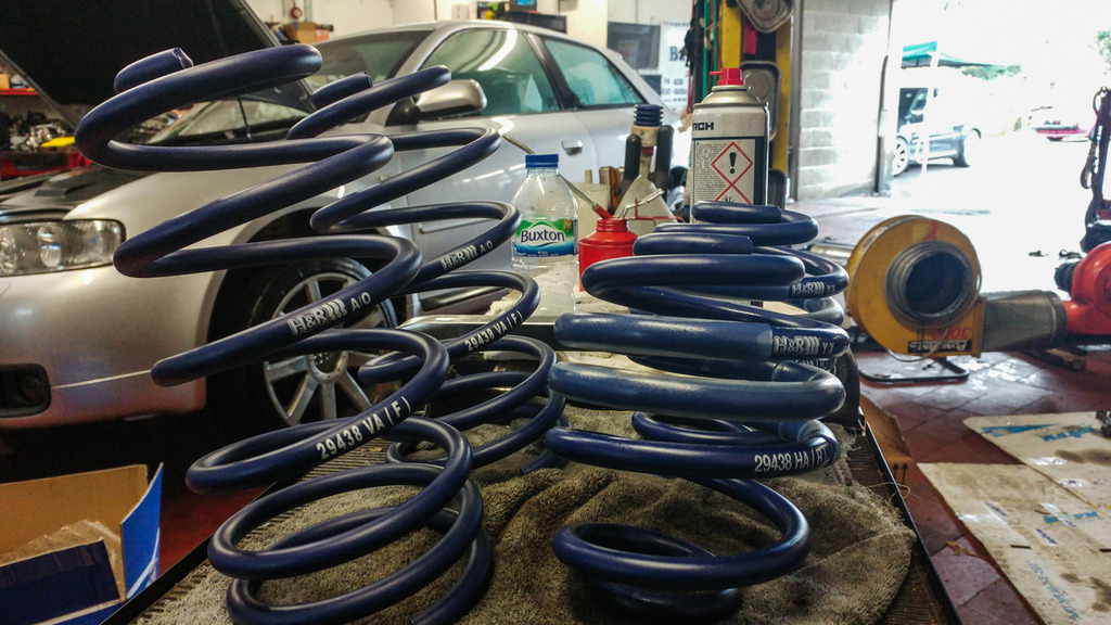

Did consider a new set of Apex 30mm but decided on some H&R 25mm instead and managed to get a set at a really good price new...

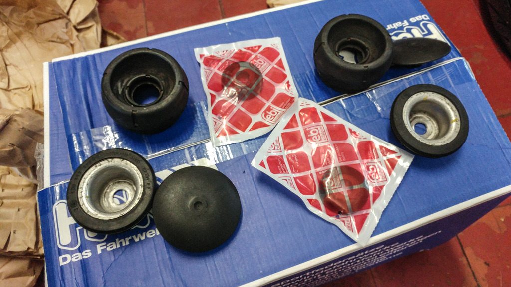

My previous LCR top rubbers and some new bearings as I wasn't sure how good the ones I was taking out would be...

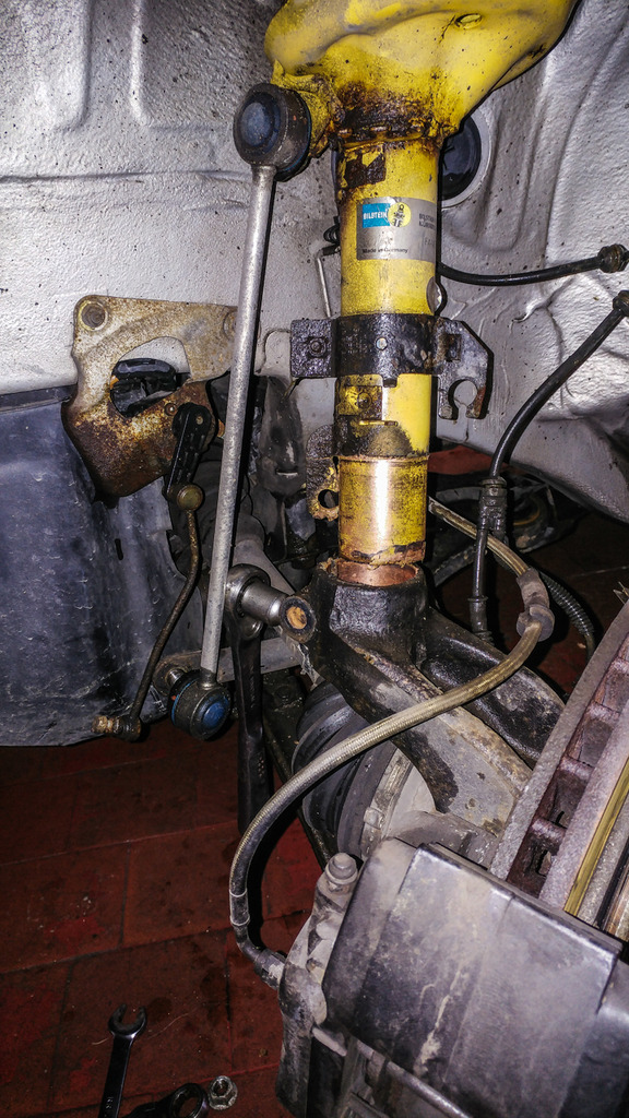

Started on the fronts... don't forget to undo the Xenon level sensor arm from the front arm (if you have this) else you can snap the arm off the sensor...

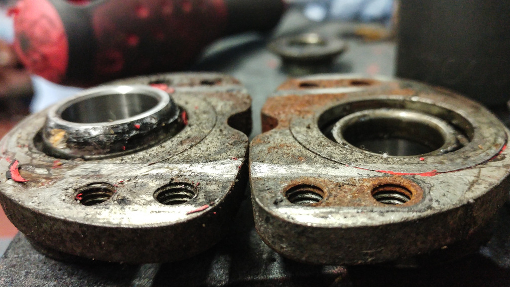

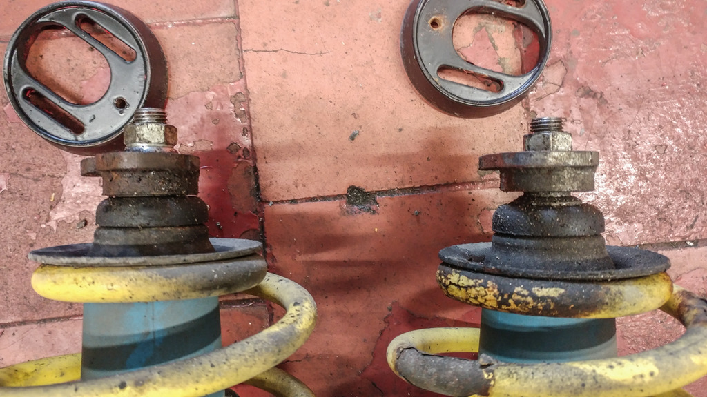

Near side camber plate was toast as suspected...
Bearing had been forced up from the constant tw*tting against the bump stops...

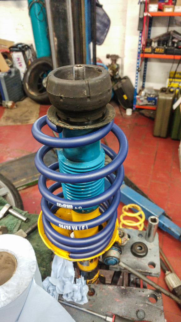

Built up the struts with the new springs and LCR mounts...

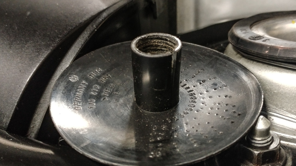

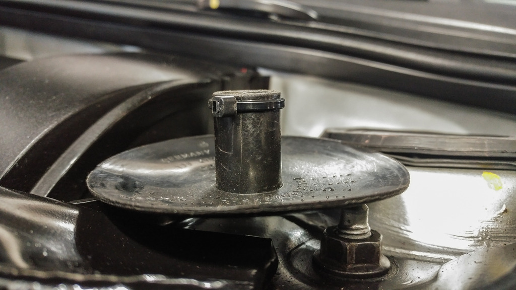

The plastic caps for the top of the suspension were split... normally I'd consider replacing them...
...but there isn't much duck tape or a cable tie won't fix lol...

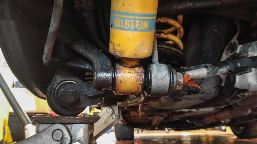

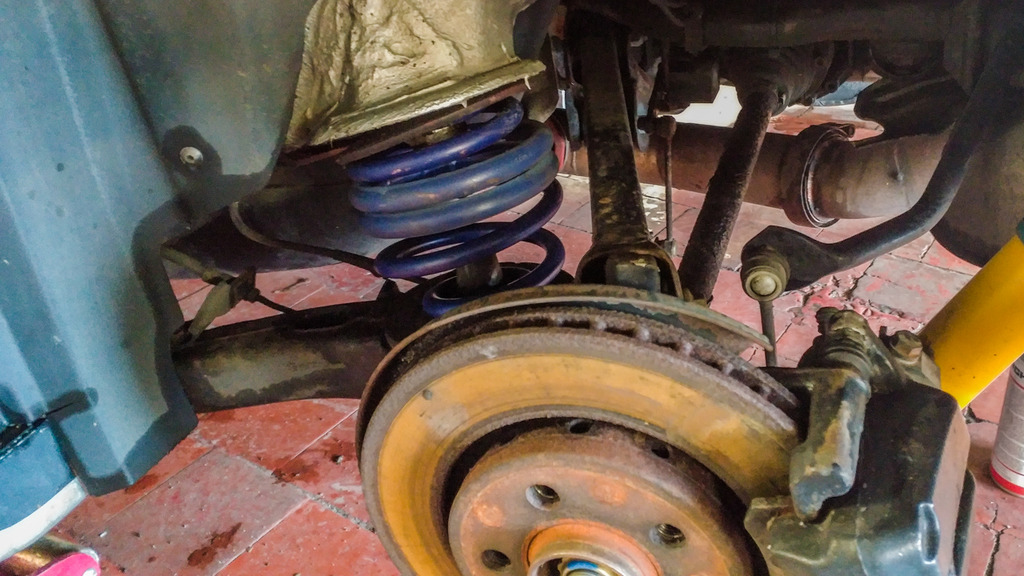

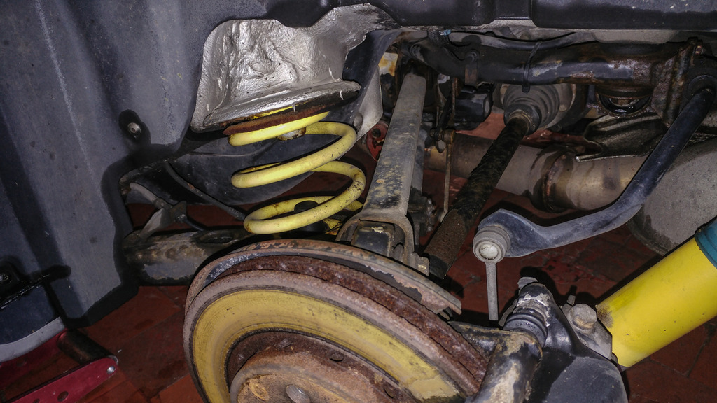

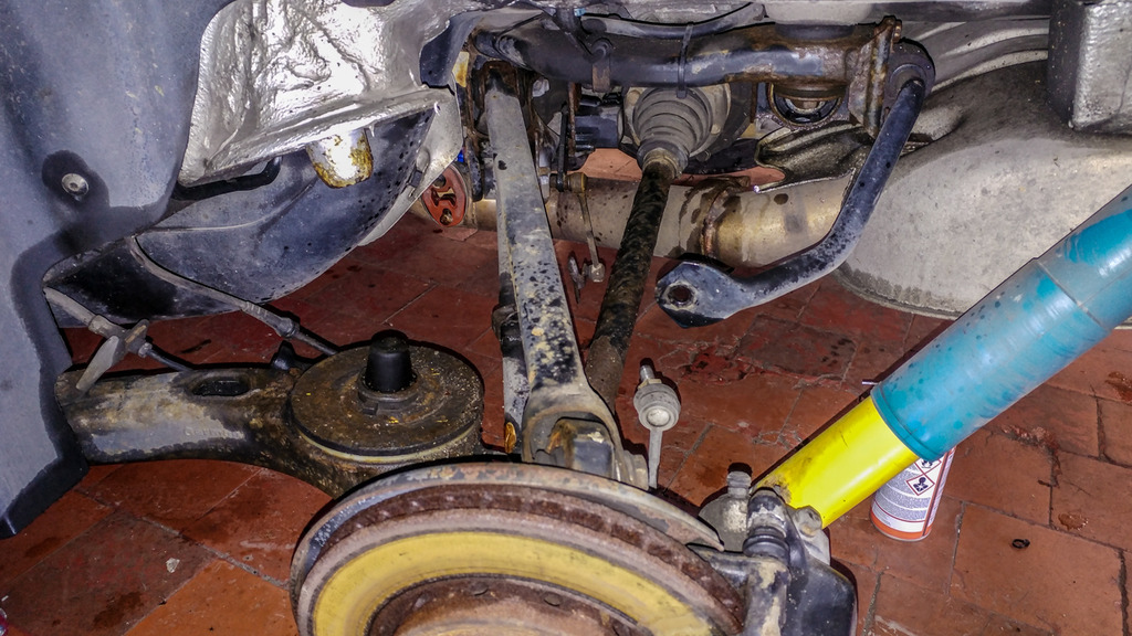

With the fronts all bolted up it was on to the rears...

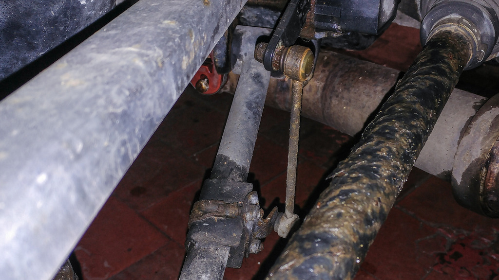

...again don't forget to undo the Xenon level sensor arm... this is a favorite to break...

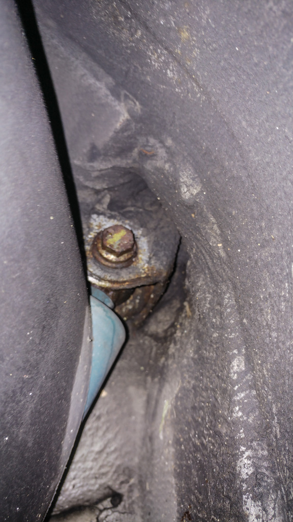

Normally you would undo the lower damper bolt to allow the arm to drop...
...but I have seen a fair few of these strip threads and when I tried to undo the bolt it didn't feel 'happy' so I left it and undid the damper top bolt instead... just need to undo one screw on the inner arch to be able to peel it away to get to the bolt..
..it uses a flat washer with 'serrations' on so is tough to undo but its out of the elements up there and more likely to survive than the lower one...

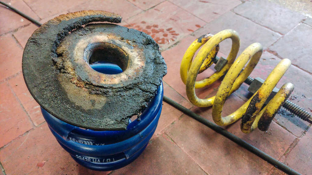

Undid the drop link to the ARB too and got the spring out... it did need spring compressors though...
Top rubber locator thingy has seen better days so will need to replace them at some point but it will do for now...
Bit of wrestling and the spring was in...
...and done... :)

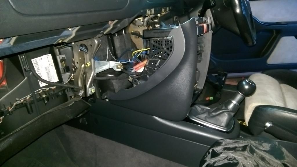

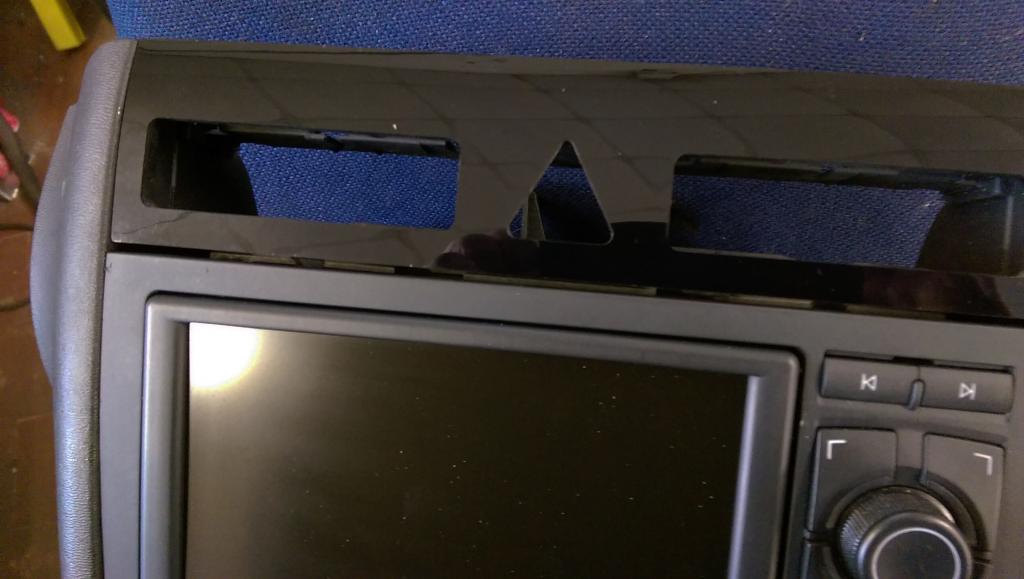

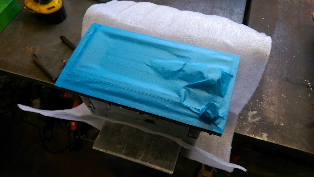

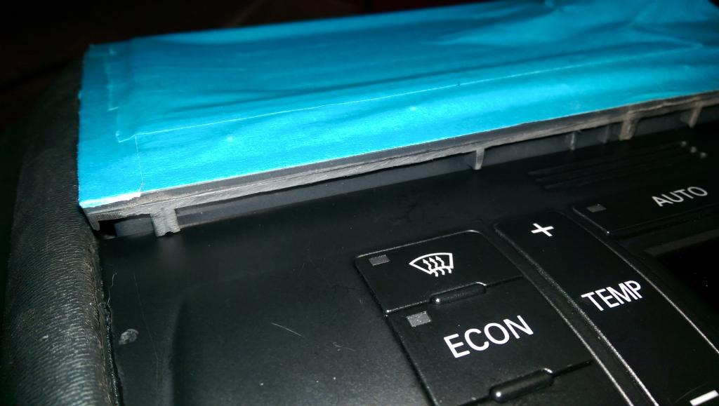

Masked up the RNS-E ready to start trimming the front panel..
One thing that vague guides don't mention is the approach to take with this... I went in assuming I just needed to trim the bottom as this is the suggestion but... what I should have done is fitted the top trim (where the cup holder etc is) first and adjusted the cage to allow the gap between the top of the RNS-E and the top trim to be as minimal as possible... I didn't think of this as it would have closed up the gap I was left with...
There is enough meat on the bottom of the RNS-E to have done this and kept a tight gap... I also had a slight hiccup on the bottom too :/
Not perfect sadly... RNS-E front panels come up for sale occasionally... I might see if I can track one down and have another go...

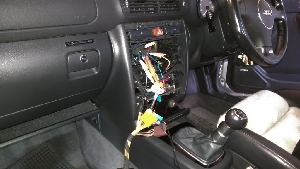

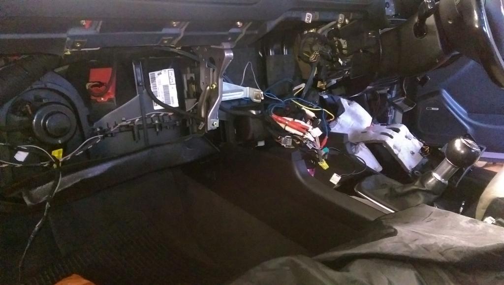

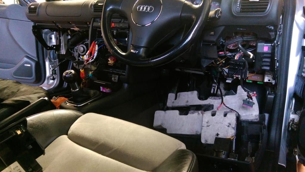

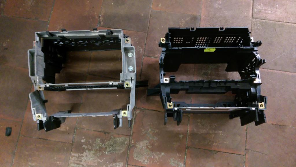

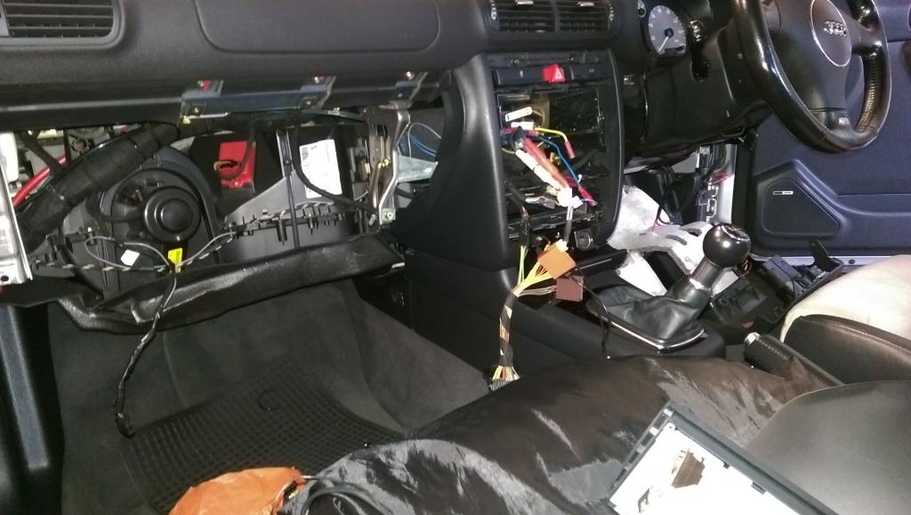

Next job was to remove the console to be able to swap out the cages...
There is a screw each side here that needs undoing to release the console plus two behind the top trim panel...
All out... phew!
Double DIN vs single DIN cage...

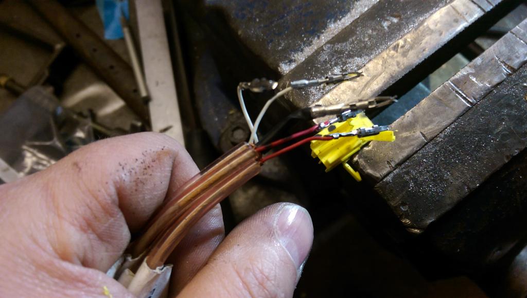

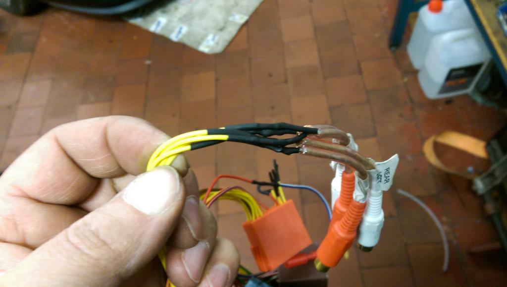

Cut the plug of the RCA adaptor as I was going to try and pin the OE plug but as I have Bose there is already wiring from the cars loom for line out going to the Bose amp so I cut the RNS-E adaptor and soldered the RCA lead on...

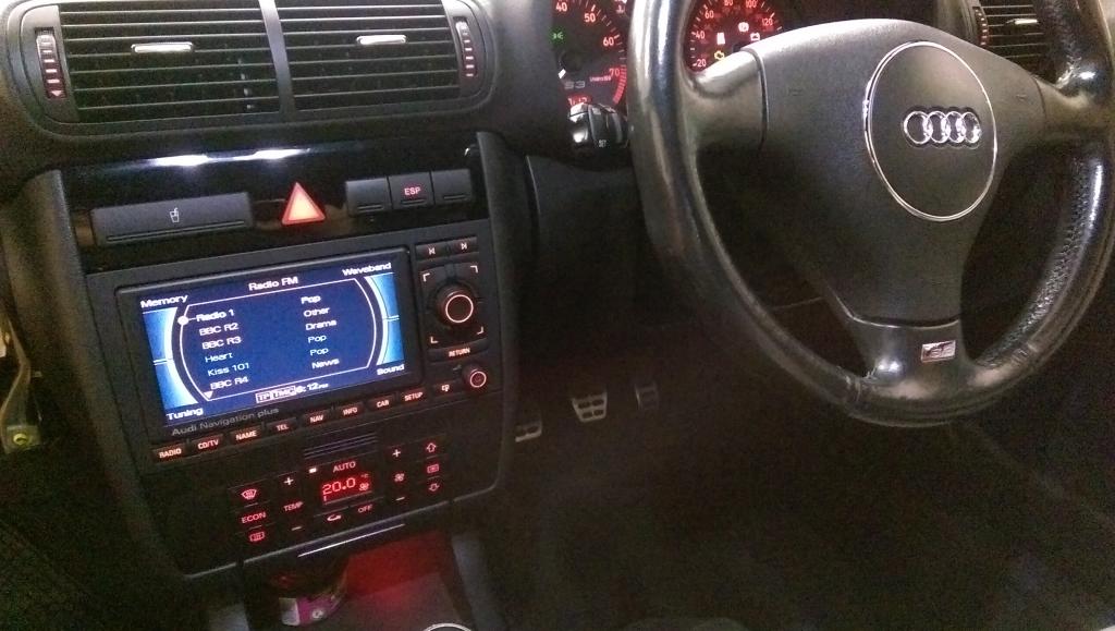

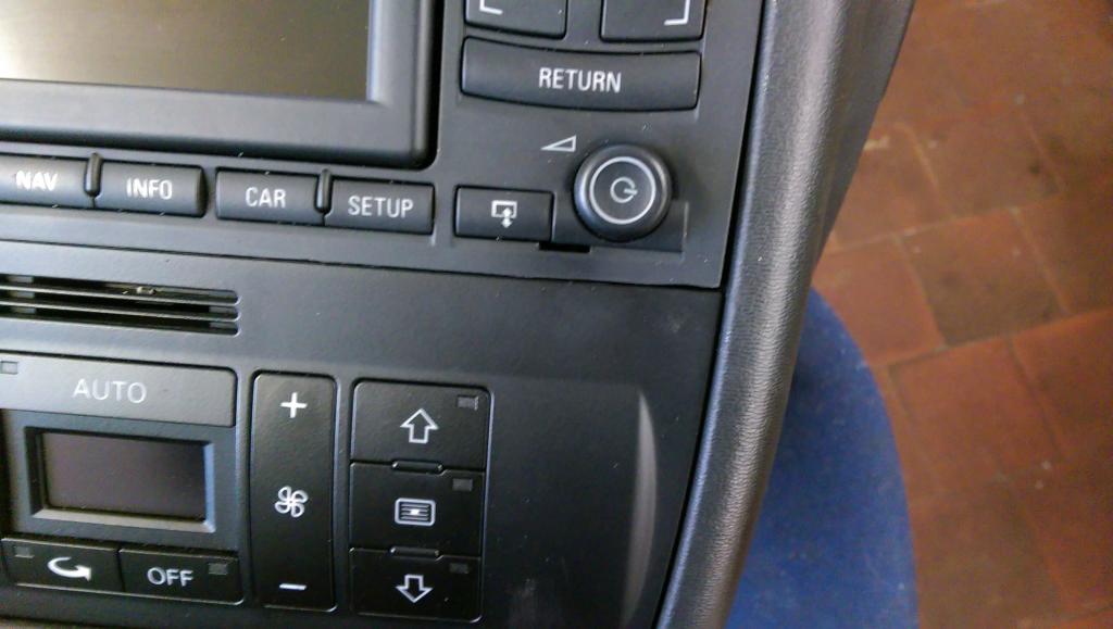

Put the console back in and fitted the headunit in... took a lot of juggling to get the unit pushed back enough to fit in... had to rearrange the looms to get it all in but finaly it clicked in...
The unit was coded for an A4 so I need to recode it for an A6 and change the startup screen... I also need to do all the other required coding to get it working with the DIS... I didn't need to wire the canbus as my car already has this for the instruments...
Just need to work the correct coding out as I didn't have time and a phone line fault at Bill's unit meant no easy internet access so I will have a look tomorrow at work ;P
Navigation appears to work too... I stuck the GPS sensor just under the dash, it was magnetic so I placed it on the dash cross member
Other than the gaps which I think I can close up a bit I am happy with the outcome so far...

RCA lead was to run my aftermarket amps... wiring needs to be correct for channels to work correctly and correct polarisation of signal

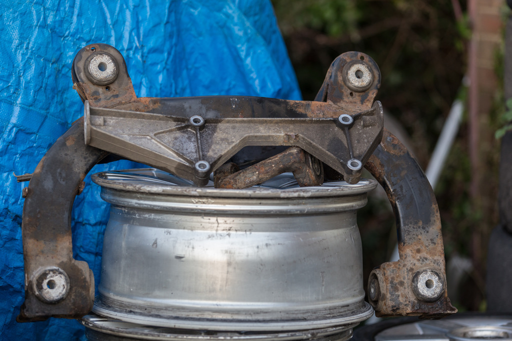

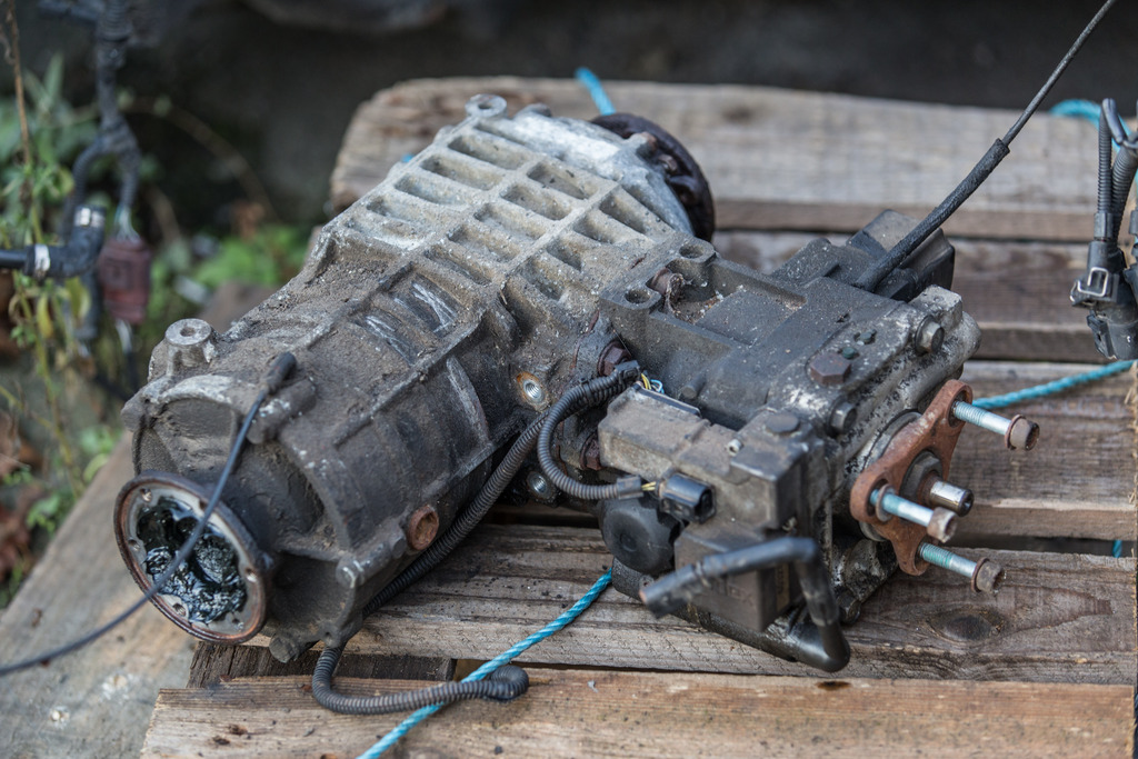

As its a nice day today and my lot have ******** off to the inlaws for boxing day lunch I decided I ought to have a look at the car to see if there was anything obviously broken at the back...
Got her up on my ramps and had a quick inspection... doughnut looks worn but not obviously damaged and I couldn't rotate the prop to be able to check all the way round (need to get her up on the 2 poster to check properly) so decided that I will just get a new one anyway as they are a known weak point and mine is looking a little tired..
Pulled the haldex fuse and tried slow lock to lock turns... the winding up/hopping of the rear had now stopped so points to the controller which at last is a start... then took her up the road to make sure the vibration had gone so I could at least be able to drive her to Bills...
This did not go very well... any speed over 15mph and the back felt like it was shaking to bits... disappointing...
So... at some point in the new year (and maybe before the end of it) I will just do a full drive train refurb... I had planned to do this but I didn't expect not to have the car immobile while I did it...
Ah well :)
