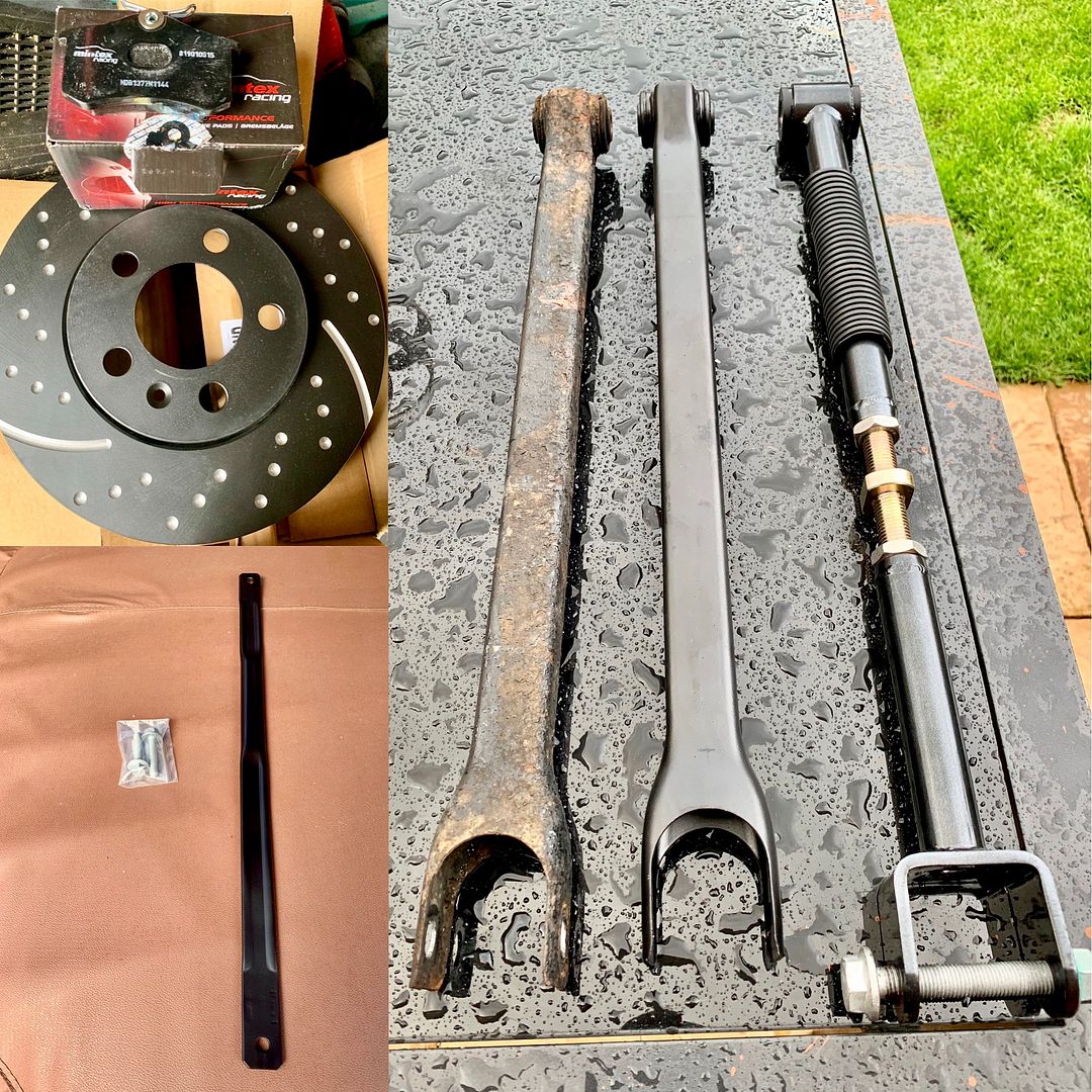

I have been away on holiday to Ibiza for a week and now (in between the showers) trying to get some work done on the car. The car did the 240 mile round trip for the airport perfectly at least and averaged 41mpg. Lifted the car up and started to take off the rear brakes and remove the tie arms ready to fit new OEM upper and Cookbot adjustable rears. New OEM bolts all around. Even though the car is on OEM 1 year old springs and shocks, it’s nice to give it some adjustment to get everything perfect. Also ready to change the 3 rose bushes still in the car for the later bonded bush. At least my rose joints were not seized though! Disks and pads ready to match the front setup too.
I also took the time before I went away to remove the “lower strut brace” on the car as it was looking very tried and resprayed it satin black, just need to put some foam back where it originally was. New OEM bolts too.

I managed in between the showers to get the o/s tie arms swapped over. Adjustable fitted to the bottom and a new OEM top. Rose bushes now swapped over on this side for the newer bonded bush version.
Also fitted my new disk and pads and did a quick spray over on the brake caliper to tidy it up. All new OEM bolts fitted for the brake carrier and tie arms. Just waiting on new lower shock bolts as I never replaced them last time I had them off.

So finished off the rear suspension work and replaced all bolts for new and ended up with a collection of old bits! Sent the car in for a alignment afterwards which made a great difference to the handling.
I then decided to paint the dog one mount as looking under the car, it was letting that area down, my subframe is pretty much rust free which is nice. Cleaned the corrosion off the mount and some Hamerite later, it looked better. Also refitted the painted lower strut brace from a few weeks ago back on. Used new bolts for the dogbone and lower strut brace of course. Both front wiper arms could do with a blow over of satin black so will try and get them whipped off this week and sorted. Only driven the car 400 miles this year so will have to start using it next year a bit more now I am pretty happy with it.
