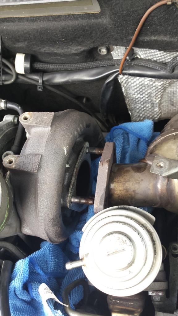

First I removed the engine cover and unbolted the 3 10mm bolts on the turbo heat shield
Then I removed the vacuum pipe from the top of the EGR as seen in the picture above (the round flying saucer type thing on the right)

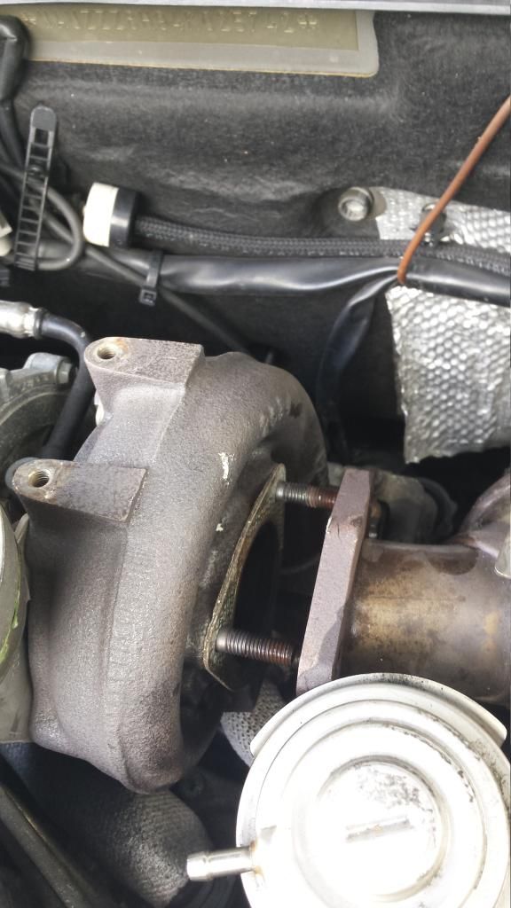

Spray WD40 onto the 3 nuts that attach the pre cat to the turbo (mine were already fairly free as I had the exhaust off last month)

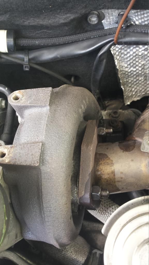

I then unbolted the 3 12mm nuts the attached the Pre Cat to the turbo (the one at the bottom is a pain and is very easy to drop as I found out, so be careful if you remove it!)
Once they are unbolted I got a large flat head screwdriver and just pried the pre cat pipe from the turbo like so...(had to be careful not to damage the gasket)

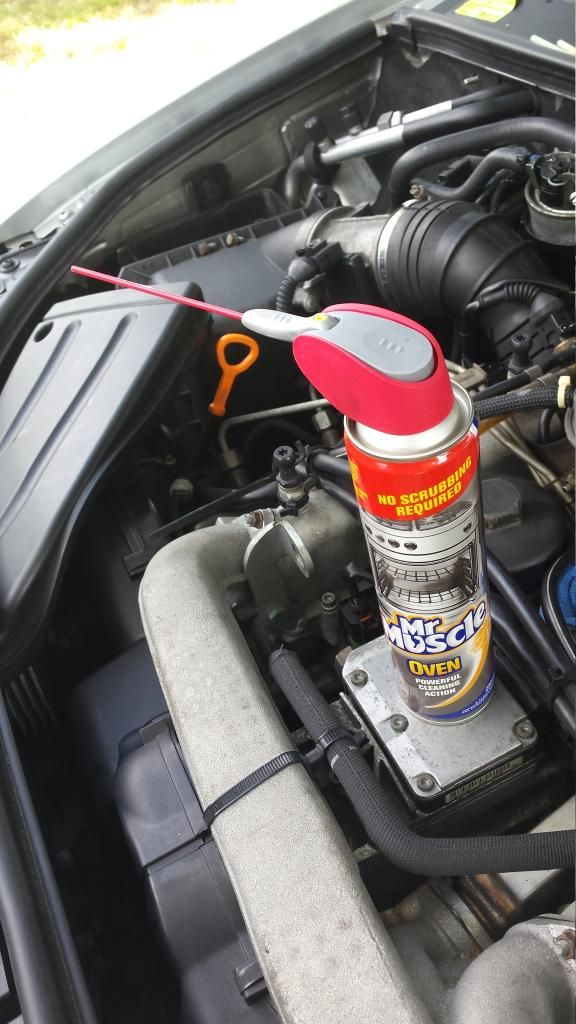

Now I put the top of the WD40 can onto the Mr Muscle can (it was a perfect fit)

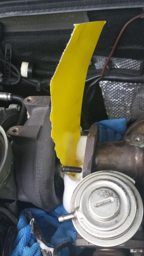

I then stuck the pipe which is now attached to the Mr Muscle can into the turbo and just sprayed the cleaner into the the turbo (you should be able to get the tubing quite far in to allow it to spray over the VNT mech)
I then put a bit of card over the hole to prevent it expanding out of the turbo even more

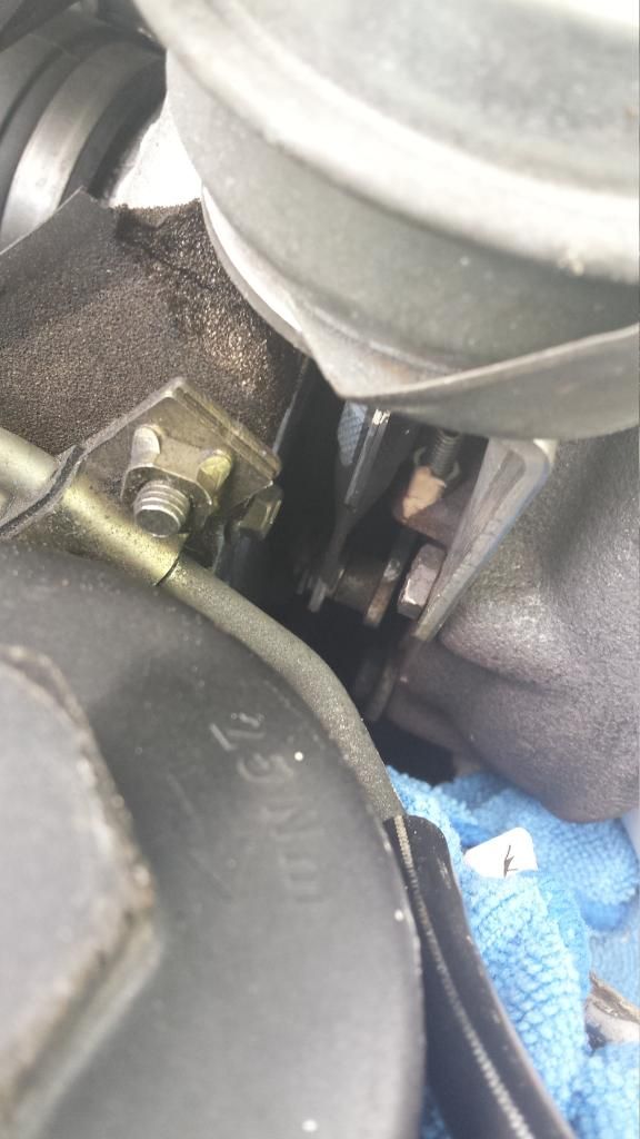

I then left it for as long as i could and moved the actuator up and down as much as I could, I did it every 15 mins or so over a 2 hour period(its the bar under the actuator, I again used a flat head screw driver to move it up and down until it started to free up)
