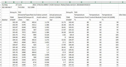

Logged into the gearbox and all looks good. Gearbox has covered just over 32.5K miles and has no errors showing. Had a few issues with faults regarding CAN bus issues because the gearbox is expecting to see a CANBUS gateway and the ABS module is not the same as the one in a 2012 TTS.
The CANBUS gateway error was resolved by ticking an option in the protocol emulation so it generates a packet with the relevant data in it.
Protocol emulation
The ABS CANBUS issue was resolved by running one of the BASIC settings on the gearbox group 69. The gearbox was expecting more information than my clonky old MK20 was giving it. This setting teaches the gearbox about the enviroment it's in and what is available to it.So the implausible can bus event no longer exists.
Group 69 basic settings
Also ticked Kickdown so ECU passes on the Kickdown signal when the accelerator is floored. I can see the steering wheel paddles in the measuring blocks on the gearbox.

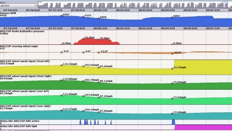

Did you ever get G195 G196 errors with abs fuse on from mk20 abs unit?
I have problem with DQ250 MTX gearbox from Golf R that I get those error and gear disengament if speed goes over 60km/h. Car is Audi S3 1999
I have tried to solve this and Im trying your tricks today that I read and hope it works and I dont have to change abs box to mk60
Does your car have ESP btw?
Mine dont and some say that is problem
Hi Tuomo just having the box connected to the car but not actually driving it anywhere I haven't seen any other errors. My TT is a 2002 and does have ESP . It may be that your issue is down to the fact that the gearbox is looking for a signal from the ESP to validate the speed sensor readings and it's not getting that. Possibly by doing the adaption on block 69 it may see that the information is not available so won't look for it. I didn't do a screenshot before I did the adaption only one after . But I am sure there were more 1's in the pattern before than after.
Take a screenshot of yours before and after if you can and then we can compare with what I have.
Karl
are you sure you have mk20? because I have not found mk20 with esp on 2002 models, only mk60.
I have now found mk20 esp models either, I am just asking to make sure you have mk20 box :)
Since it looks like I have to upgrade my mk20 to mk60 esp model for DSG to work proper. I have tried practically every other option and I still cannot drive over 60kmh without getting this G195 speed sensor error.
I will try do your adaption tomorrow but I am pretty sure it will fail as has all others too..
It is a MK20 ABS ECU this is the screen I copied when I playing with it the other day. The coding 16398 disables the ESP . It gets in the way on track.
My car has external brake pressure sensors mounted on the master cylinder and different lateral and longitudinal sensors to the MK60.
Upload 2021 2 5 20 57 6
Looking at the parts listing.On a 2001 car there are options for 4 different ABS modules dependent on whether a MK20 or MK60 is fitted and whether it's FWD or quattro.
I have looked into swapping a MK20 to MK60 just in case it's required and it's not that straightforward. The brake pipes are in different locations for a start so the physical installation is different.
Upload 2021 2 5 21 2 31
There are a few thread around where people have installed DSG boxes in older 1.8t cars. This one is a 2000 S3 in America
https://www.vwvortex.com/threads/1-...ith-photos-videos-and-racelogic-data.9353965/
Looking at the picture of the engine bay you can tell this car has a MK20 ABS system in as all the Hydraulic connections are on the one end .A MK60 has 2 connections on the top of the module by the pump. This car may have ESP though.
Upload 2021 2 5 21 41 57
Thanks for information! It looks like the ESP is the key to get DSG to work, I have that vwvortex topic and looks like all have ESP.
I dont have it on my ABS and for some reason it dont want to work over 60kmh with ABS fuse on. I try some recode things today but I have a feeling that I need to get ESP ABS box to get it to work
I didnt check TT part numbers so that is why I did not find it on S3 or mkiv golf but thanks again and sorry to spam your topic.

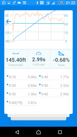

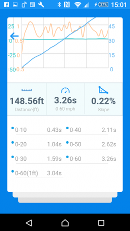

Tatting with the TT today, just tweaking the mapping a bit before I put the DSG in and playing with the HPA Haldex controller, trying out Race mode.
Hopefully with the DSG gearbox be in the low 3's .

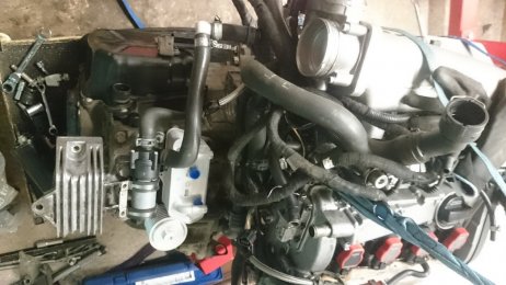

Bit of a faff changing it out and had to think a bit about how to swap the box with the engine on a crane as the DSG gearbox weighs 100Kg as compared to the stock 02m around 70Kg.

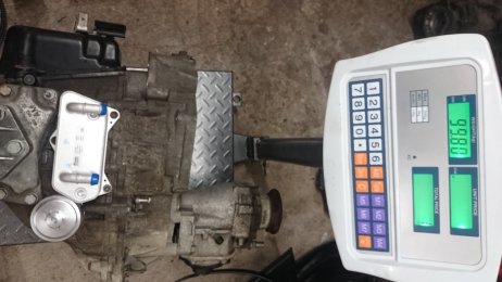

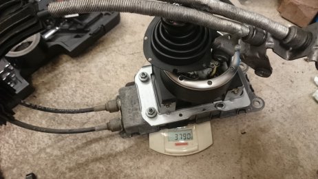

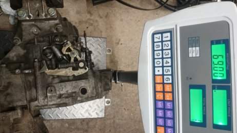

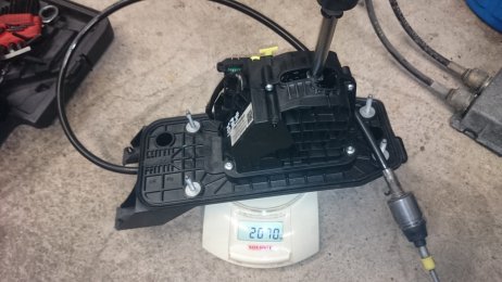

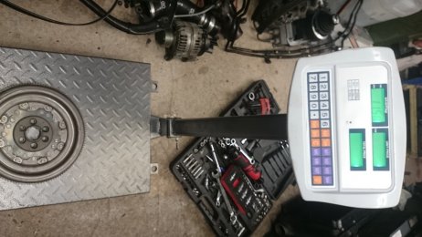

I weighed all the parts of the old gearbox and new one to try and get an idea of how much extra weight this would add.
02M with oil and including gearbox side mount 69Kg no flywheel or clutch
02m clutch pedal and piping 1.5kg
02E DSG gearbox including mount 99.8Kg no flywheel or clutch
DSG flywheel 11.5 Kg
02M flywheel 11.6Kg 02m clutch and pressure plate 4.8Kg
02m gear change selector 3.8Kg
DSG gear selector 2.1 Kg
02M total = 69 + 11.6 + 4.8 + 3.8 + 1.5 = 90.7
DSG = 99.8 + 11.5 + 2.1 = 113.4 22.7 Kg Heavier

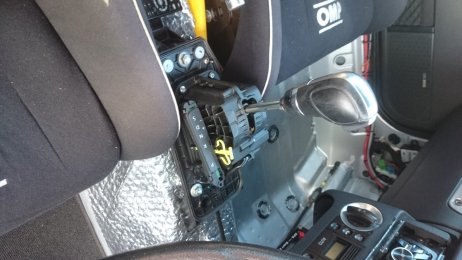

Mounting the gearchange I decided to fit the new one on top of the tunnel as it puts the gear change closer to the wheel but also means if it required changing out I wouldn't have to remove the exhaust and prop again. The cable used to activate the park mechanism also goes through the hole where the AC condensate drain was. I no longer have AC. This appears in the engine compartment at just the right place.
DSC 6290DSC 6264

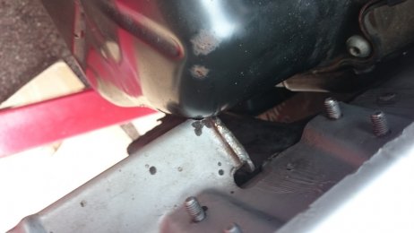

When swinging the engine in to the bay I noticed that there was very little clearance between the mechatronic and the point that the engine front cross brace mounts. Took an angle grinder to that and removed a piece as well as a piece of the cross brace. Now mounts with 2 bolts instead of 3.
DSC 6289
DSC 6291

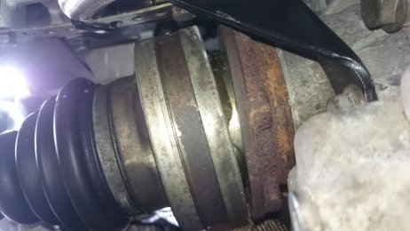

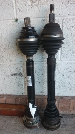

The existing driveshafts fit as they are but only because I have MK2 TTS ball joints on the car to increase camber and this increase the track of the car. The drivers side driveshaft has about 8-10mm articulation left with the driveshaft parallel to the ground, which is the minimum length. I will look into getting the TTS drivers side shaft shortened and fitted. However my shafts have nut fixings at the moment and the newer shafts are bolt fixings on the bub so I think this will require a new hub.
DSC 6293
I also moved the entire engine / gearbox towards the passenger side to maximise the potential movement for the driveshaft.This also helps with what appears to be a slightly different positioning of the rear transfer box output shaft.

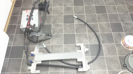

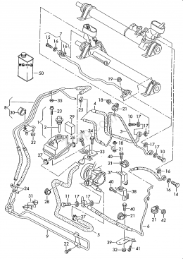

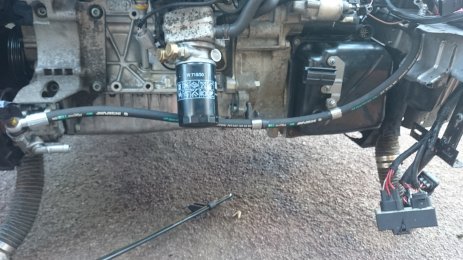

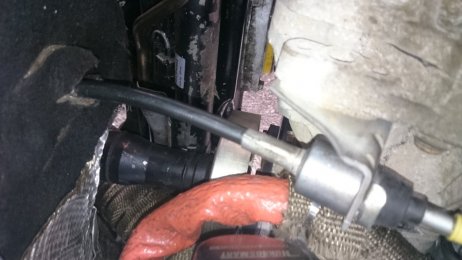

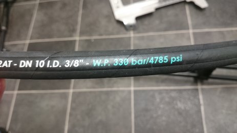

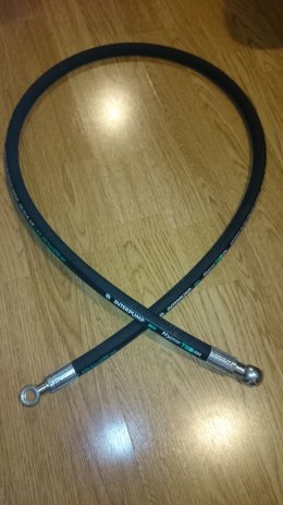

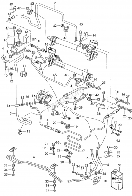

The power steering pipes have all been changed out using the high pressure hose I had made up and the V6 low pressure return with the Jaguar PAS cooler cut down and fitted between the FMIC and radiator.

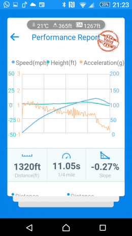

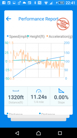

Taking a bit to get used to the new setup. The gearbox is on stock mapping so torque is limited to 380Nm although it will handle more than that as seen by all the cars driving around with stage 1, 2 maps on and stock gearbox maps.
I am running it a 1.4 Bar max boost so around 420Nm and still have the 6800 rpm stock gear change points. When the gearbox is remapped I will be able to run full 2 - 2.2 bar boost with 7800 RPM change points.
Stock mapping in Drive the gearbox does it's best to get you into 6th as quick as possible. Usually by 30-35mph you are in 6th. In Sport it's a completely different story it wants to keep you around 4K rpm and a slight prod of the accelerator has it changing down. Manual steering wheel paddles work in any mode to change gears .
A quick video I did the other day and a copy of some of the log from Ignitron which just covers the period in the video. You can see the car gets from 30 to 95mph in around 6.3s , I can't fathom how much quicker it will be when the gearbox is mapped.

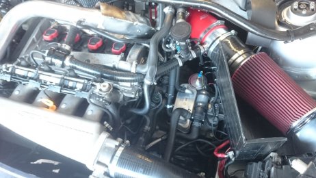

Don't think I put in any details of the V6 power steering mods. On the 225 it's ridiculously complicated compared to a V6 with the pipe routing and cooler pipes which are prone to rusting and are heavy. The OE high pressure pipe will not fit with the DSG as all the turns in front of the gearbox is where the Mechatronic is on the DSG. So got a high pressure pipe made up at a local hydraulic place. And bought the low pressure side stuff from Ebay. The PAS fluid bottle is the same and mounts the same.
Just the pipe routing is very much different. The V6 having a lot less piping and is a lot simpler.
18t PAS
32V6 PAS
The replacement hose, It was around £25 so not silly expensive.
DSC 6248
DSC 6186

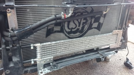

All the parts, The cooler is off Ebay, I think they are slightly damaged new stock coolers of S type jaguars. Nice and light and a good size with alloy brackets that are easily cut. Pipe size is the same as the OE TT items .
DSC 6181
Modified cooler fits between the rad and FMIC as I have no air con.
DSC 6299
DSC 6292
Small amount of whining from the power steering pump when the engine is upto temp. The factory high pressure hose has restrictors in and is modified to stop this whining noise caused by pressure pulses in the system. Only noticeable when stopped and manouvering at slow speed.
Reactions: S3AMJ, bobby singh and <tuffty/>

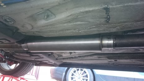

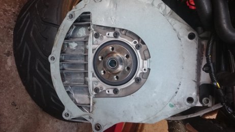

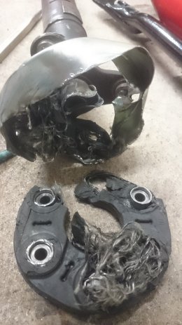

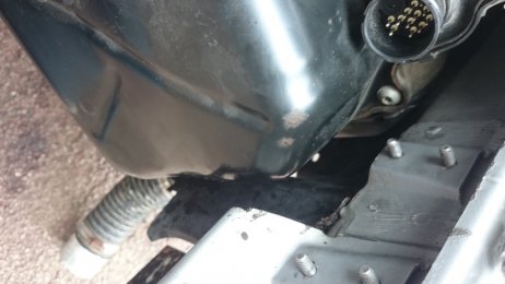

With the existing TT driveshaft only having about 5mm of movement it was working but I suspect that long term this would have been an issue and I was only getting that 5mm because I had mk2 TT bottom ball joints.
The inner joints on the 3.2V6 TT DSG box are tripodic so won't fit the CV type flanges on the TTS box. Found that on the MK5 Golf R32 DSG the later cars changed from Tripodic to CV type driveshafts. These are 15mm shorter than my TT driveshaft at 600mm rather than 615mm.
Result, bit more searching and found several part numbers all identical components used on different cars.
1K0407272CR 3C0407272BD 1K0407452TX 5Q0407272EQ 1K0407272JF 1K0407454MX 5Q0407272K
After a quick search on Ebay found a 5Q0407272K from a 2017 A3 2.0 TDI for the princely sum of £38 delivered. Just 3 years old so not a lot of use. I have nut type driveshafts on my TT so bought a second hand steering knuckle complete with the bolt fixing hub from a breaker for £25. Bearing turned out to be good which was a bonus, so painted up and was fitted the weekend. Now have 20mm play on the shaft which puts it right in middle of where it needs to be. There is roughly 40mm of movement on the inboard CV joint.
DSC 6350

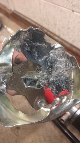

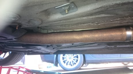

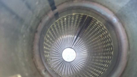

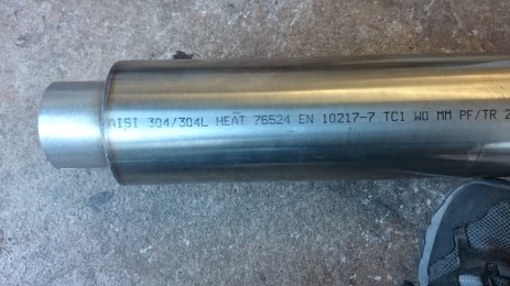

Also fitted a large centre silencer to reduce the exhaust noise a little. Trying to get it track friendly for all tracks across the country. It's also nicer to drive on a long trip.
Measured up a centre silencer and decided on a round 4.5 inch silencer 20 inches long. Pretty much as big as I could easily fit in the existing space in the middle. Didn't want to reduce the ground clearance by going to a 5 inch silencer.
Found just the perfect silencer on Fleabay, 304 stainless made in the UK. Looks good quality and only cost £60.
Weighs 3.8Kg, the length of exhaust I cut out was 1.8Kg so a net 2Kg gain. Did some before and after videos with a SPL meter.
measured levels at 1m 45 degrees to exhaust at idle, 3K and 5K.
Before After
Idle 79 77
3K RPM 85 80
5K RPM 91 87
Definitely quieter in the car with no loss of performance.

This is some of the log from the run above.Gear changes at 6800 which is the max RPM, on the stock tune. Will be changing faster and at 75-7600 next week with much higher boost so I expect very low 3s times.
8th mile log

Not updated this for a while has had a few issues but hopefully all is now good.
Had some issues with the car the day I took it to Awesome GTI to get a TVS stage 3 map on the box. Only got the car back around 4pm in the afternoon to test and make sure all was OK. On roads I didn't know managed to find one that had a very big drop in the road surface ,like there was underground subsidence. The car literally took off and flew landing very hard. The next time I accelerated hard there was a loud bang, lot's of noise and I quickly stopped the car.
From the parts I found on the road at the rear of the car I figured the haldex coupling had failed on the bevel box. This was a fairly new Meyle HD item, one of the mounting bolts on the prop had sheared. Recovered by the AA from Manchester.Needed a new coupling, second hand prop and unfortunately second hand transfer case as the output flange arm was bent and could not be straightened.

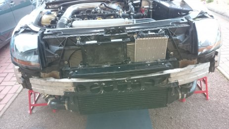

New location of the gearbox cooler in front of the rad, had to move the oil cooler and reposition the FMIC a bit, all now appears to be good.

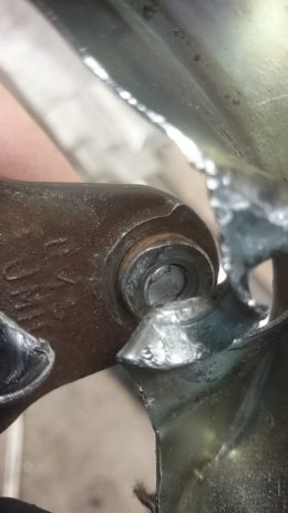

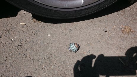

Just at the end of the second session the Passenger side driveshaft failed when the hub nut sheared off, lucky car didn't end up in the armco at the edge of the track as it pulled left quite quickly when braking around 90 mph. This happened right at the end of the track video, explains my slightly animated conversation with myself.
Brake pedal went long as well as the disc was running at an angle through the caliper so pushing the pads back. I suspect this is also related to the airborne flying episode. Both hubs have been replaced now with bolt types and I used the TTS passenger side driveshaft.
Ignitron ECU log when the Hub nut failed, You can see the steering correction made when the bolt failed around 90mph.
Hub nut failure log
When I jacked the car up and went to check for play in the wheel it was all over the place, I removed the plastic centre cap and the nut fell out on the floor attached to part of the driveshaft, think I had found the problem.
DSC 6429
Since then have revisited the gearbox mapping and ECU mapping, think I now have it running well at 2 bar if I want it.
The TVS stage 3 map certainly does what it's meant too, quicker changes and 18 bar clamp pressure on the clutch pack to give genuine 600Nm torque handling.
TVS remap 18 bar 600Nm

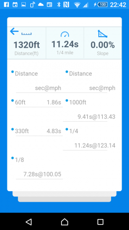

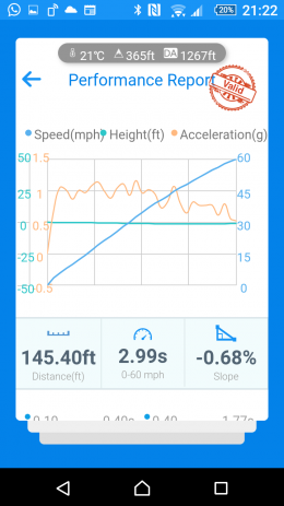

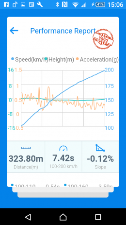

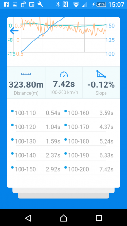

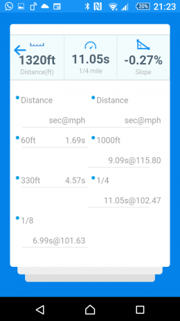

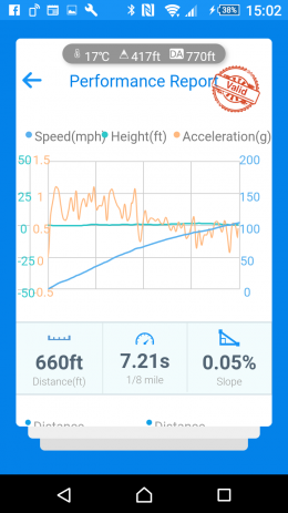

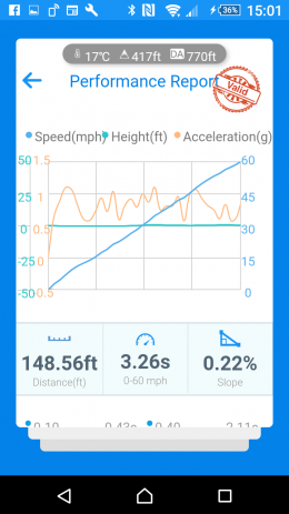

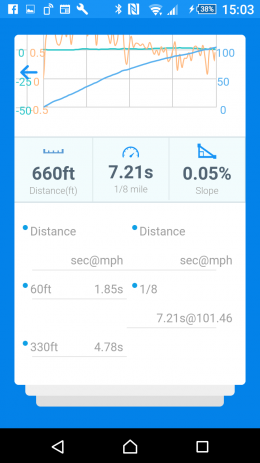

Did some runs with my Dragy and managed 3.26s 0-60 , 7.21 @101 mph 1/8 mile and an 11.24 @123 mph quarter mile. Also recorded a 7.42s 100-200Km/h . Tried a slightly more aggressive launch but just lit all 4 tyres up and had the car going sideways. There is a bit more in the mapping as the turbo will goto 2.2 bar in the midrange and there may be a very high 10 second 1/4 with a better launch on a more grippy surface .
Screenshot 2021 06 30 1124s quarter graph
Screenshot 2021 06 30 1124s quarter speeds
Screenshot 2021 07 01 326s 0 60 graph
Screenshot 2021 07 01 326s 0 60 speeds
Screenshot 2021 07 01 721s eighth speeds
Screenshot 2021 07 01 721s eigth graph
Screenshot 2021 07 01 7422 100 200 graph
Screenshot 2021 07 01 742s 100 200 speeds
For reference a 2016 991 GT3 Porsche doing 100-200Km/h on Dragy with a 7.66s
And a Ferrari 458 0-100Km/h in 3.73s, the TT does that in 3.36s and 100-200Km/h in 7.52s

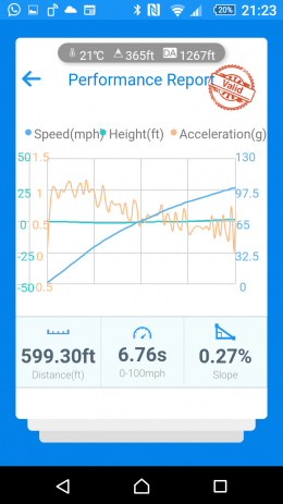

Many thanks to Balázs Farkas and the team behind Ignitron ECU . Spent some time playing with the boost by gear and Launch control maps to tweak the launch on the TT. Made so much easier by the fact that the whole process is really devoid of human input after the brake pedal is lifted. With the fantastic logging facilities you can look at ABS wheel speeds on launch and see whats going on. I have found by optimising the RPM and throttle position along with limiting the boost in 1st and seconds gears you can very much get the best launch possible with the available traction. The best launch seems to occur when the wheel slip is small and wheel speeds across all 4 wheels are within a few mph of each other.
Also upped the boost to 2.2 bar in the midrange it has improved the 0-100mph figure and a 10 second quarter should easily be done now. Unfortunately I lifted off early on my private test road and only managed an 11.05 quarter at 102mph. That would easily have been a 10.9 something around 124-25 mph.

Screenshot 2021 07 10 21 676s 0 100 graph

676s 0 100 log
