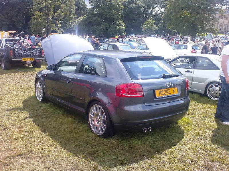

heres pics of mine when it was on H+R springs:

Got a pic of how it's sitting at the moment, in desperate need of lowering!
