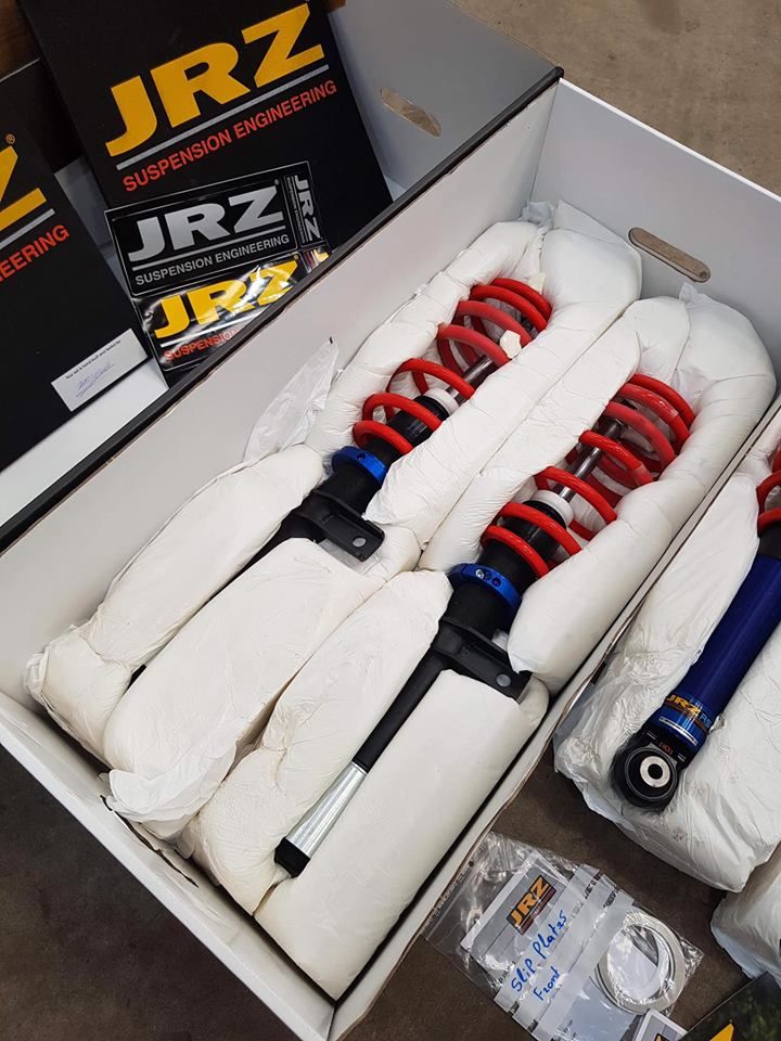

I was really happy with the original suspension but I felt it looked a bit high and was a bit crashy on my roads local to me. I ordered H&R lowering springs to try as cheap option and was a too low for my liking making it scrape here and there and also the handling for me took a backwards step so I looked into options.
I had a few years ago met Eric the lead engineer of JRZ Suspension on a business trip and got to go round a few tracks in JRZ cars with pro drivers and took part with a pit crew swapping out and installing on a car. I was blown away with the quality and technology so seemed like the natural step, so I spoke to Eric at JRZ and RS 2 Touring looked to be the ideal choice.. Daily sports feel and with few clicks event/track day ready.
The ride is OEM but better and more refined defo I think on bumpy roads its way better. Only slightly more cabin noise. Right now its set up as to JRZ specs on compression and rebound(5 clicks from full soft rebound & compression) I will have a play as feel needs a click or two harder..lets see
