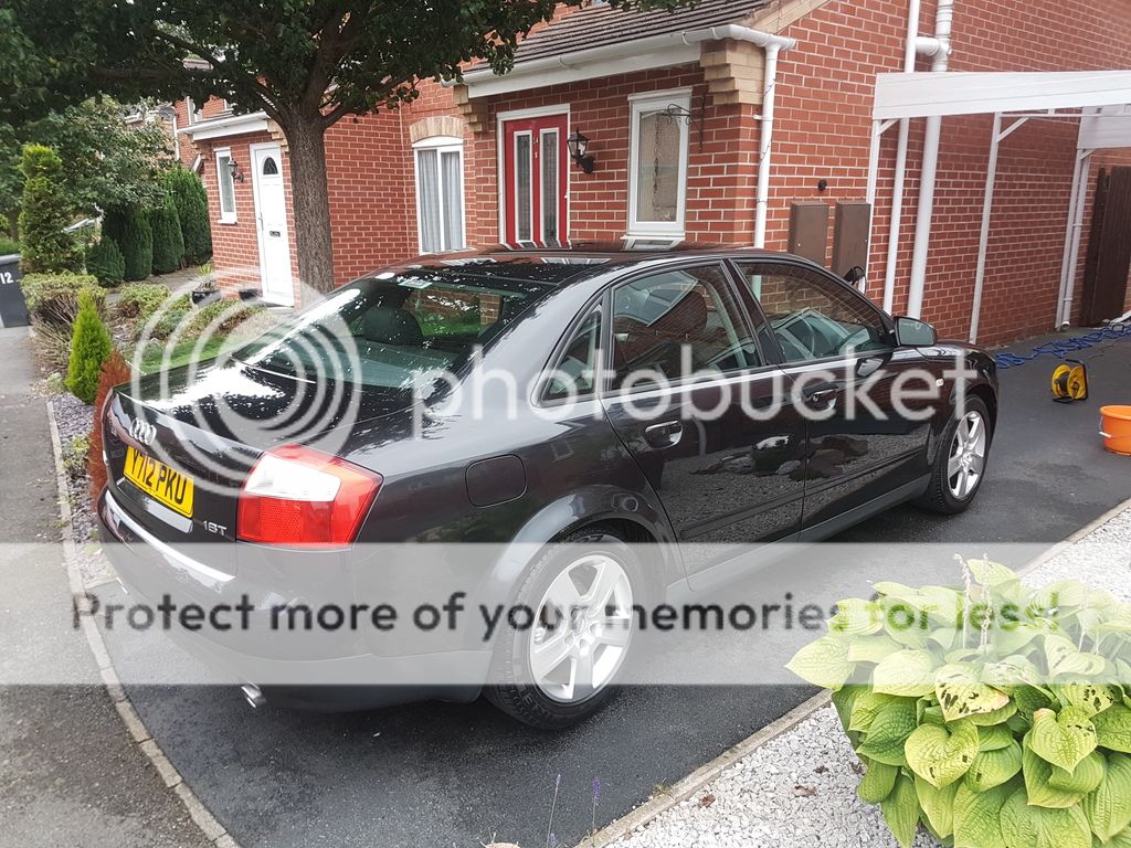

Hey, im Jim, I recently purchased an Audi A4 1.8t (b6), its a very blank canvas as its completely standard and was originally going to be scrapped due to a non start fault with the car, and the previous owner had lost interest. I managed to fix it within a day and diagnosed it as a faulty fuel pump relay (I'm a tech), so at the cost of £45 + scrap money its a bit of a bargain!
Here she is:
(after a full detail, clay bar, polish, wax etc)
