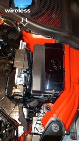

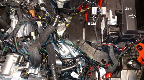

I also installed Jb4 but my goal is much more modest . I would like to use map 3 safely every day using 98 octane gasoline . After email exchange with George from Burger I understood that BMS is only needed if you want to use map higher than 3 . For this reason I uninstalled it . I had instability problems with app . Occasionally the phone would not display parameters retrieved via OBD or would remain fixed . Reading log results I found that target boost increment varies from pedal percentage . Reading log with map 0 shows that ECU intentionally drops boost between 3,200 and 3,800 rpm . Jb4 slightly reduces this difference but it still remains noticeable .
Making comparison between boost logged map 0 and boost logged map 3 I found an average real boost of 0.2 PSI .
However, I could not find a parameter on the Jb4 logs that indicates percentage ECU correction to contain detonation principles . Usually when fitting an add-on module it is the first parameter you check .
Question to those more experienced than me on Jb4 is it possible to check on the logs this parameter ?
FYI I installed it using double sided velcro so .
Avg Ign is shows timing being pulled due to detonation/fuel JB4 logs this you just need to select it to view.
I found out when initially logging that boost on lower maps may not be much more than stock levels but timing will be increased, giving you the extra power. Obviously depending on fuel octane you can increase both timing and boost to where the car feels comfortable.
I haven't had your connection issues but I have heard of the bluetooth module becoming faulty. Also check your bluetooth transmitter isn't being interfered with by some other electronics or metal around it.
Correct, between 3200-3800rpm boost and timing do drop and then it corrects upward, this would be the stock tune for everyone. You will be able to tune this out in map6 by adjusting boost targets at those rpms.
