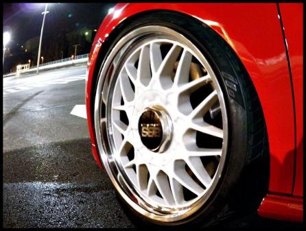

what do you think about these wheels on my car? 18x8 et38 front and 18x8,5 back.
thanks

Those wheels, S, ..YESSS!!! Go for it, Dude, ..you'll have lots of fun keeping them clean, but they look tremendous!!! Can't believe this is the first time I've seen your build thread, love your car and all you've done to it. Keep up the great work! Oh and love your arty pics too, well done!! :wub: xxx

well for some things i found inspiration in your thread...if i'll get these wheels gloss black pillars will have to wait :D
but i like them, and i think they would fill the arches nicely.

Yup, those rims would work. They look like they've been photochopped as the BBS cap is mahoosive! (unless its taken with a fish eye lens???)

think it's a fisheye lens.
like this one :D
(old pic but the link is not working anymore).
