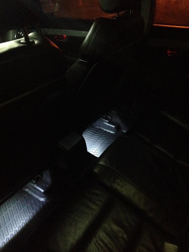

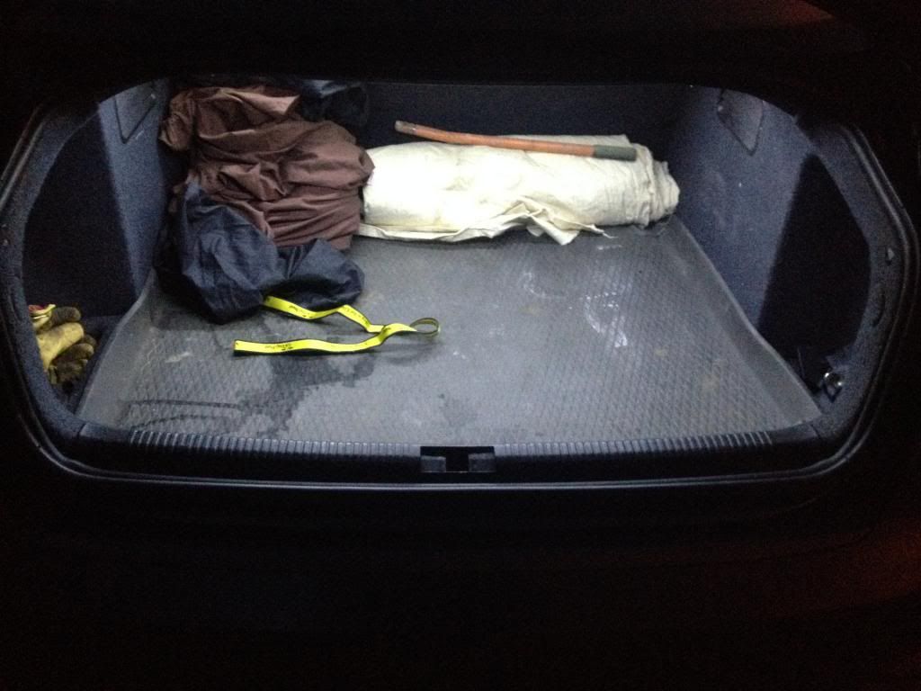

So thought I'd finally get round to fitting proper lighting in the boot. I had some of those sticky backed LED strips sitting in the garage so today was the day to finally get rid of the pathetic standard light. Great, easy and cheap mod that has made a massive difference.

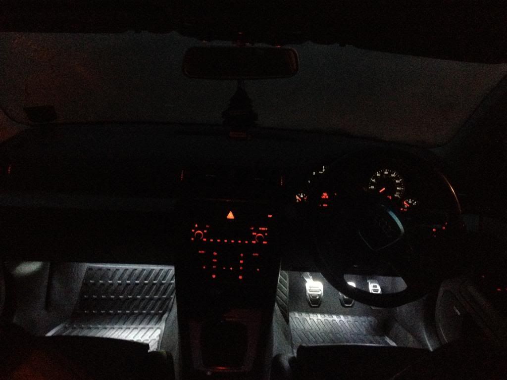

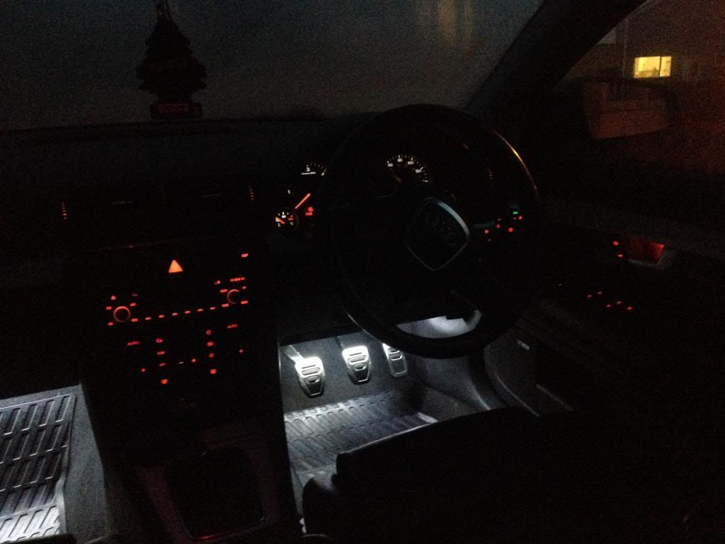

Then decided to remove the seats to give it a proper hoover out and clean but as I had some LED strips leftover I got thinking. 4hrs later this happened, A bit more involving and time consuming to get them to work with the doors but worth it. Also finished fitting red LEDs in the pass and rear door triggers, 6mths after doing the drivers door!! Appreciate it's prob not to everyones taste but I really like it.

Is that a leaking torso in the first pic? just as well you have a rubber mat, much easier to wash away any dna evidence!

Sure is, easier to clean up now I can see what I'm doing;-)
Looks good in my books :happy: did the same with my boot and does totally change it, allot more useful when putting things in at night too as there's less chance of blocking the light. Was it hard fitting the door triggers, tempted to copy haha.
Not really, dead easy tbh. I just drilled a hole behind the handle, inserted a single small LED and connected it to the illumination wires on the window switch. They were very bright to start with, tried sanding but still quite bright so dabbed some dolphin grey touch up paint on one side of the bulb until I was happy with them.
