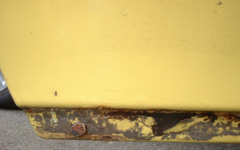

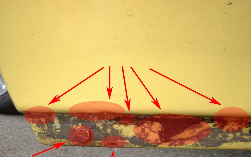

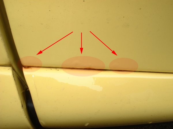

Following on from my original thread here, and VAGMAN1's Preventing rust forming along the bottom of the doors! here
Here is what I discovered to my horror when I actually removed the bump strips from the bottom of my drivers door:
As you can see quite clearly it is dirt gathering and causing the door to root upwards as I first thought, but as you can also see the paint has come off the door itself and the rust is spreading all along the bottom of the door.
Here is how it looked with the bump strip on:
It's the same all the way along mine now.
My advice is go and check your doors for rust and if you are lucky and don't have any rust forming read VAGMAN1's post on how to stop it in the short term. Otherwise get your self down to your nearest Audi Approved Body Shop and file that claim!!!
I think by the looks of it that is just a big problem waiting to happen to all A3's/S3's, and if Audi suddenly get a load of Anti Corrosion warranty claims I am sure they will have to react one way or another!!
Hope this helps you guys!
