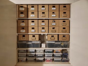

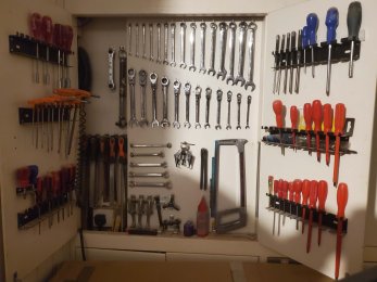

Tool storage is coming along, you'll soon be making boxes!!!
Tool storage Parts storage

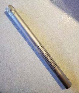

Now where shall I put this???
16 mm sparkplug socket
All ready for upcoming service
