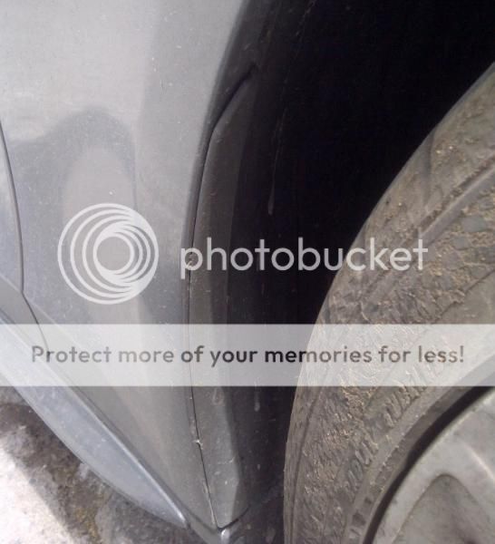

    Bit hard to see on the pic but I've just recently put the mudguards and the stoneguards on, fingers crossed that should keep the rust at bay. [​IMG]
    Sent from my moto e5 plus using Tapatalk
    DickoB8 and dimitar.tuntov.5 like this.
