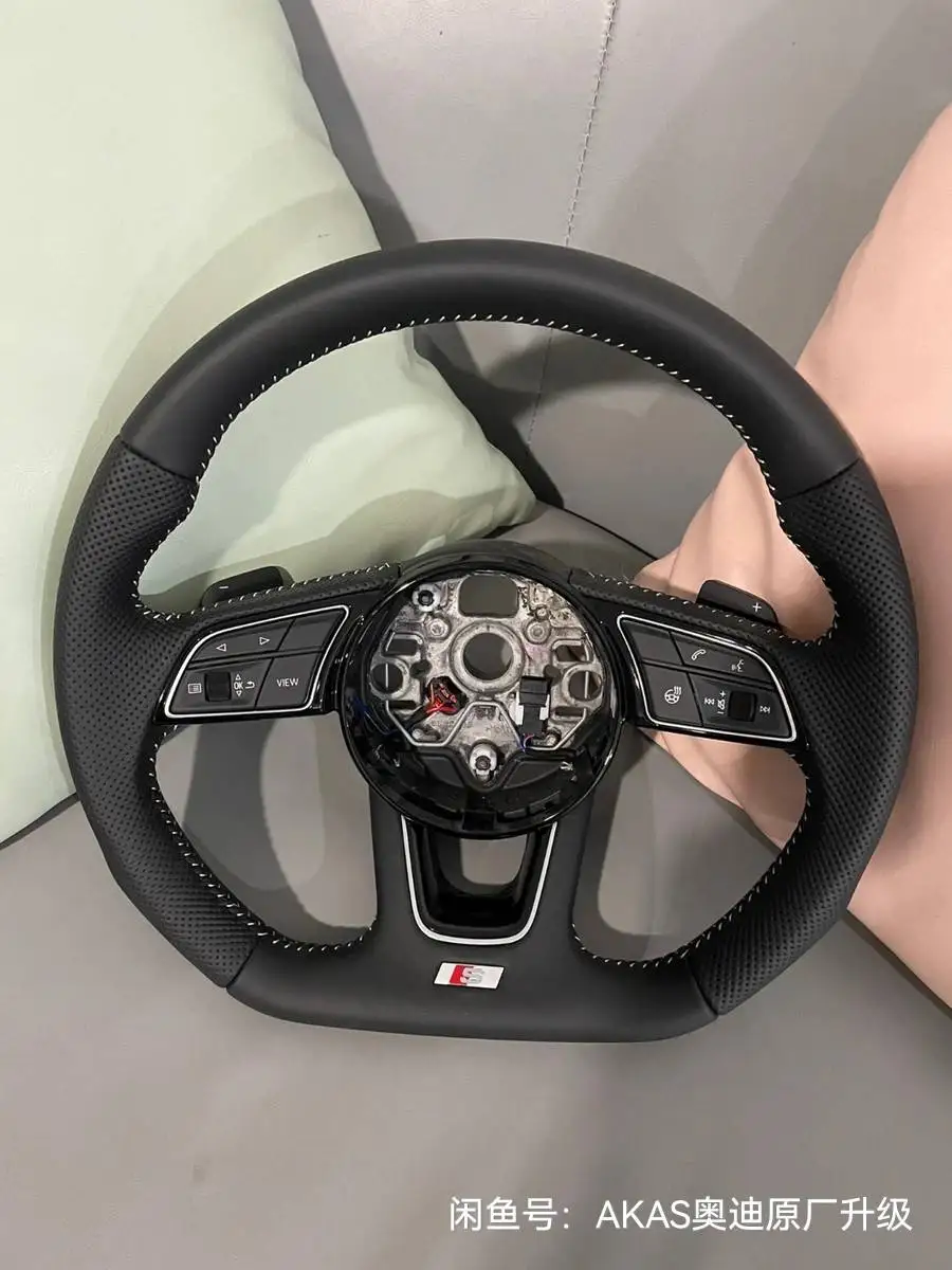

Hot off the press!
FPSUsername
B.Eng. EE
Nov 12, 2020
203
43
Now that is pretty cool!
Too bad that the configurable button is replaced for heating rather than having both available (I use it quite often to skip the current playing song).
I'm curious regarding the build quality of the wheel itself, I've seen some videos on youtube regarding steering wheels from China.
For me, this particular model is of no use. No S-Line badging (as my current flat bottom PFL steering wheel does have), no perforated leather (don't know if that's possible with the heated function) and it's for an automatic, I have a manual, but I bet that there are more variants available.
In case Audi did produce this exact model, it might be worth checking it out on ETKA and find the exact part number, then cross check on eBay to find real OEM units.
Keep in mind, airbags are expensive to replace, thus for a PFL to FL conversion, the total costs will be around 1k+ euro :/

I was just gearing up to try and get a heated flat bottom perforated wheel mod as it seems to be the holy grail and I am not as gifted as the guy who did the amazing job with a Q7 donor wheel a couple of years back.
I bought an 8Y A3 Sportback tfsie and have been steadily trying to create an S3 lookalike with Vorsprung spec as it came with sun roof, matrix lights which was a good head start - Hoping to fit a power tailgate in a couple of days so will post my findings.
I know you can't post airbags so I was hoping that this wheel supplier could do a perforated version - there are a couple of other sellers offering carbon and other options on ALi Express is it not as simple as the wiring and airbag simply swapped over??

Sounds like a nice project for your 8Y. I'm also looking to max out my A3, but parts are really expensive and I don't feel like buying retrofit kits. Current plan is to add heated seats (it's just that the seat elements are so expensive).
I think for steering wheel swaps it's just plug and play. For heated wheel retrofit, I think you need to pull a wire from the fuse box and repin a connector. Don't quote me on this though.

On the steering wheel I have an update - late last night I got in contact with the seller using the message function on ALi Express and I have ordered this
I know you said you would miss the favourite button but I have been through what is required basically running a 12v supply from the fuse box and purchasing a new clock ring with a heating element. Fingers crossed!!!!

the lumbar support is odd because it is electric and all it does is demonstrate that theyve cut corners and not put seat adjustment in. How have we ever lived without neck fans!!.
Ah well, lumbar support is good enough in the sport seats I have. Neck fans? To me it sounds like a recipe for neck pain. I'd rather have the cooled seats (which is basially a set of fans blowing on the foam) for the summer, but since I have half leather, it's not a big deal.
Regarding the wheel, that's amazing mate. For the thread's sake, list the part numbers needed (at least for the clockspring). I think I could figure it out with ETKA, but without a complete sticker sheet of the 8V with the heated wheel, it's a bit more difficult to find it, as you have to check every part number and see if it has the correct PR listed.

Hello there - I am trying to be one of the first people to retro fit a heated wheel to an 8Y A3 - I have the wheel which is a flat bottomed S line which has had the favourite button converted to become the heated wheel button. I am really struggling to find an electrician or coder to touch this job as it is all so new. I can't even make much progress in tracking down the righ clock spring. Do you have any advice for me or shall I open up a new thread to see if there is anyone out there?
