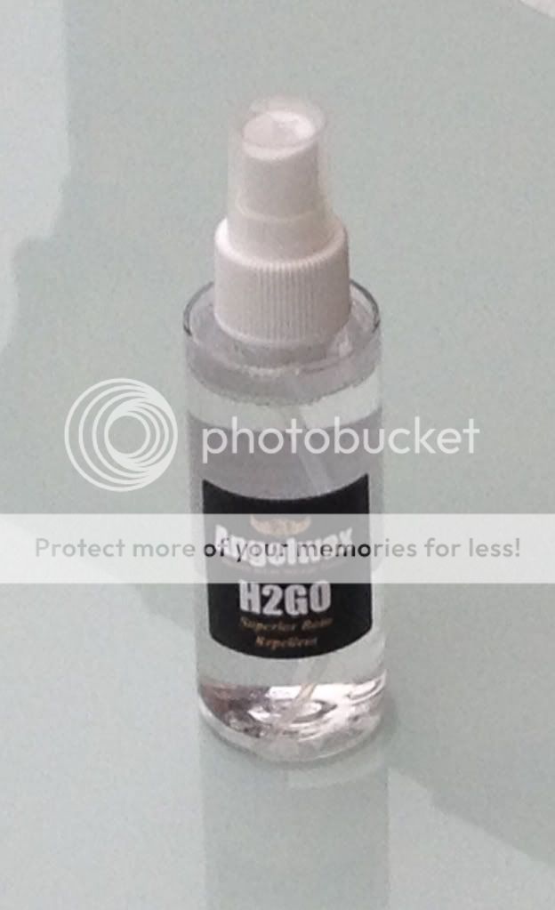

I've tried a few exterior glass coatings, including the Gtechniq G1/G2 combo (which I found was not only expensive but can be a bit fussy to apply correctly)
My fave is Angelwax H2Go
http://angelwax.co.uk/product/h2go-the-ultimate-rain-repellent/
Not only is it tremendous VFM but it is a doddle to apply. I've applied it in the summer months & winter months down to around 1-2 degrees C without any probs
On the windscreen I always use 2 coats, around 20 mins apart. This will give me up to 6 months durability on the windscreen and longer with one coat on windows without wipers

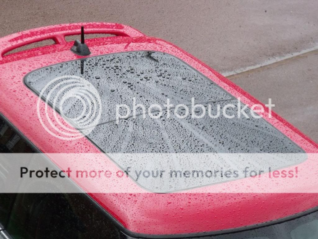

My wife's old MINI JCW had a pano roof which I coated with this withnot any probs
For £5.95 for a 100ml bottle, why would you buy anything else ?

I've been using AW H2GO for a couple of years now, great value for money product.

That looks awesome BH :friends:
My glass has Nanolex Ultra sealant on it at the mo and it beads like crazy like no need for wipers crazy. It was detailer applied though so can't comment on the application and it doesn't look the cheapest. A positive is that there's no wiper noise or skip. I did clock my pano roof at the w/e and it was similar to your JCW photo but didn't take a pic in case I dropped my phone on it LoL !!

Looks like good stuff. The beading is very impressive.

Just looked up the price. 250ml for £12 is very good value for money.
