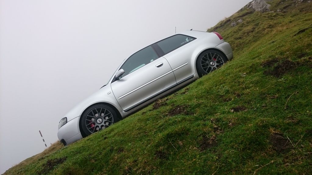

That's mine sat on H&R Springs with Koni STR-R Shocks.
It definitely settled lower than the quoted 25mm.
Been running it for well over 2 years. Reason why I went for it was I wanted a comfortable set up (daily car back then) whilst giving me better handling and looks.
Got to admit it feels very OEM and perfectly fine over normal speed bumps.
Can be abit harsh over some pot holes and uneven roads but generally is fine.
Its a great set up for the cost.
Since fitting I have however uprated the ARB's to R32 ones with Super Pro Bushes and also refurbished the wishbones along with front and rear Super Pro Bushes. Both modifications definitely made a better improvement in terms handling and stiffening.
The car is now a weekend blast every now and then so tbh Ive been thinking about switching to Coilovers. Most likely KW V2's.
Hoping to drop rear end this winter for a overhaul so going to replace rear swing arm bushes which after 16 years will more than likely have plenty of play in them.
Sent from my F5121 using Tapatalk
