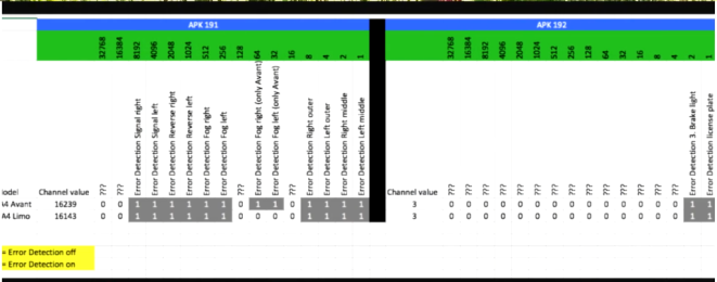

I then took my bulbs out to see what adaption channels were changing.
Adaption 10 > Channel 181 >Read
Take note of the value you get, then convert that to decimal.
When I converted mine to decimal it comes out to 1111111111111111. Bits 8,9,10,11 code for the reverse lights (1111RLRL11111111) so when I converted them it becomes 1111000011111111. Convert that back to binary, enter the new number, test then save. All done.
ONLY The reverse light check are now disabled (all other bulbs are still checked).

Module 46 Central Convenience > Security Access 16 > 16017 (You need to use this access code, NOT the one VCDS gives you - this was my first hold up).
You sir are a legend! Thank you!
Original value for me was 65535. I set it to 61695 which is the decimal equivalent to the binary with the reverse bulb check disabled.
