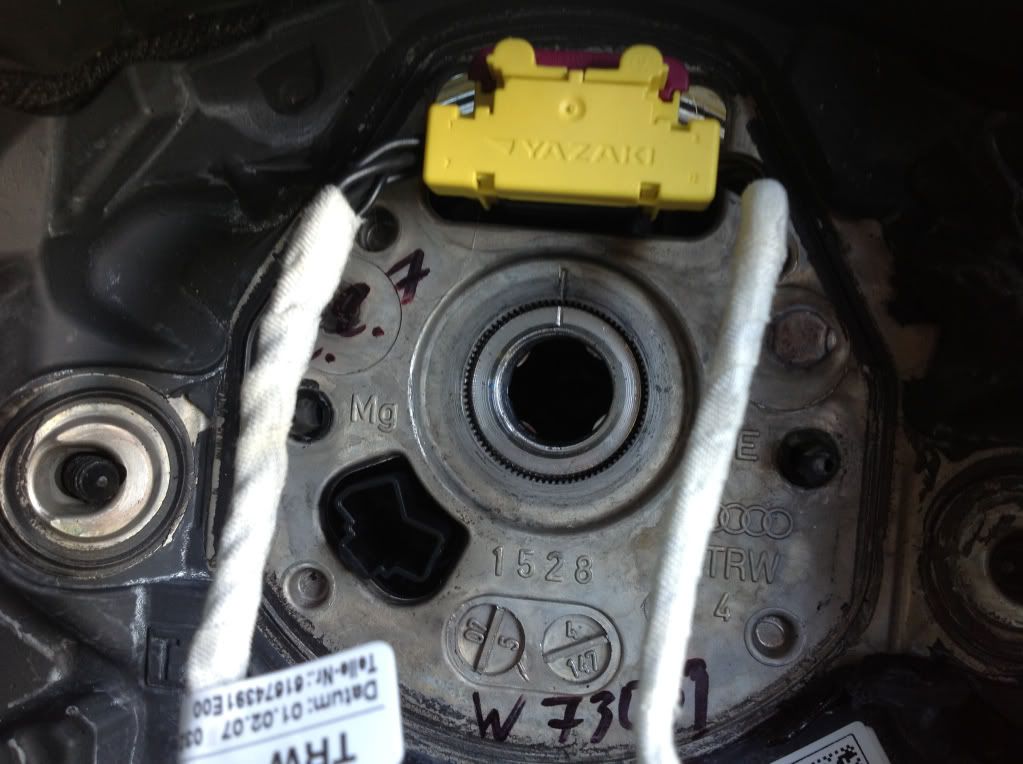

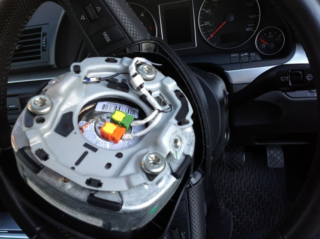

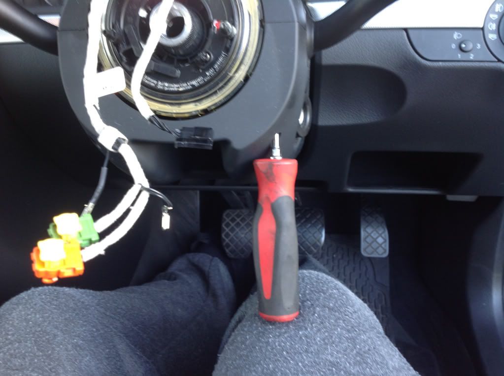

    disconnect the battery then

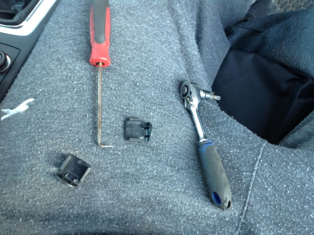

    put steering wheel to these positions and remove the 2 grommets at the back reviling 2 torx screws undo them and it removes the air bag
    [​IMG]
    [​IMG]
    [​IMG]

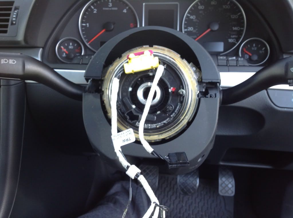

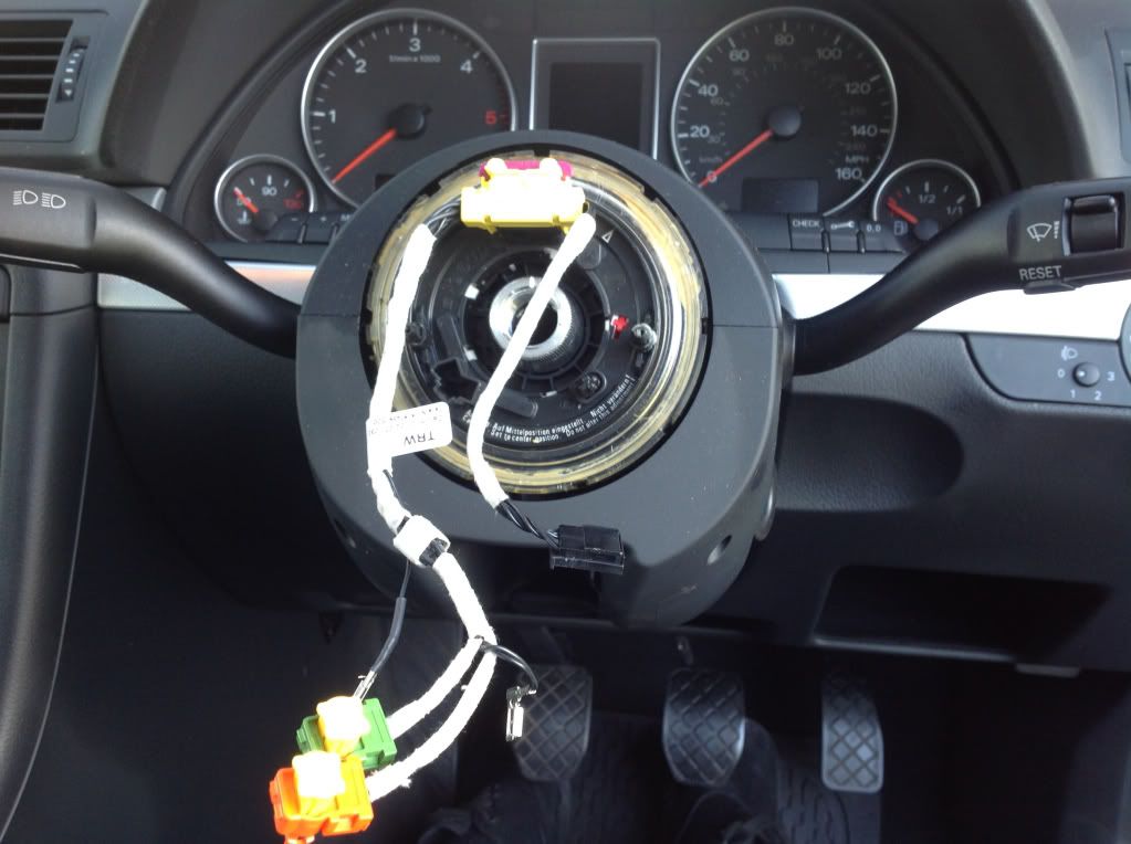

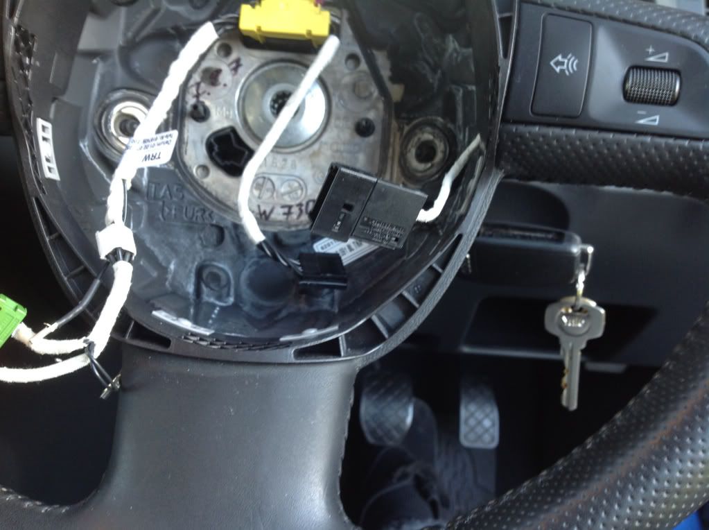

    Unclip wires from the back
    [​IMG]
    [​IMG]
    [​IMG]

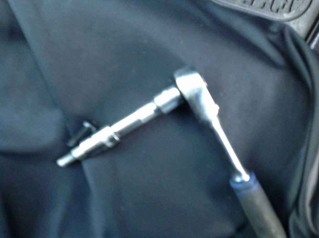

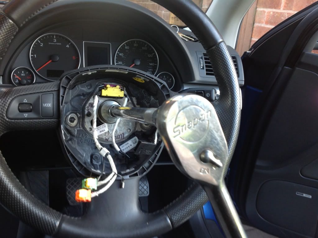

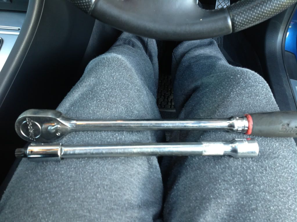

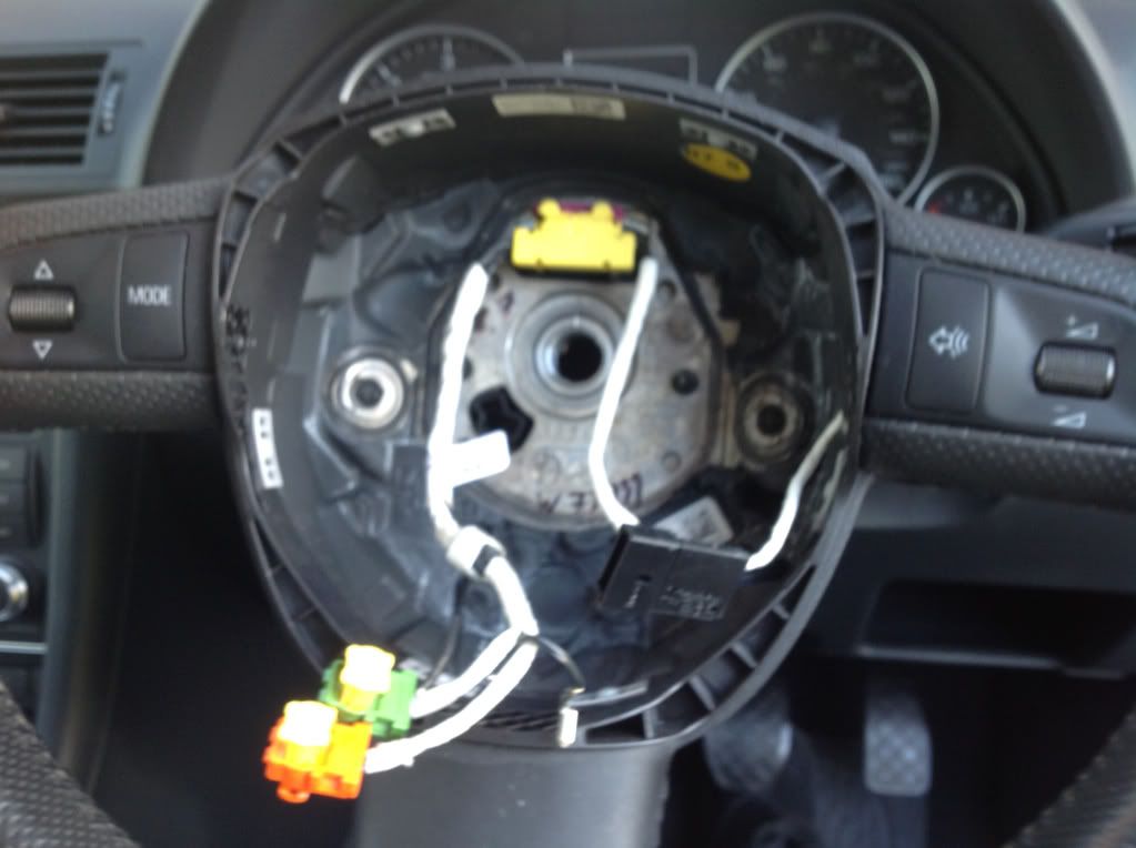

    Undo the steering bolt that holds the wheel on make sure the steering wheel is straight and take the keys out of the ignition to lock the steering. The steering will be marked as can see from picture so just in case you forget where it goes
    [​IMG]
    [​IMG]
    [​IMG]
    [​IMG]
    [​IMG]

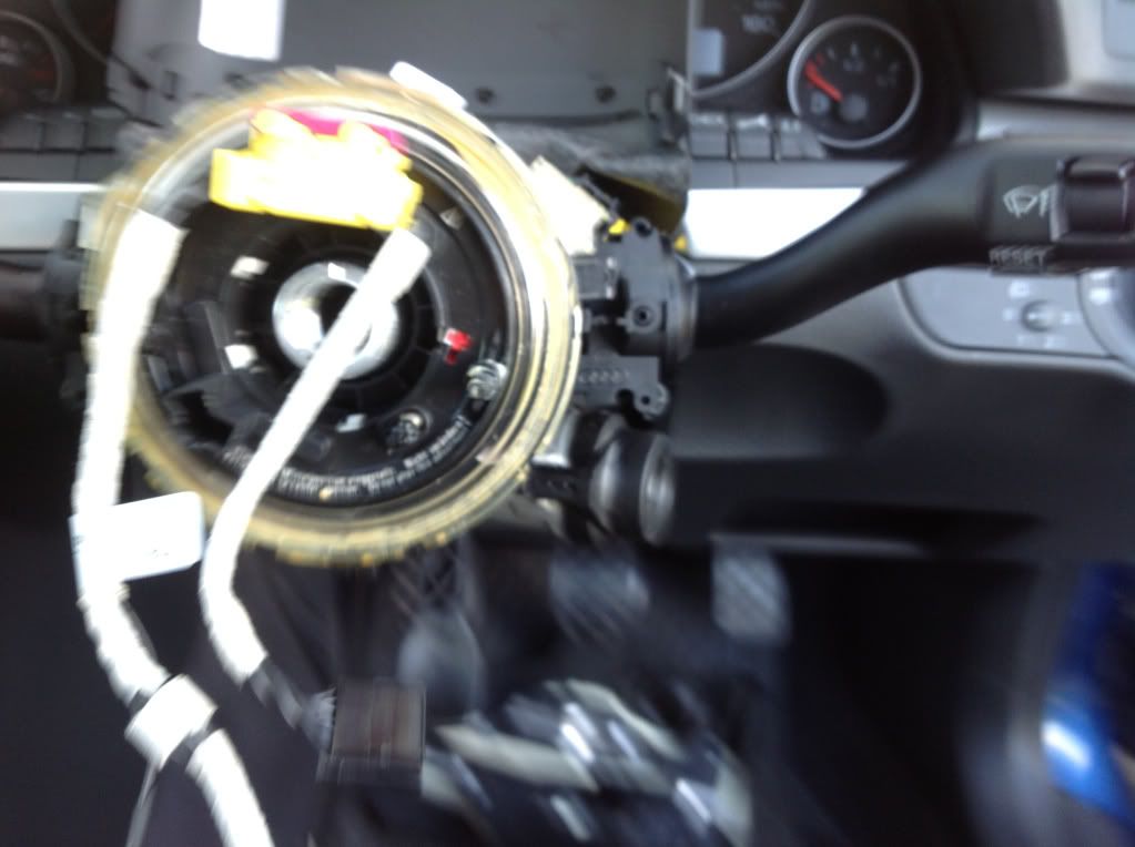

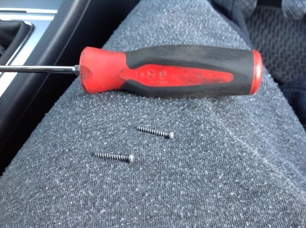

    Then you need undo two torx screws holding the cowling on then the two Allen screws too
    [​IMG]
    [​IMG]
    [​IMG]
    [​IMG]
    [​IMG]
    [​IMG]

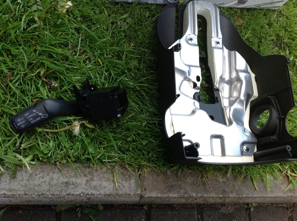

    then remove the cowling
    [​IMG]
    [​IMG]

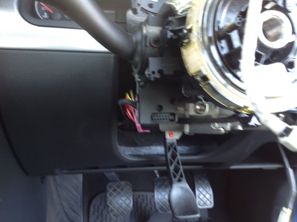

    This is where it locates
    [​IMG]
    [​IMG]

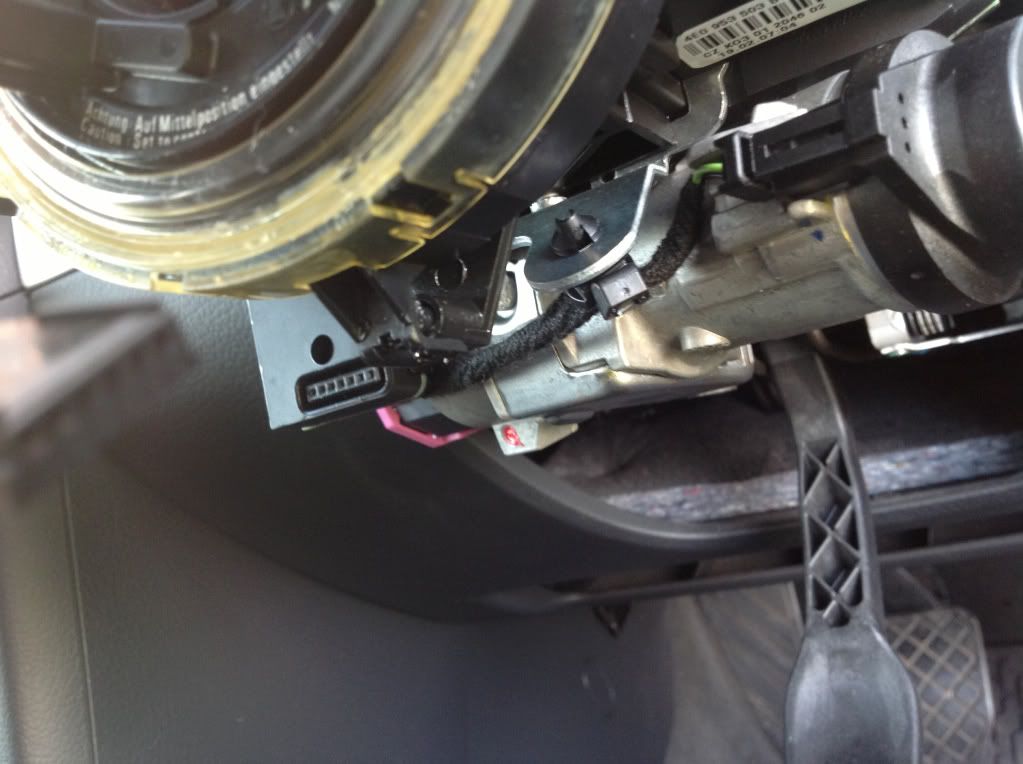

    Unclip the plug and the 3 clips then the squib comes forward be careful not to move this keep it how it it
    [​IMG]
    [​IMG]
    [​IMG]

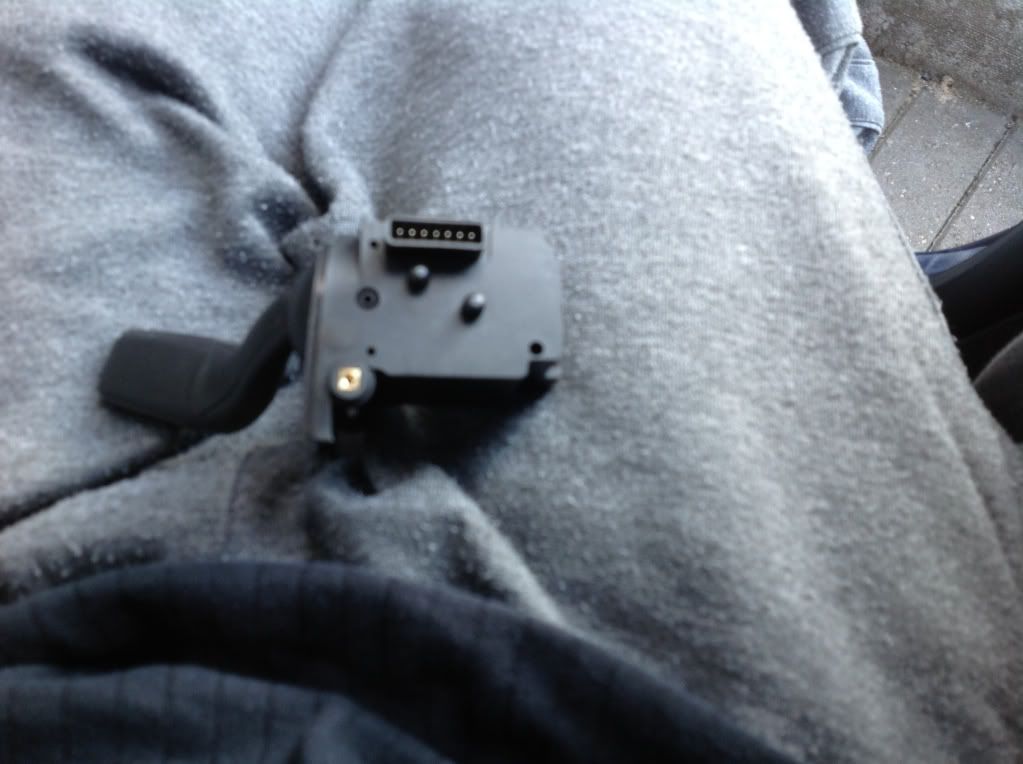

    Then pull the stalk forwards and clip in the cruise control switch then clip it back on the colume

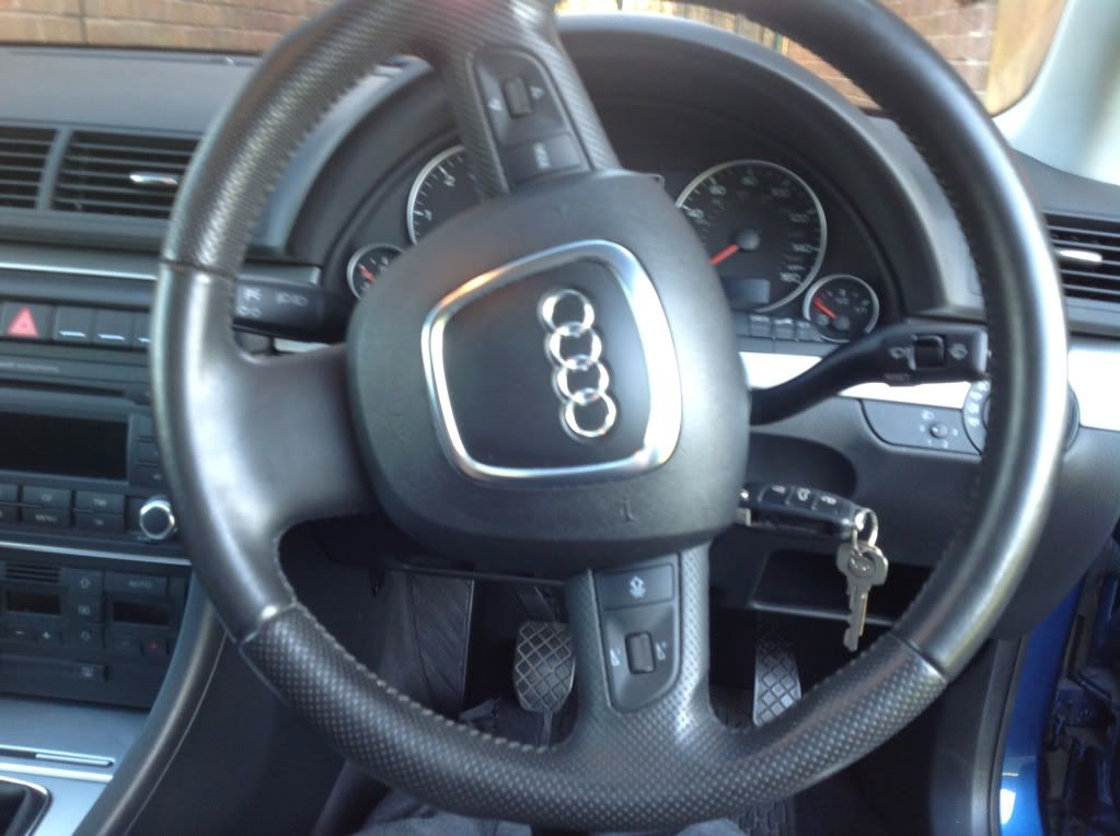

    Then redo the process and build it back up
    [​IMG]
    [​IMG]
    [​IMG]
    [​IMG]
    [​IMG]
    There we go cruise fitted
    [​IMG]

    Well done mate. Never seen anyone do it by leaving the airbag loom plugged into the slipring but either way, good job ;)

    When removing the airbag I just unclipped the purple/yellow connector and left the airbag connected to the steering wheel. Hope there's no reason I shouldn't have done that!
    I struggled to unclip the connector on the slip ring so ended up removing the driver's footwell trim to get at it from behind.
