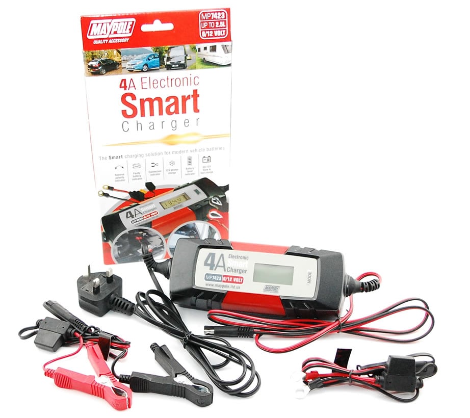

    C-Tek , you could have two..
    [​IMG]
    £22.74

    Buy cheap buy twice

    Not in this case , you can't apply that old chestnut to everything .
    And he owns C-Tek's .

    To be fair these actually look ok for what they offer and the price point is amazing.

    @Gazwould Thanks for the recommendation, got it for £22.49 of prime. Great price.
