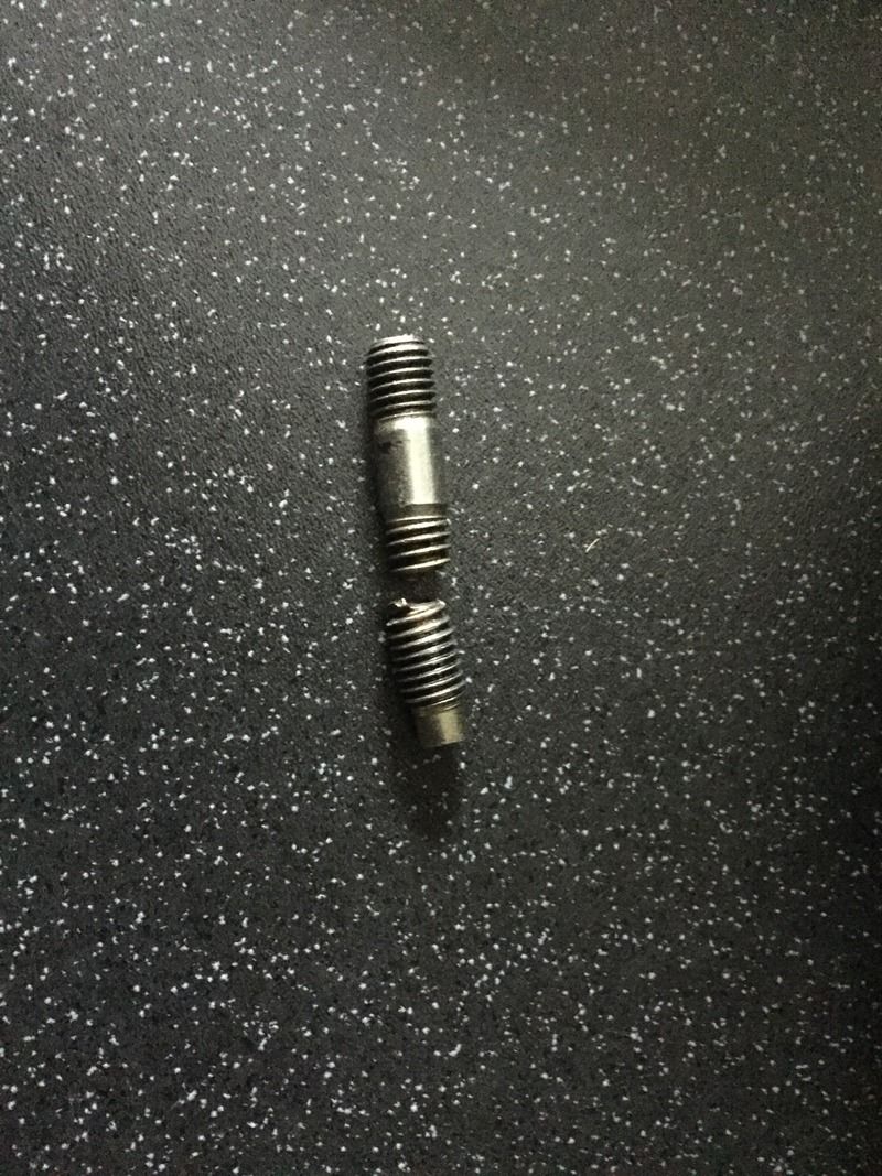

Well had a day off yesterday so set about changing the belts, water pump, oil, coolant and filters. Those were all fine. I replaced the rocker cover gasket and when tightening the top bolt while I was chatting I snapped the stud. I was thankfully able to get the stud out the bolt and the engine. So anyone know where is best to get studs like this?
I rang Peugeot but they are all out and won't get any more. I posted on the 106 forum but I never find it that forthcoming with information.
Is this the tu5jp4 engine?the 8v rally's?if so it should be exactly the same as as any tu engine from 1.1 to 1.6 might be aswel to find a breaker

what thread size is it? They look like pretty standard manifold studs.
