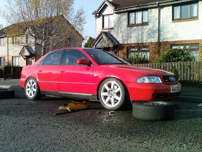

Just a little update.
Not really done much to the car and rarely moves more than 50 miles a week nowadays.
Got it mot'd, taxed and service last month.
Passed the mot fine, the tester asked if the car is kept in a garage since is pretty clean which was nice.
Last weekend I gave it a wash and fitted the other set of wheels I have. I will use them over the summer and then decide how I like them. I need 10mm spacers for the rear though as my 15mm ones made the wheels sit out just a tad too much.
I may eventually get the centres done anthracite or sell them as I think dark wheel suit the red paint work.
Anyway here are a couple of crappy phone pics I took. I will take better ones at a later date.
I hate taking pics of my car when people are about, its so embarrassing!!

Looking nice mate, i think the wheels look ok nice but ok. Not as good as the others but there for best so its worth saving them.

Yeah I think the wheels are growing on me. I think I like them more every time I see the car.
Things normally look better in real life but in a week or so I will try and take some better pics.
