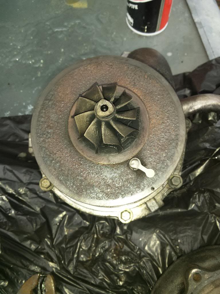

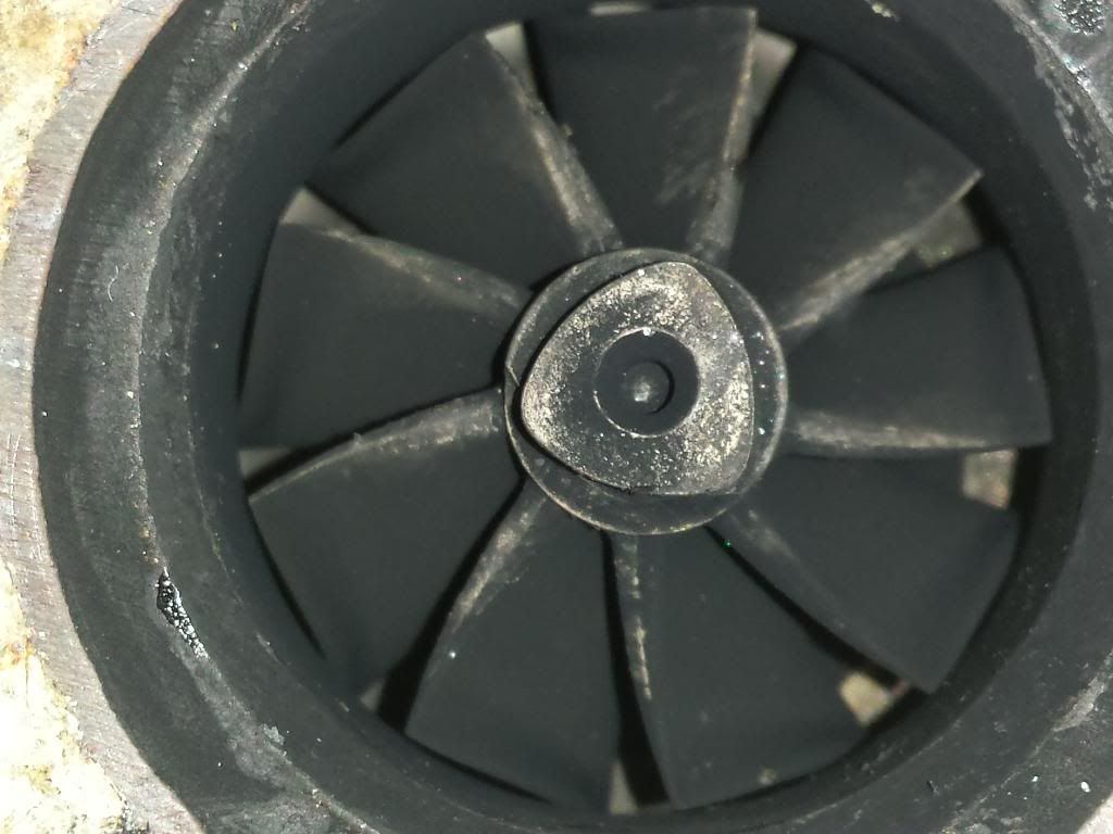

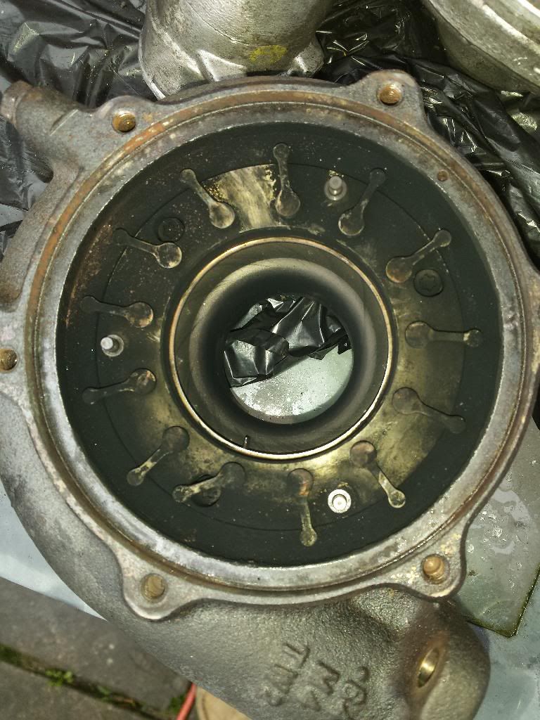

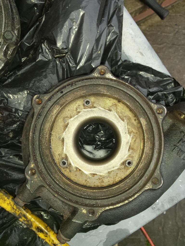

So finally removed the turbo today and gave it a clean. It wasn't too grubby to fair!
Intake fins, good condition, no nicks etc.
Good fins, but sooty only lightly
Bit sooty but not bad, arm is free moving.
Grubby vanes but not too bad.
Dirty ring and little wheels.
Ring and vanes cleaned up.
Soot removed and the arm for the VNT mech is now clean.
Compressor housing all cleaned.
Vanes back in.
