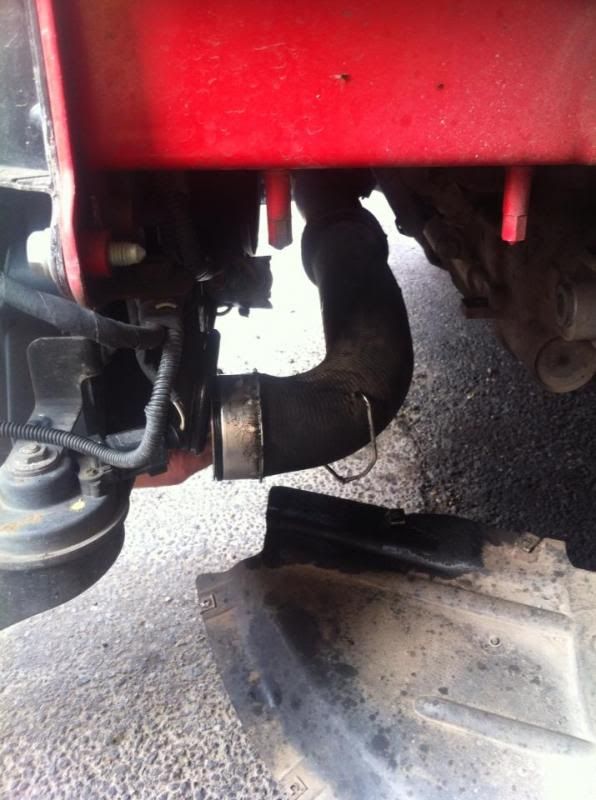

Defiantly sounds like a boost leak. Mine did the same as I bought it with a front end smash got it all back together and when I first drove it got white smoke and when you put your foot down could hear wooshing sound and then car would hesitate.turn out to be intercooler hose with the sender in it had come dislodged from the hose and letting air in.
Breezey
Mar 10, 2010
534
Agreed sounds llike a boost leak to me too, i had the exact same symptoms probably about a month ago, wooshing noise, loss of power, more smoke etc turned out one of the aluminium collars had snapped on the right and side of the intercooler (as your looking at the car so NS). New pipe all fixed, worth getting under and checking all your pipes if you can, these are the easiest and can be seen just poking your head under assuming you have no under tray.
thats sounds promising mate, it's what i thought but wanted to be sure! appreciated.
Joee
Apr 8, 2013
19
Cheers mate, yeah got a tray so need it up really to be checked. thanks for the pics!

Breezey or Joee where did you bye a new pipe from and how much was it please. Was their any reason why it kept popping off?
andy1010
Jun 17, 2012
30
I got the same pipe from audi and it was between £40-£50 the bit that holds them in wear, if you order one you will need a new clip to hold it on other wise it will just keep popping off again
They pop off because the wear stupid fitting really
Miked6405
Sep 28, 2013
51
So I'm better off just securing the old one that's on it then? It feels loose at the top
andy1010
Jun 17, 2012
30
Take the pipe off and have a look at the intercooler and make sure nothing in there is broken, the intercooler is plastic where that pipe goes in to
Miked6405
Sep 28, 2013
51
Just had a look the intercooler is fine, it's just the pipe the top lug has worn down so gonna c if a tac weld will do if not it's a new pipe. Cheers everyone for you help
