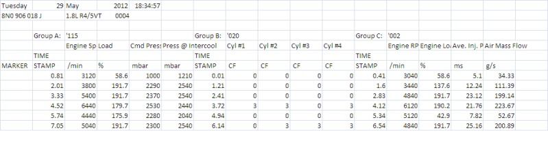

My car for a while now can spike boost higher that i think it should... it only happens in low gear ( so sorry its a short log ) and only if ive been driving part throttle then nail it... I tried to log it last night... just to see what its asking for when it does it...
Major problems?????
The car shows no fault codes and drives fine other than the gauge/ vag com showing numbers i think are too high.

Oddly actual boost is showing pretty much MAP sensor limit at 3.8k even though its not being requested... thats some overrun of boost lol... have you tried capping with an MBC or tried another N75 to see if either of those make a difference?
