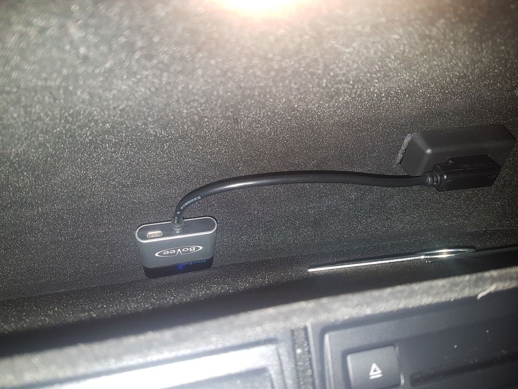

My a6 has loads of extras, but the fact it only does Bluetooth calling and not streaming did my head in, my car has the built in hard drive but it didn't have an ami port, so I bought a cable from B5nut on here as he's scrapping his a6 so I could retrofit ami, this exact cable

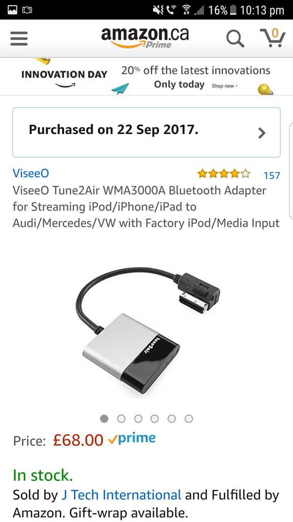

And I also bought this
After getting the hidden green menu activated I was able to change my settings in there to activate it, it was a glovebox out job, 5 bolts and 1 on the side under the cover where the fuses are, and you could then plug the cable into the relevant places, had to push out a bit of plastic in the glove box for the lead so the bluetooth tune2air could sit in the glovebox, and voila I now have working streaming via Spotify on my Samsung s7 edge, pretty neat job too

So is it plug and play?
The cable is pretty much plug and play, once you have the glovebox off it plugs into 2 places, then you need to activate the hidden green menu in vcds, once that is activated you can go into green menu by pressing setup and car together for 5 seconds, and activate ami so when you press media it shows the ami, you can then connect an ami lead for an iPhone/iPod, or do as I did and plug in a viseoo tune2air so you can stream music from your phone, if you have iTunes it displays the track information on the screen, if you're using an Android device like me it doesn't display the track, but you can change volume or track via the controls on the steering wheel, if you don't have ami on your 3G car, all you need is access to vcds, and one of these leads from ebay

The cheapest I can see on ebay now is around £300 for the ami unit, and it will be a further £60ish for the viseoo tune2air if you shop around, I have seen the ami units pop up on the classifieds here for around the £150 mark, maybe put up a wanted ad?

You just need a viseoo tune2air, plug that straight into your ami port and you'll be able to stream music from your phone to the car via Bluetooth, merry Christmas
