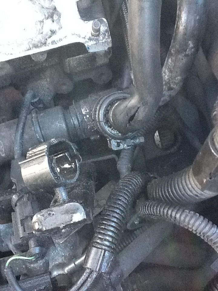

When you do swap them over I would suggest having a look under the inlet mani. I found this today. PVC hose was leaking boost for god knows how long. Cars feels much better now sorted.

Thanks mate, ye I will give a close inspection, changed a couple of hoses last month, after tip I think il get it smoked and on a dyno, get her running as healthy as I can then up to badger 5!

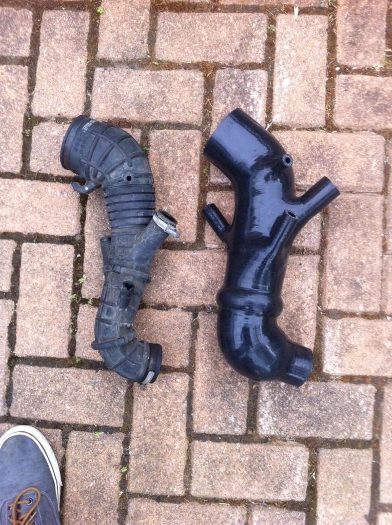

I did this then put on the tight fitting heat shield - I have to say I have had an intermittent boost issue (like several others - maybe the cold issue since).

It's quite a tight fit - needed two people to separate it, Maybe with the heat shield it might vibrate off. Not sure the heat shield is needed to be honest. You can see it didn't quite line up so well, but I will be able to hang the oil catch can off it.
