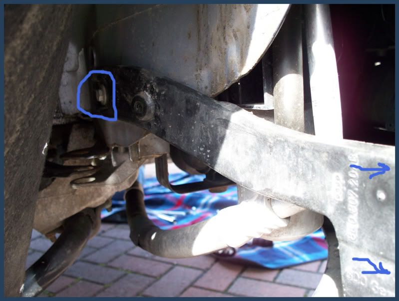

STEP 3 – REMOVE UNDERTRAY AND LOOSEN WHEEL ARCH LINERS
Remove the torx fixing screws from the front of the liner to the top. Only half of the liner needs to be movable.
Pull the liner out of the small lip on the arch and fold it back so that it can be held behind the brake disc.
This then allows access to this black plastic bracket that couples the side of the bumper cover to the main body.
10mm spanner for the hex nut and torx screwdriver for the two screws that are arrowed. These screws are just out of shot! Sorry.
Remove the undertray - NOTE: This may not actually be necessary (SEE WHY IN STEP 4)

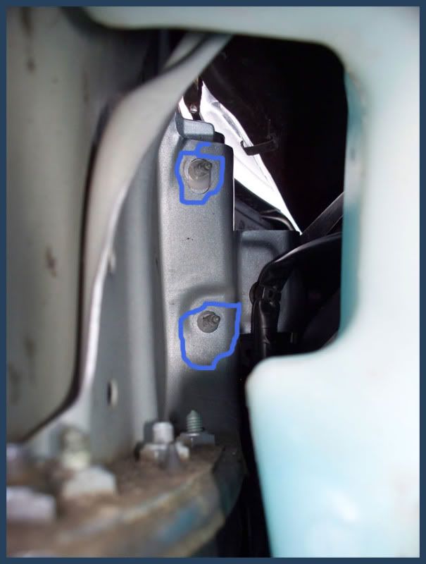

STEP 4 – SLIGHTLY LOOSEN FRONT END FIXING SCREWS
Area of interest here is the circled spot. About 15cm under here, there is a torx screw that only requires something like a quarter or half-turn. If you are using a socket and torx bit bit and extension to get in here then you will probably loose the socket and torx bit on the way back out. That’s where removing the undertray comes in handy. If you have long-neck torx screwdrivers then you shouldn’t have to remove the undertray! That’s not a bad option really!
The pic below shows where these part-turned torx screws fix onto the bumper cover.
You can also remove the torx screws that secure the top of the grille to the front end.
