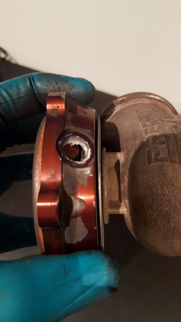

Had some boost issues. Wastegate pressure went from 13psi on the old setup to 23psi on the new setup. After a night drive out to the mountains the wastegate pressure settled on 17psi. After a week the steep slippery road to big turbo arrived.......
The second blanking nipple decided it no longer wanted to be friends with the wastegate, it left and took the threads with it, resulting in uncontrollable boost :(
I decided the wastegate need to be re-engineered and got the damaged port welded up. Also changed out the wastegate springs to a lower setup while the wastegate was out and apart.
Its all back together now and wastegate pressure is 15psi.
