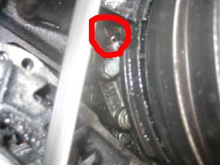

ive had a look round today and it looks like this is where the oils coming from anyone got a clue?

was looking at mine today i cant see that hole because front is on the car but that seems to be exactly where mine is leaking from as well

well when i had a good look around the area i sin this hole and thought what the hell belongs there or maybe its not ment to be that far out of where it goes to be honest i havent a clue what it is and hope someone on here can shed some light on it for me

thats where the bolt with the hole is on the other pics theres oil all over alternator the top of my sump all the pully casing and its coming from the area with the dot which as i say is where the earlyer pics i took closeup of that wiered hole any help on wtf this is is greatly apprceiated
