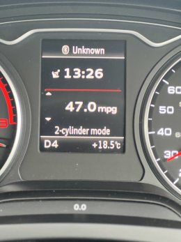

It’s the Turbo Actuator Linkage rattling caused by the cylinder deactivation.
It’s a horrid sound especially when cruising on back roads with cars parked either side, the sound bouncing back and forth - it’s embarrassing as people always notice it and turn around.
I’ve had my car a few months and notice it more now I’ve had a new exhaust system fitted, I haven’t got around to getting it looked yet or possibly disabling the 2-cylinder mode all together through getting my remap altered - anyone know if this is possible?
My sister picked up a Q2 last week with the exact same 1.4 CoD engine and she’s noticed the sound too, she wants to return the car!

For me, it activates 2-cylinder mode when I press the throttle very gently whist maintaining a speed of 20-30ish mph... the sound will remain unless I press the throttle down further or take my foot completely off, then the sound will instantly stop and the '2-cylinder' message on the dash goes.
