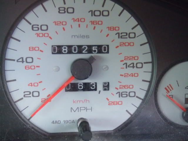

Just bought a 100 S4, It's a 92 80k with 1 owner fsh. Just wondering what these are worth and what can be done to gain some more power. What can be achieved with this engine? I understand it's a 2.3 turbo. No idea i'm a VW man :p

Uploading on behalf of Guy!
