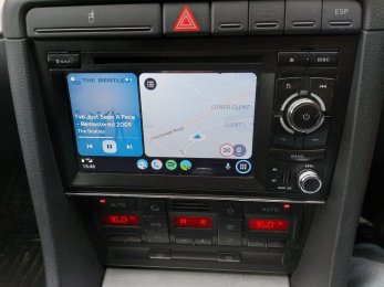

I've had an Xtrons OEM 'lookalike' retro styled unit for about 5 years now in my Audi A4 B7 S-Line Avant. I personally like the buttons and the 7" screen is still plenty big enough for me - bigger than the original Sat Navs for these cars and bigger than in a B8. It was plug and play from day 1 with no hum/interference on my non-Bose half amplified system. It's sounds every bit as good as the Symphony 6 CD system it replaced (except the radio and they're always rubbish because there's no good solution for the diversity 2-way antena, originally fitted). It's 4GB ram and 32GB rom, and it still fast and smooth handling apps. BT/Wifi and GPS have all worked perfectly. Steering wheel controls (similar to the picture above) all worked with the Canbus box that came with it, except push pause. But I have for a few years used the Headunit Reloaded app for, first wired Android Auto and then wireless. Changes Google made to AA recently, have made wifi a bit flaky, so I bought a Motorola MA1 dongle with 5GHz wifi and that works perfectly for wireless AA again. I had to use an App called MTCDTools to get my mic button work for Google Assistant and phone calls with AA, and disable the car HU's Bluetooth app to stop the phone overlay coming up. It works great and I mostly use voice commands from the steering wheel for nav, calls, spotify etc.
I didn't have to disable the Audi Bluetooth either - just unpaired it from the phone - it's still alive and I see it sometimes but it never interferes. I have the original cradle in the armrest, with the proximity antena booster, which still works too for a better data signal to the shark fin + plus it's a good charging point for when the phone is running low on juice with wireless AA. I replaced the original mic, in the courtesy light console with a good quality aftermarket one to the HU, and calls/ voice commands are strong and clear too.
These Chinese Android HUs come in for a lot of flack and some of them are now not much cheaper than the main branded ones but mine has been brilliant and was about 250 quid all in at the time. The various accessories, like dongles, Dab+, TMPS, rear view cameras are rubbish though and better to try and get higher quality ones working with them. My dvr cam has been great but I have had 2 Dab+ dongles die and the stick on antenna was rubbish and I'm about to fit my third Xtrons number plate parking sensor/rear view cam unit. This time I've sealed it all over where I could, I still don't think it will last long though.

So interesting about the radio... Never thought of it from the 2way antenna... I must the Xtrons is not bad on FM reception but not perfect. Everything else works perfectly and I have gotten used to the full touch screen
What launcher app are you using or is that Andriod auto? Excuse the ignorance... I have an Apple phone but Car Play wirelessly kills my battery and has a number of limitation / flaws... So trying to find a nice Launcher App.

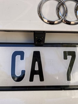

Re the Xtrons camera... What issue did you have that you add to seal it? I have installed a "mounted" version, so hoping it may not have the same problem
Yes the radio is useable, but the original diversity antena amp received modulation data from the OEM HU, hence 2 Fakras (The yellow one being the data). Most aftermarket antena booster adaptors, incorrectly join both Fakras to the single input of the Android HU, which is pointless, since only one is giving a signal. So although you get reception, the full quality rejection of unwanted FM interference is not being achieved. There's no real solution for this other than for the HU unit to supply this modulation signal; some more expensive units used to but since this antena system is very old now, it's unlikely there is any market for such a feature, any longer. There is a way to improve it greatly, by looping at the antena amp itself, but I've never tried it and I rarely care about FM (or Dab) radio these days, to bother.
On the HU itself, I use Agama Launcher, very good. I have all the apps working too, including Sygic nav, installed. But yes that is wireless Android Auto on the screen and I use that now for almost all things; Voice command and phone calls are easier to control from the steering wheel mic button with it and that makes a huge difference. You can even play and answer texts/Whatsapp with voice commands too. It's a faff to get them working without, on the HU itself.
I don't use that camera, I use this one: https://xtrons.co.uk/universal-reversing-camera-cam008 . It has parking sensors plus the camera built in. When it works it's great but the camera has failed twice, I think because it is not waterproofed properly and my valeter spray jet, I suspect the cause fo death. The new one I've installed, I've added silicon sealant too - we'll see.
