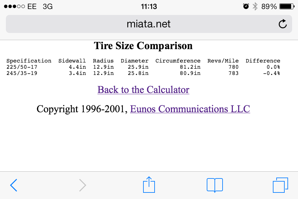

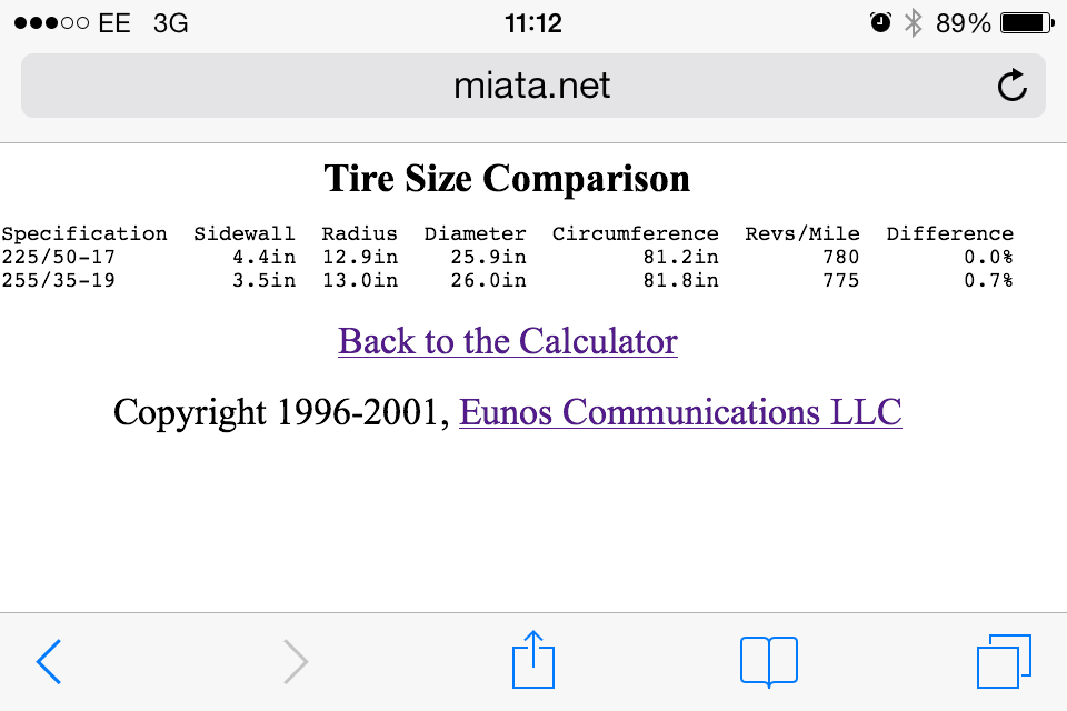

Thanks for your reply, u seem to know your stuff.
I have used a tyre calculator to show the differences and to me it seems a 245 tyre would be better when compared to my stock tyre

It seems like it would work. You've certainly done your research. Just look into the whole insurance thing. If anything unfortunate should happen (touch wood), it would be better if you got compensated. But I'm sure you don't need to be told that.
Best of luck.
