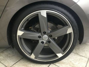

hiya mate, looking to get rid of my 18" genuine rotor alloys, satin black and polished ?? will need tyres but cheap enough to pick up now

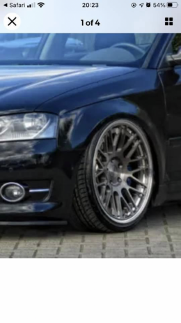

Anybody got any photos of their car with the TT 10 spoke speedline wheels? I caught a glimpse of an S3 with these on and I actually rather liked the way they looked. Almost reminded me of the 8L wheels! Photo pulled from the internet for reference.
How much does these go for if refurbished/prestine condition as im looking to get rid of mine on my s3 and have a buyer lined up who wants them

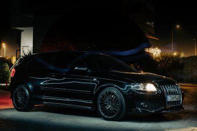

This is my S3 8p 08' prefacelift.
I'm the owner since 2018 and I think it was time to refresh the stock wheels .
Got the JR37s for a bargain and they look really nice in this colour .
Next step is to lower the car a bit and look even better .
19' would be much more elegant but I live in very bad roads so I had to stick with 18''
