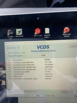

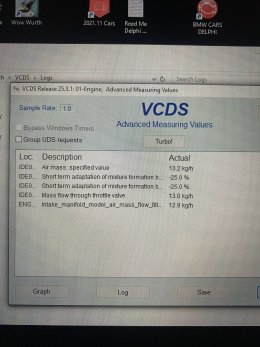

After some logging, ive got the below -
According to AI, it indicates maybe crankshaft sensor and N80 purge valve.
I am getting very poor fuel economy as well which would be indicated by the short term fuel banks at -25%
