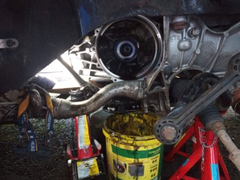

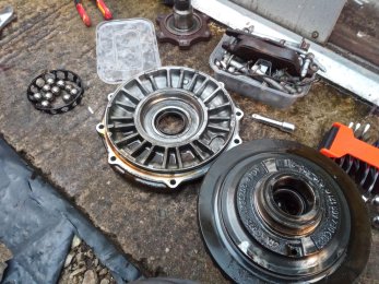

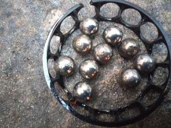

Is it not the front diff bearing, it went on mine but is sounded more of a grinding noise, it was the right front driveshaft on mine though and I was able to grab the driveshaft and move it slightly up/down/side to side because of the worn bearing.
I did manage to change it in situ without removing the gearbox.
The new bearing was available from TPS for about £30
