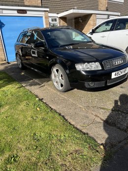

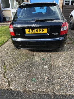

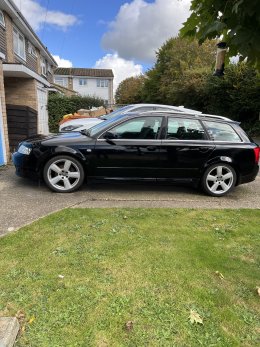

I’ve looked into pricing, you can get a condenser for £60 ish a receiver/drier for £20 , if I get them fitted and find the pump is knackered then I’m looking at another £350. might take a gamble and hope the pump is good.

Well from looking at those photos and your plan to keep the car I'd be inclined to spend the money & get it done. (I do love the B6 Avant!)
Looks very smart that!.. no rusty boot lid.. no condensation in the rear lights lol.. no rusty arches!. like new that :)
(what are the front upper arm rubbers like? thats the one that scares me the most with these cars!.. seems like a pig of a job & expensive just for the parts.)
